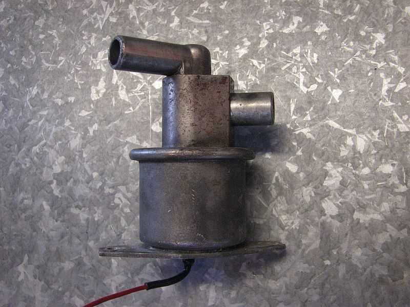

Its amazing how much energy is spent on a part that is still available...no need to reinvent anything.
Here is one source... (IMG:style_emoticons/default/biggrin.gif)
http://bowlsby.net/914/PartsFS/
Just get the right part and do it right...
