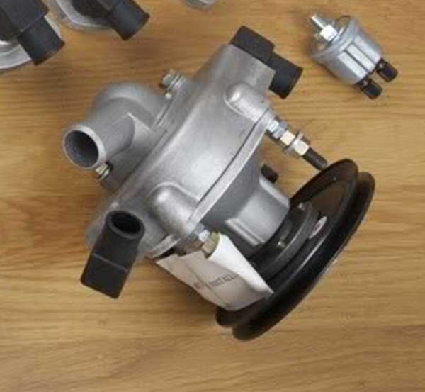

I stick with the belt-driven for a couple of reasons.
The first is, whoever makes it, really didn't design anything. The working part is a Mopar big block cover and impeller assembly. That is a part that has been engineered and should last a long time. The rear is pretty much a housing that directs the coolant.
I am not really sure what the advantage of the electric pump is. Its not cost, or really weight, just seems like one more thing that could go wrong.
40,000 miles on my v8 conversion and no cooling issues, no pump problems, so I am sticking with it. I am sure it will go some time, but so far so good. Mine is from Desert Hybrids.

Mark, do you have any more info on that pump you're using? It looks just like what I have in mind, but they are not too common an item.

QUOTE(Cheapsnake @ Nov 23 2009, 09:23 AM) *
That pump is from Desert Hybrids. Rod Simpson and Renegade use a cast housing.
They all use Mopar big block impeller assemblys to move the water. The back is basically a housing. You could probably make one yourself with if you can weld well (I can't)
So, they are all basically the same pump. None of those companies "designed" the pump itself, its a Chrysler design.
As for reliability, they are just as reliable as any water pump because that is exactly what they are. A mass-produced OEM designed part. I would try to get a new over rebuilt though.
