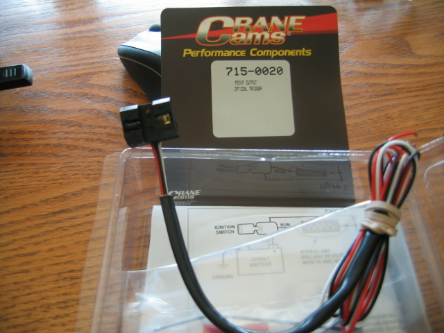

post Dec 8 2009, 12:00 AM
Posts: 225
Joined: 31-March 03
From: Danville.ca
Member No.: 499
Not trying to sell the Crane by any means, just setting the record straight.
I have the Crane set to work with just what you see in my first post with no
external box. Simple 3 wire hookup , 2 for the points and 1 for switched power.
Sorry for any misunderstandings
cheers

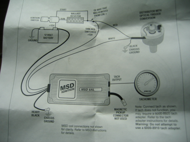

Not trying to stir the pot.. but Elmonte what converts the signal on your crane from an optical? I thought that ALL optical sensors went from the sender in the distributor to a crane box and then to the coil
brant
elmonte
post Dec 8 2009, 03:17 PM
Posts: 225
Joined: 31-March 03
From: Danville.ca
Member No.: 499
Here are the instructions for the installation of the crane optical with the
Msd-6 box. It is the same with the stock CDI box
The link to pelican part # PEL-sw715-0020
http://www.pelicanparts.com/catalog/shopca...t_pg1.htm#item0
Hope this explains everything
Cheers
