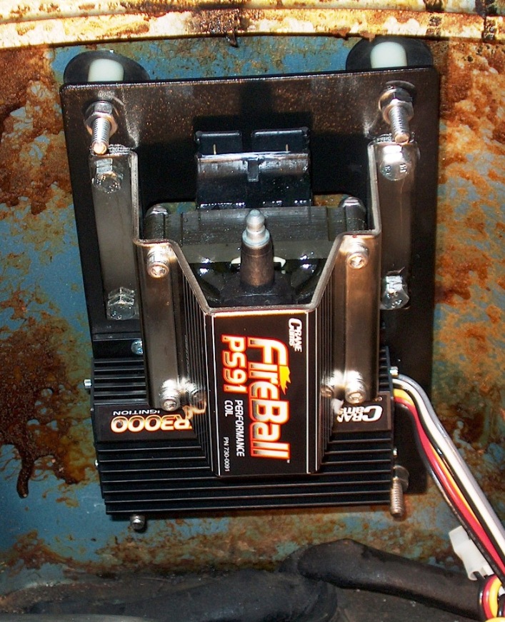

I made a plate, then painted it. The optical unit and the new coil mount to the plate, then it is mounted to the firewall with nylon standoffs and rubber isolation washers. Here's a picture (that's not rust, it's the glue from the engine bay pad).

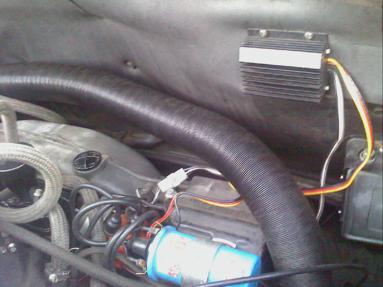

This is my finished set up with the crane "700", for stock 74 2.0. I do not know what your trying to do and have never seen before what you have pictured above so my stock application probably does not concern you but I thought I would throw in for anyone else maybe just wanting to use crane but for a stock application. I mounted the little black box on the fire wall but it could have been hidden w/ a little thought.. simple set up... It has been working perfectly for a couple years w/ a stock distributor and stock bosch blue coil.. 4 cylinder no mods..

So your getting a hotter spark with that set up? after you drive on it awhile maybe you could post the real world improvements. I had hot spark stuff for awhile Nology ect.. I sold that crap and never noticed a difference at all, nothing start horse power smother runing ect, in fact after thourogh reading it seemed to cause hard to immeadiatley identify issues in some cases.. but that is not your set up so I am curious to what you notice after your done..

I've had the setup in post #2 for about a year now. I really like it, in that it gives me a clean power range, with no points to adjust. I haven't touched it since it was installed.
I have the 205 disty off of a 1.7L installed on my 2.0L due to the wider curve, and Weber 40's. I'd recommend the system to most anyone.

True but I am gettng all those benifets that without the ps60 and just the xr700 and stock coil (pictured above).. but maybe there is more to it than just stablity, accuracy, and maintenance.
