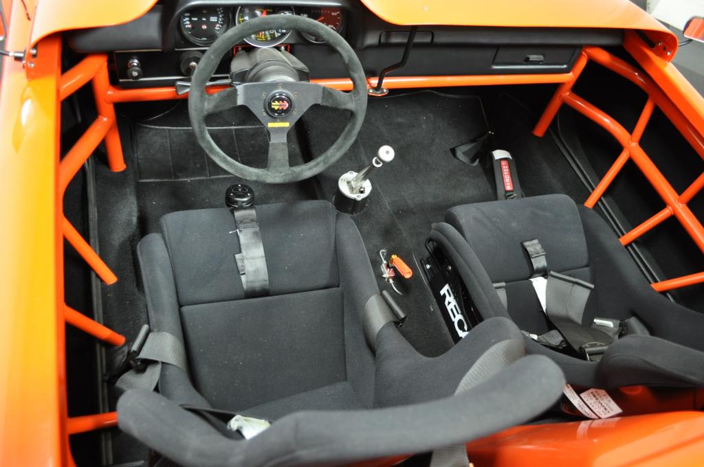

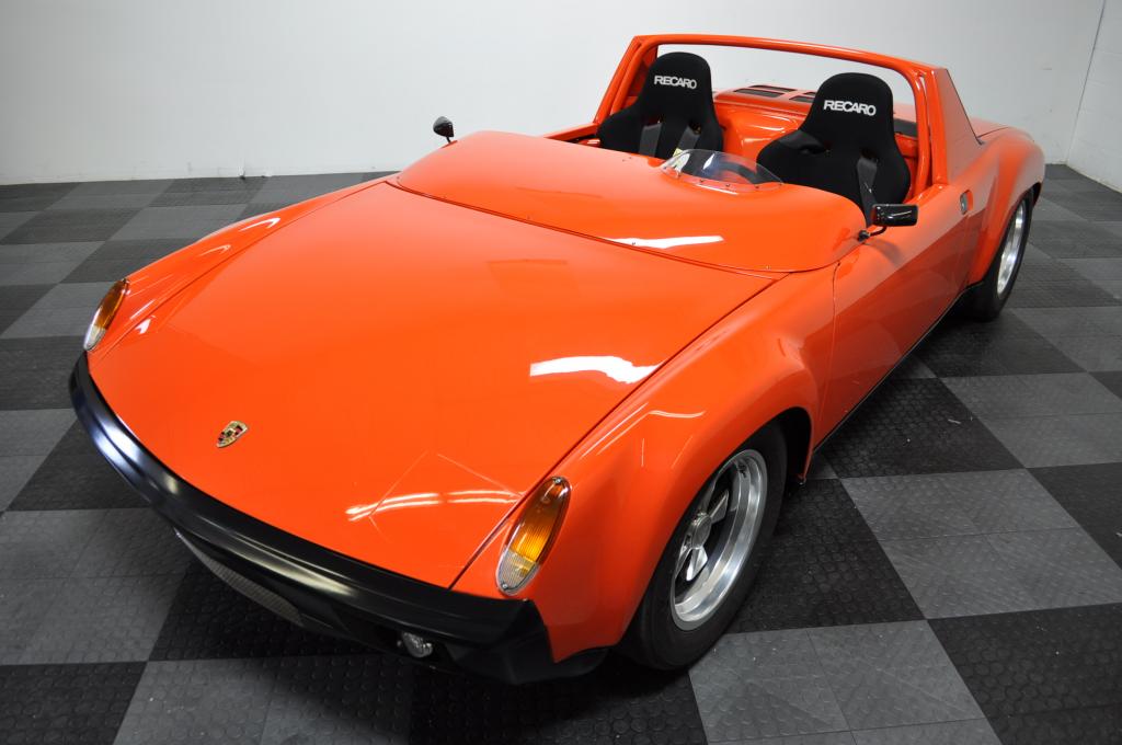

http://cgi.ebay.com/ebaymotors/Porsche-914...5fCarsQ5fTrucks
Check this link it may give some Ideas, Trunks too..

Stealthy Roll Bar under Basket Handle..
