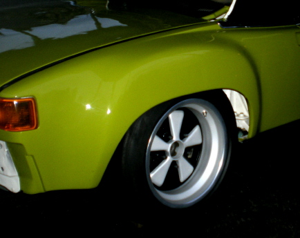

Those are 7's and 8's.
Tom, the 2.0 Fuchs and all Porsche alloys are anodized. The frosted section of the 2.0 is a similar process but, I'll let someone like Al weigh in on that in detail.
You didn't think I could wait did you?? Bluestreaks are mounted. Pictures tomorrow.

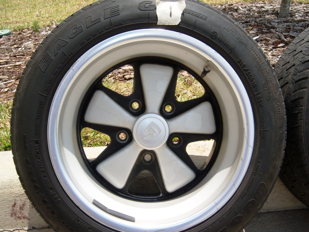

I'm looking to restore a set of 5 used Fuchs 2L to the factory finish as in CW original, as I like that finish.
Strip Paint/Primer, Repair Rash, & Refinish & Re-anodize these:
To look like this:
(IMG:style_emoticons/default/drooley.gif) (IMG:style_emoticons/default/wub.gif)

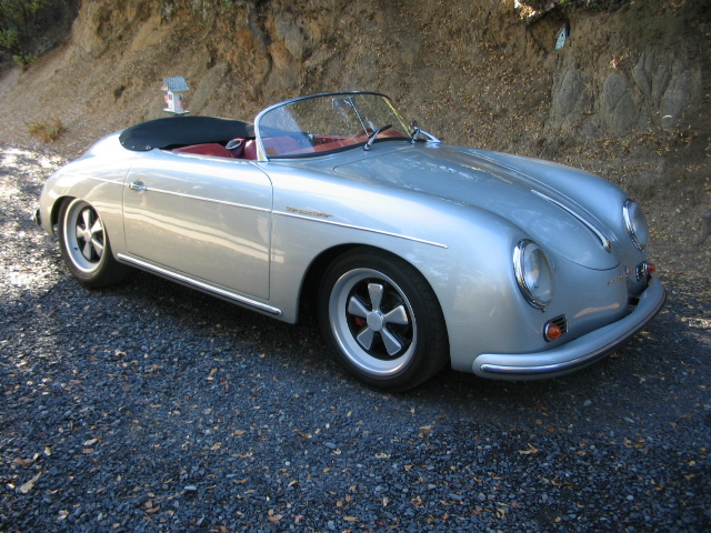

yup chrome ina can method works ,I have done it many times , But there is nothing like the real thing.
1realdeal
2cann
3harvey
al weidman

QUOTE(sixnotfour @ Mar 20 2010, 08:00 AM) *
1realdeal
2cann
3harvey
Something interesting in your real deal photo. Notice the splotching on the spokes? This is typical on factory wheels, after all it was only done to provide a little protection on bare aluminum. This is in the forging resulting from the process. Now, however, we find no one wants such a "imperfection" in their wheels. We sometimes have to refinish the spoke two or three times to get past the material compression. Al
We maintain a series of original factory wheels for comparison and as a guide to originality.
