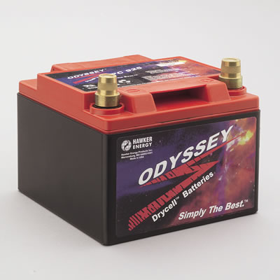

You can get the Odyssey battery with standard terminals, and it's smaller than the 34R, and easily fits on the stock battery tray. You will need a custom mount. If I get home at a reasonable time, I will take a picture of mine in the stock location. (No mount at the moment, as this one will go into the trunk with a custom mount.)
Link to battery at Summit racing: http://www.summitracing.com/parts/ODY-PC925MJT/?rtype=10

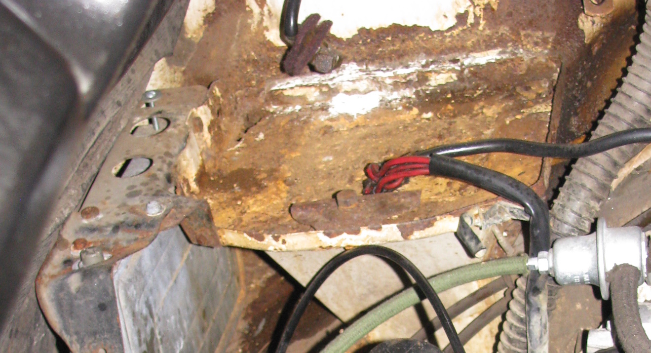

WARNING - WARNING, WILL ROBINSON!!!! (IMG:style_emoticons/default/very_first_smiley[1].gif) (sorry, couldn't find the robot) .......
I used to use Delco's back in the 70's & early 80's before Interstate & sealed lead acids were around, always kept a pad under it & treated felt rings on the posts - then it was garaged on blocks in "sunny" SoCal since May 85 with a clean & a then rust free battery tray & the last Interstate sealed lead acid battery/etc. removed - even washed everything off with baking soda & water to neutralize it & dried it off as per storage reccos! (IMG:style_emoticons/default/dry.gif)
So - flash forward - & I check back in April 09 ~ 25+/- years later & here's the result from residual old acid fumes, etc.!!!!! (IMG:style_emoticons/default/sad.gif)
(IMG:style_emoticons/default/hissyfit.gif)
