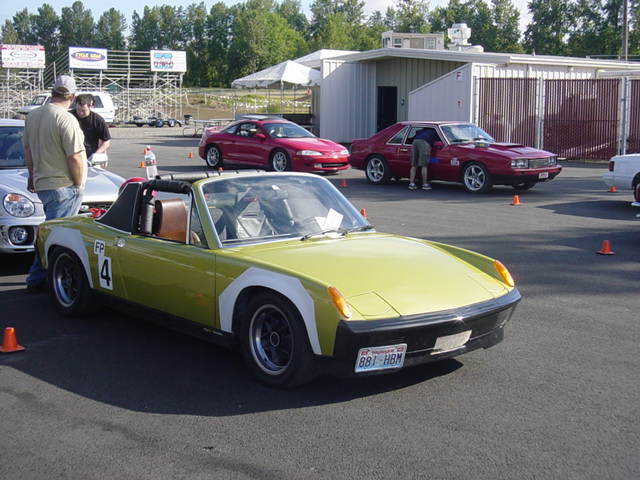

J P Stein
post Mar 26 2010, 05:57 PM
Irrelevant old fart
Posts: 8,797
From: Vancouver, WA
Member No.: 45
An old pic.....7 X 15 F&R with 205s F & 225s R. When I went to cookies & 225s both ends some mods to the front fenders were in order.

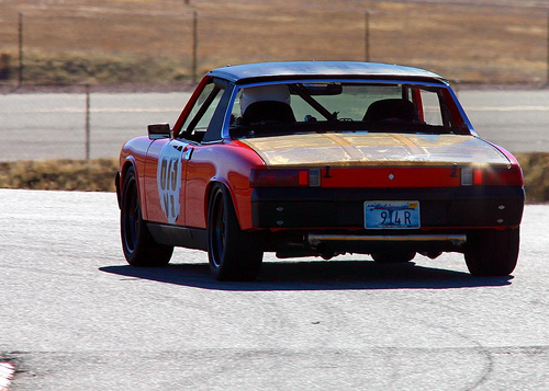

campbellcj
post Mar 26 2010, 10:37 PM
I can't Re Member
Posts: 4,704
Joined: 26-December 02
From: Agoura, CA
Member No.: 21
Another old pic. 15x7 cookies with Kumho 205's of some sort.
(IMG:http://www.914world.com/bbs2/uploads_offsite/farm1.static.flickr.com-21-1269664661.1.jpg)
Currently I am using 16x7 Fuchs with Hoosier R6 205/45. My rear fenders are stock metal but pulled and rolled fairly aggressively.
New pic.
(IMG:http://www.914world.com/bbs2/uploads_offsite/farm3.static.flickr.com-21-1269664662.2.jpg)

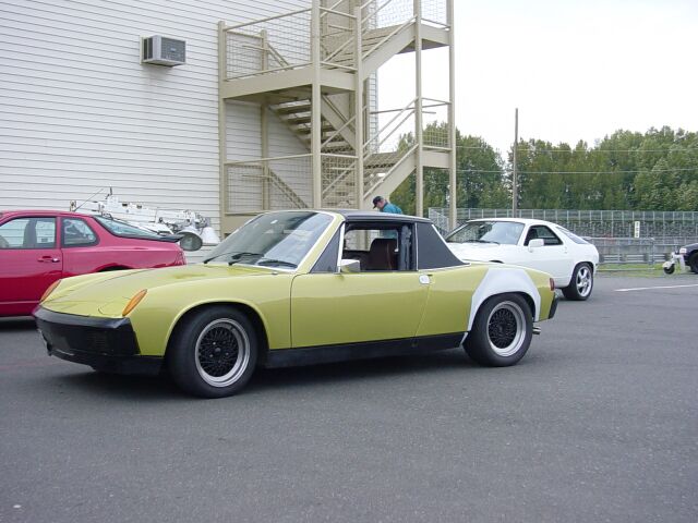

J P Stein
post Mar 27 2010, 09:24 PM
Irrelevant old fart
Posts: 8,797
From: Vancouver, WA
Member No.: 45
The cookies are a good wheel....only a pound heavier than Fuch of the same size and a hell of a lot cheaper. Not as pretty, tho.
Cookies with 225s:
