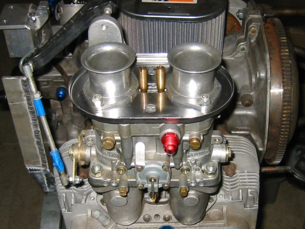

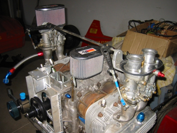

I have a set of 40 Dells for sale, with manifolds and crossbar linkage.
Haven't had time to post, or figure out my asking price yet, but I took a coupla pics.

They were on a 1.7L FProd engine, but need some work to go onto a competetive engine.
