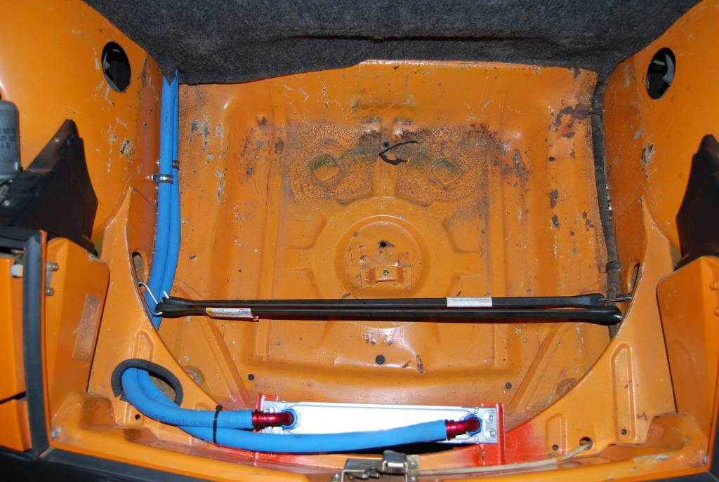

QUOTE(dlee6204 @ Apr 12 2010, 07:57 PM) *
How do you expect to add heat with headers and the oil cooler lines running through the long?
Headers will come off. (maybe i'll make a few bucks to finance other inevitable repairs...?)
oil cooler lines I can unbolt @ the engine -- they just hook up via a sandwich plate at the oil filter. I can pull them right into the front trunk, they're not secured to anything.

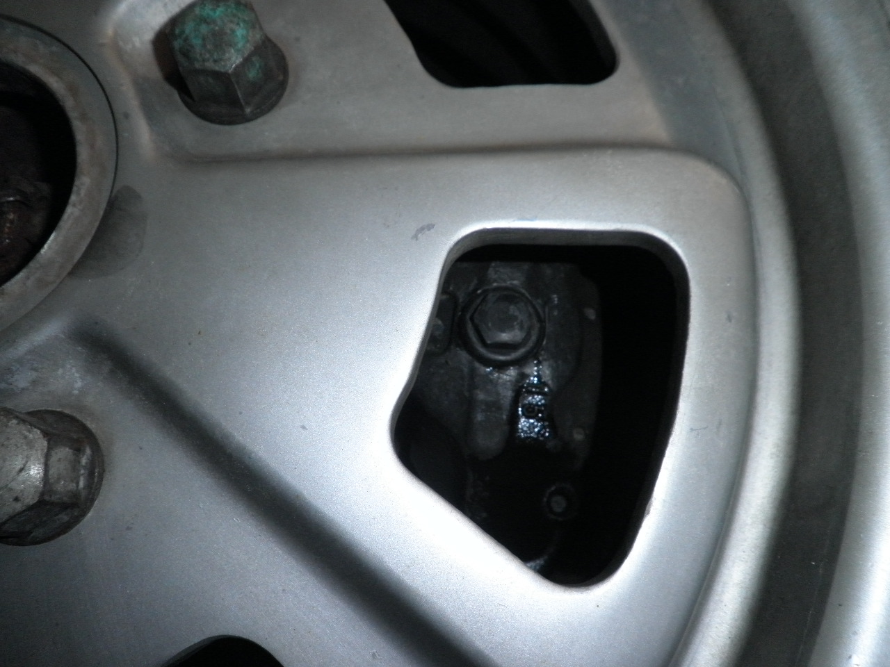

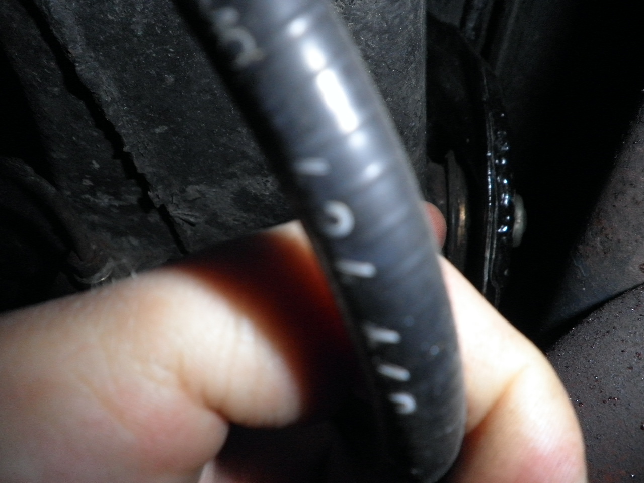

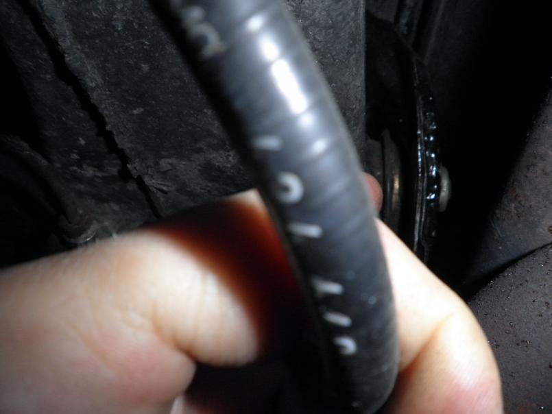

This looks like leaking brake fluid but seller says he didn't clean up after bleeding brakes the morning of the inspection...looks reasonable

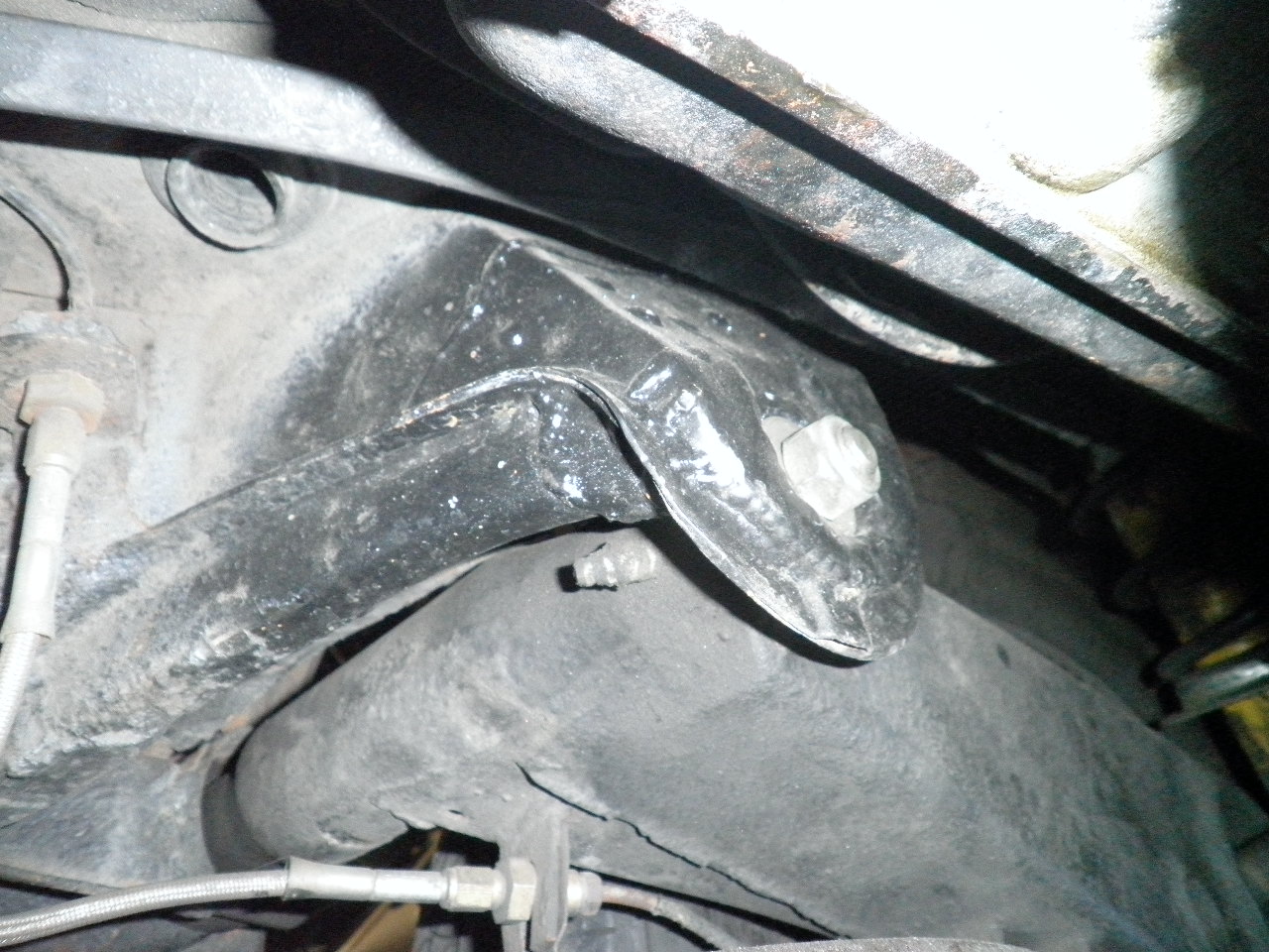

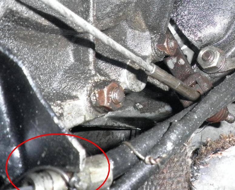

QUOTE(rwilner @ Apr 12 2010, 04:58 PM) *
Yes -- suspension ears (both) were welded by Racer Chris, probably the most solid part of the car.
As for the clutch cable, I'm not familiar with what it *should* look like...but I do know I don't like being stranded!!
I'm sure the suspension ears are good to go then. See the pic.... There should be a clip holding the cable to the stop. No big deal, but I would fix it. Half ass repairs usually travel in groups or armies on 914's.
post Apr 12 2010, 06:02 PM
Post #25
Resident German
Posts: 42,469
Joined: 21-January 03
From: Oakland, Kalifornia
Member No.: 179
It's moved out of the way because of the headers. It's still VERY close to the headers so heat is an issue ...
If you had stock heat exchangers on that car, the clutch cable would be a straight shot forward. Currently, it's bend upwards with bail-wire to clear the headers ...

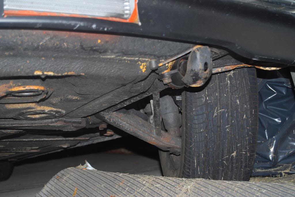

QUOTE(SirAndy @ Apr 12 2010, 07:54 PM) *
The hell hole is rusted,
I can't tell that from these pics, where are you lookin?
your fuel pump mount has turned to dust,
yep, but I think that's the worst of it...
the pass. side suspension mount has been welded,
YEah, both sides repaired by racer chris, so not concerned about that.
the motor leaks oil, the tranny leaks oil,
Are you sure that's tranny oil on the tranny and not motor oil? Is this amount of oil leak "normal"?

Member No.: 8,829
QUOTE(rwilner @ Apr 12 2010, 05:01 PM) *
cept the bleeders on the other side of the caliper ..shouldnt be wet there (IMG:style_emoticons/default/confused24.gif)

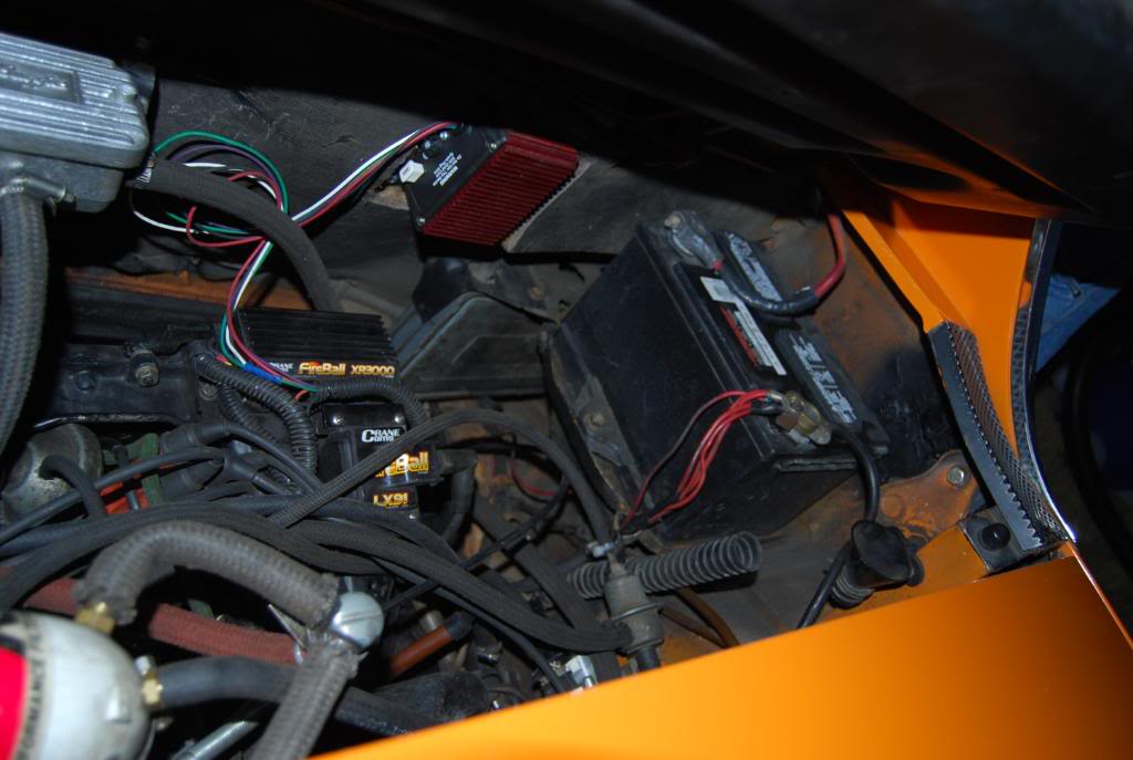

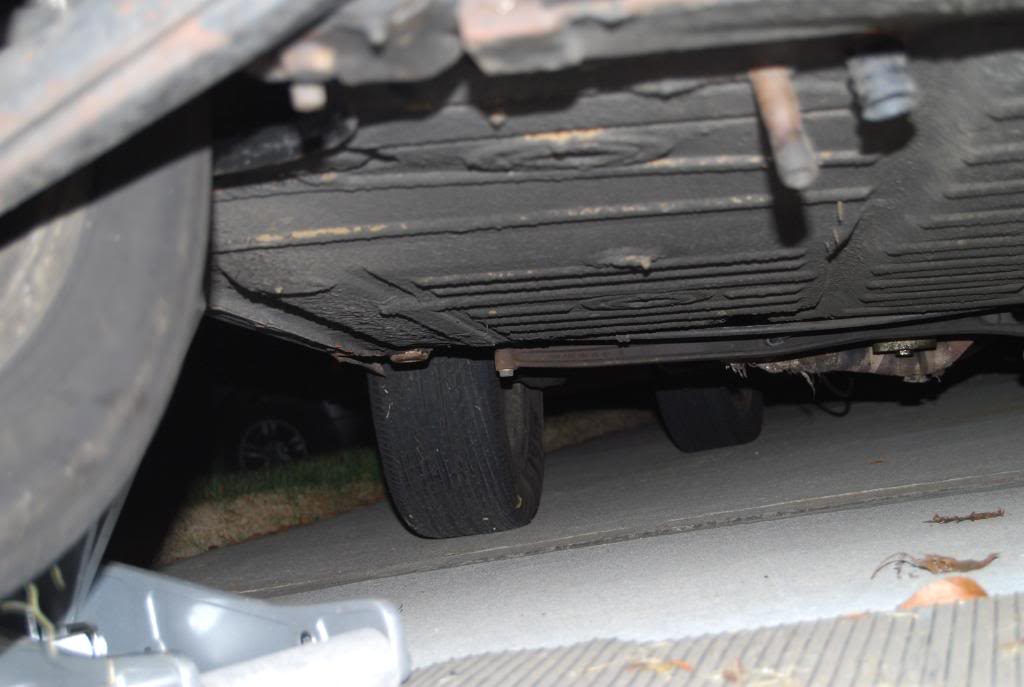

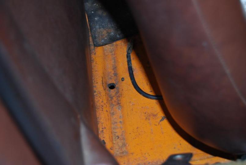

rwilner
post Apr 13 2010, 08:20 AM
Post #35
No Ghosts in the Machine
Posts: 953
Joined: 30-March 10
From: Boston, MA
Member No.: 11,530
a few more pics

QUOTE(esses62 @ Apr 12 2010, 10:28 PM) *
Tony's car. It's a buyers market. I believe it's been for sale for about 2 years. I'd say $5k it's a little tired. Do a search I think the car had some major ear repair in the past. Check the Vin# in Andy's excellent database (IMG:style_emoticons/default/smilie_pokal.gif)
No need to search for pics of the ear repairs. I have them in my customer car database. Both sides were carefully repaired, then reinforced. I don't have pictures of any other parts of the car though.
The clutch cable is re-routed to clear the header. If you switch back to HE's its no big deal but a new cable is probably a good idea. You can save the old one as an emergency spare. I bet the fuel lines are still oem.
The condition of the engine shelf is an indication that a hell hole repair will be necessary down the road.
The rear caliper has an o-ring seal on the inside, behind the adjuster screw under the black cap. It clearly weeps a little.
They often do that and it will require a rebuild at some point.
Eric Shea has nice rebuilt ones for a simple swap job. We rebuild them as needed in house but we don't re-plate them.

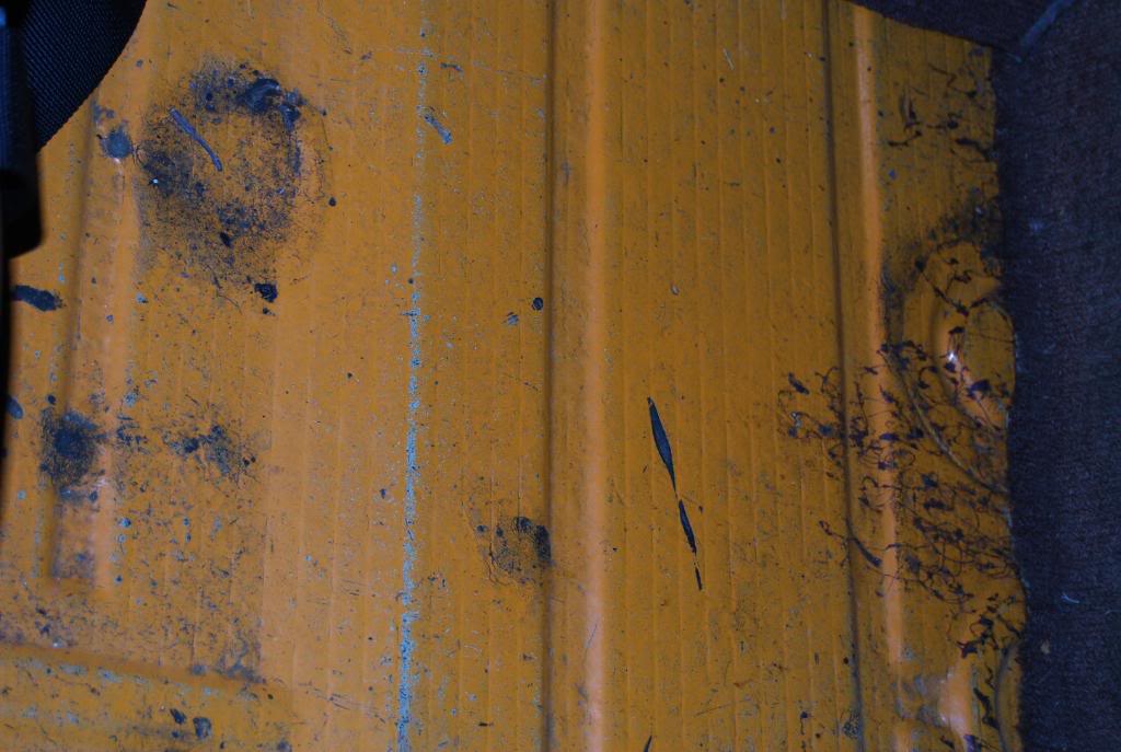

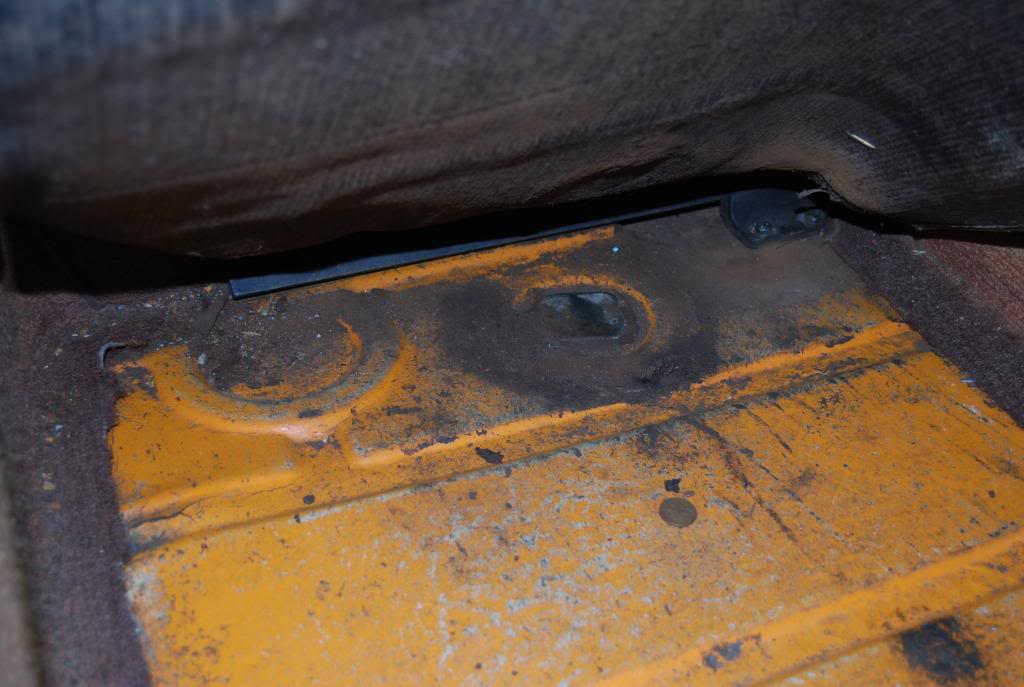

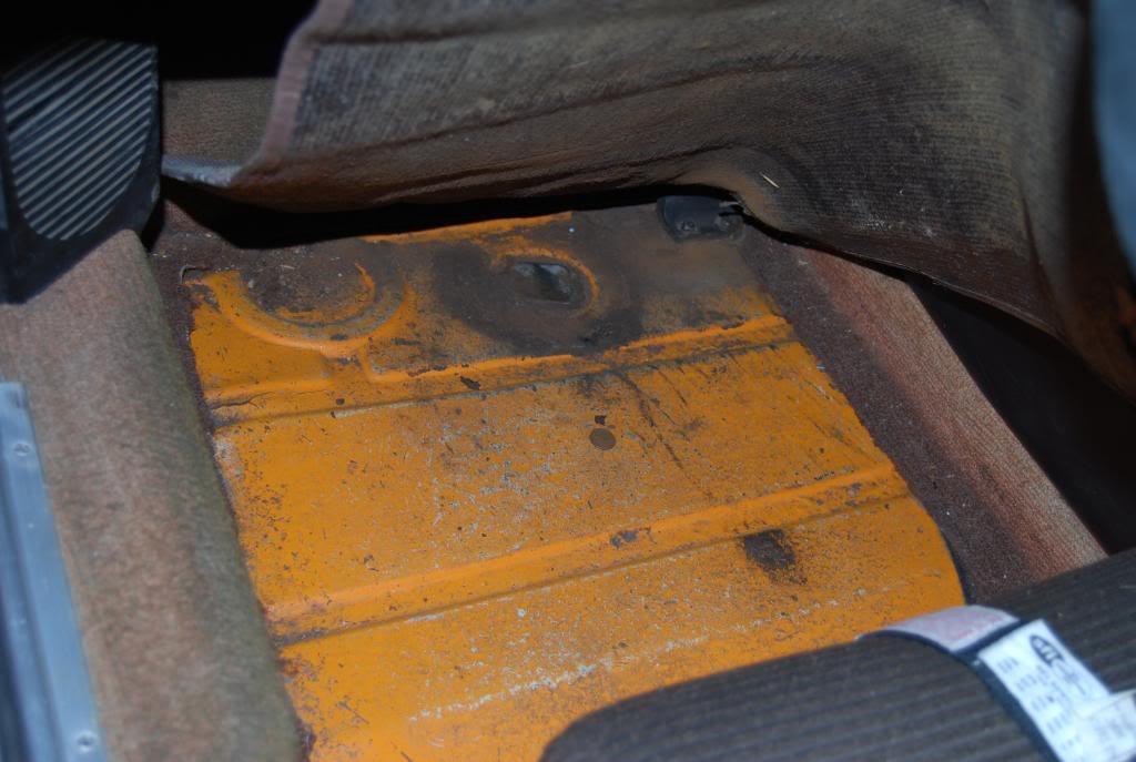

Pictures of the floor inside the car don't tell a thing about the condition of the metal except that it has never been repaired. What you see is factory paint over tar sound deadening panels.

I agree with Chris about the floor and tar boards over the metal , no real way of evaluating the floors without removing the tarboards, maynot appear to be rusted , until you remove some of that sound deadening material . Overall from the pics it appears to be a fairly good car , but as mentioned the battery / engine shelf area needs some attention. Like I mentioned , check under the rocker panels , if not rusted , then the shelf area may be the worst , if the area around the jackpoint is rusted , then you can figure that the hell hole areais bad also rust runs down hill so to say. I would say if the rocker areas are ok , then go for it , all the other issues can be remidied with time ( elbow grease ) some money ( new HE gaskets , bolts , nuts of the proper size and type , parts missing ) and lots of TLC , which most all of these cars enjoy. Dude you really seem to have your mind made up , just seem to want some reasurance on some points of the car , if you are not familiar with 914s . see if you can get someone that does know them to check it out for youmaybe add that to the price of purchasing it , you know your budget better than anybody else , also know that you will probably have to pay more after the purchase to get it to where you need it , much less what you want from it . Good luck ......
