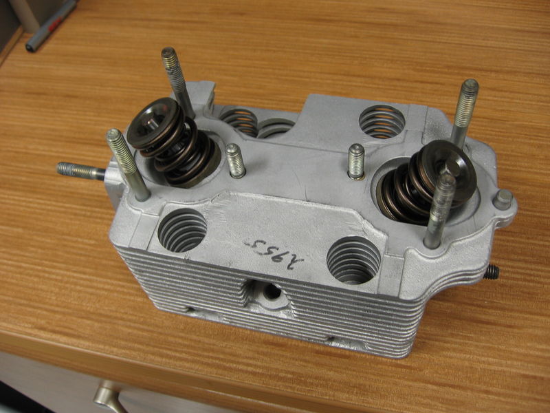

Heads are out getting reworked with Aasco springs/Ti tetainers(man these are nice)and valve job and surfacing.

If your heads are out getting a rework ask them to drill and tap Head #3 for a Carrera type CHT sensor. This can interface directly to your EFI and will function as a warm-up sensor. The response is much faster for fueling requirements than measuring oil temp. You can also epoxy mount a thermistor in place for the same function.

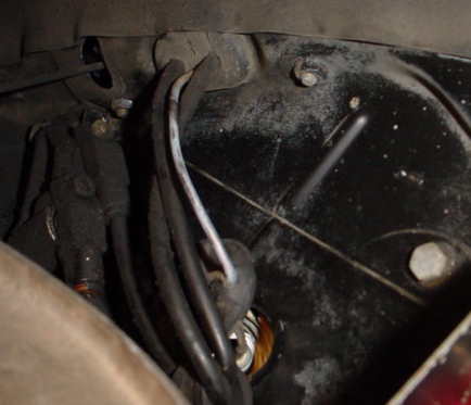

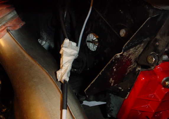

Do you have a picture of where it goes in the head? I looked for some and cant find it. Complete engine would be better so can see where it needs to go? Thanks again.

Any place that knows Porsche heads should be able to do this mod. In any case, the CHT sensor mounts on the forward face of the #3 head pretty much right in the center.
http://forums.pelicanparts.com/porsche-911...eplacement.html
(IMG:http://www.914world.com/bbs2/uploads_offsite/www.pelicanparts.com-10736-1276708985.1.jpg)

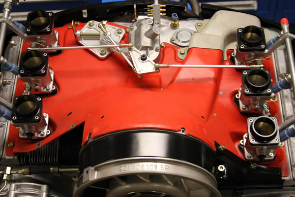

Have you taken a look at the EFI systems from Rothsport Racing?
They also sell individual components.
-Britain
