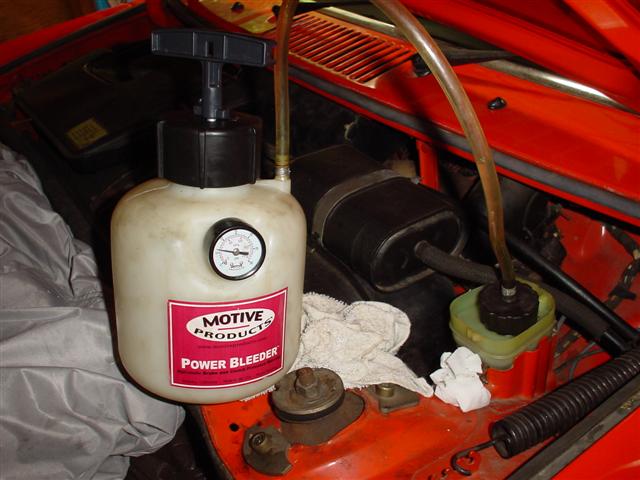

(IMG:style_emoticons/default/agree.gif) to bleed all 4 corners. Old brake fluid will absorb water and rust out the brake system from the inside. Factory (well, maybe VW Passat) maintenance says flush system every 2 yrs. I have a blog entry showing the Motive hooked up to my car.
Edit: ... or easier if I just paste the pic here
