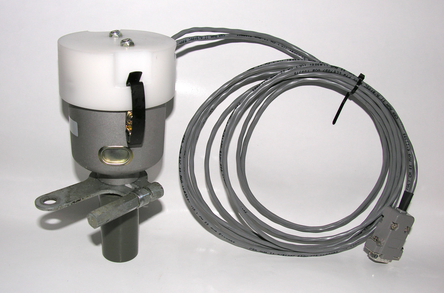

We took a new 009 distributor and designed a pickup for it. Works perfectly but very expensive as we had to machine parts to make this functional and reliable. the best thing though is that it uses the original distributor hole so there is no need to machine anything nor drop the engine
Mcmarks is a very economical solution.

here is a picture:Attached Image

we had all kinds of problems modifying both the flywheel and the fan to install the pickups and NONE were reliable. Plus there was an empty distributor hole AND the fact that to install the megasquirt pickup, the home enthusiast would have to drop the engine, or at least the transmission! What a hassle as compared to just installing a set of carbs. That is why I had my brother in law Galen, an ex GA Tech physics nut case and Porsche perfectionist, design and machine this assembly for us. As you can see by the cover it is very custom and just the one off parts a few at a time take a bunch of precise hours to make.
BUT the result is a direct drop in part that works perfectly and plugs right in, plugging the hole while using it for a modern trigger
