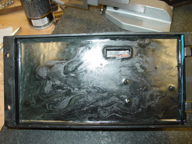

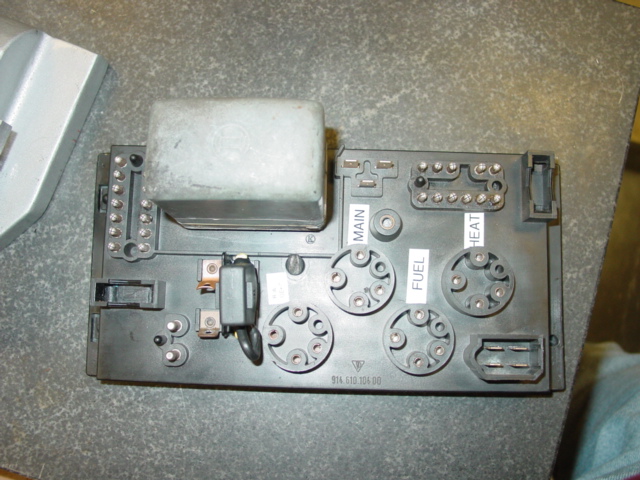

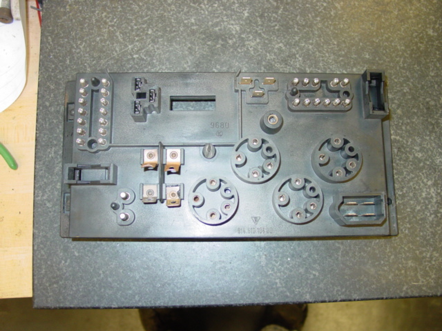

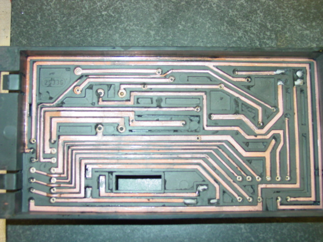

I have a relay board that was giving me grief. Several times the car would not start. Cleaning the fuse seemed to help but once in a great while the problem returned. The problem was the fuse holder. As these connections get dirty, they heat up. The problem in my case was aggravated by the use of the heater fan. This draws more current and made the problem of the fuse heating worse. I have some before and after pictures. You can see how the fuse holder is leaning back. If you look closer, you can see melted plastic where it is mounted. My solution was to install a new fuse holder. I recently installed an Engman fuse panel so now all my fuses will be the newer style. No more VW fuses! Te resin I used was Vagabond Model-cast 3521S black. This stuff flows like water and dries pretty fast. It is hard when cured and looks real nice. The biggest problem is the resin flowing through the board and leaking. I knew this would happen and I taped where I thought it would leak out. I missed the voltage regulator socket. It looked fine from the rear but it leaked real bad. I had quite a time sealing this up. If you do this, try epoxy first to seal where the pins come through.

..Came out decent... (IMG:style_emoticons/default/shades.gif)
what did you use on the corrosion?

I gave it a very quick glass bead shot. Front and back.

Good news and bad news here. I still have that board. I came out great looking and worked awhile but the old issue came back. I replaced it and I never went back to see exactly where the issue is. I suspect there is a bad connection with the buss bars and probably a relay socket pin. I have heard that these should be soldered first and then the epoxy installed. Now that this has been done, it is too late for mine. I consider the board to be not repairable at this time.
The epoxy was from Smooth-on. If someone does this there is a problem with the epoxy running through where relay connections are located. Make extra sure these holes are plugged somehow.

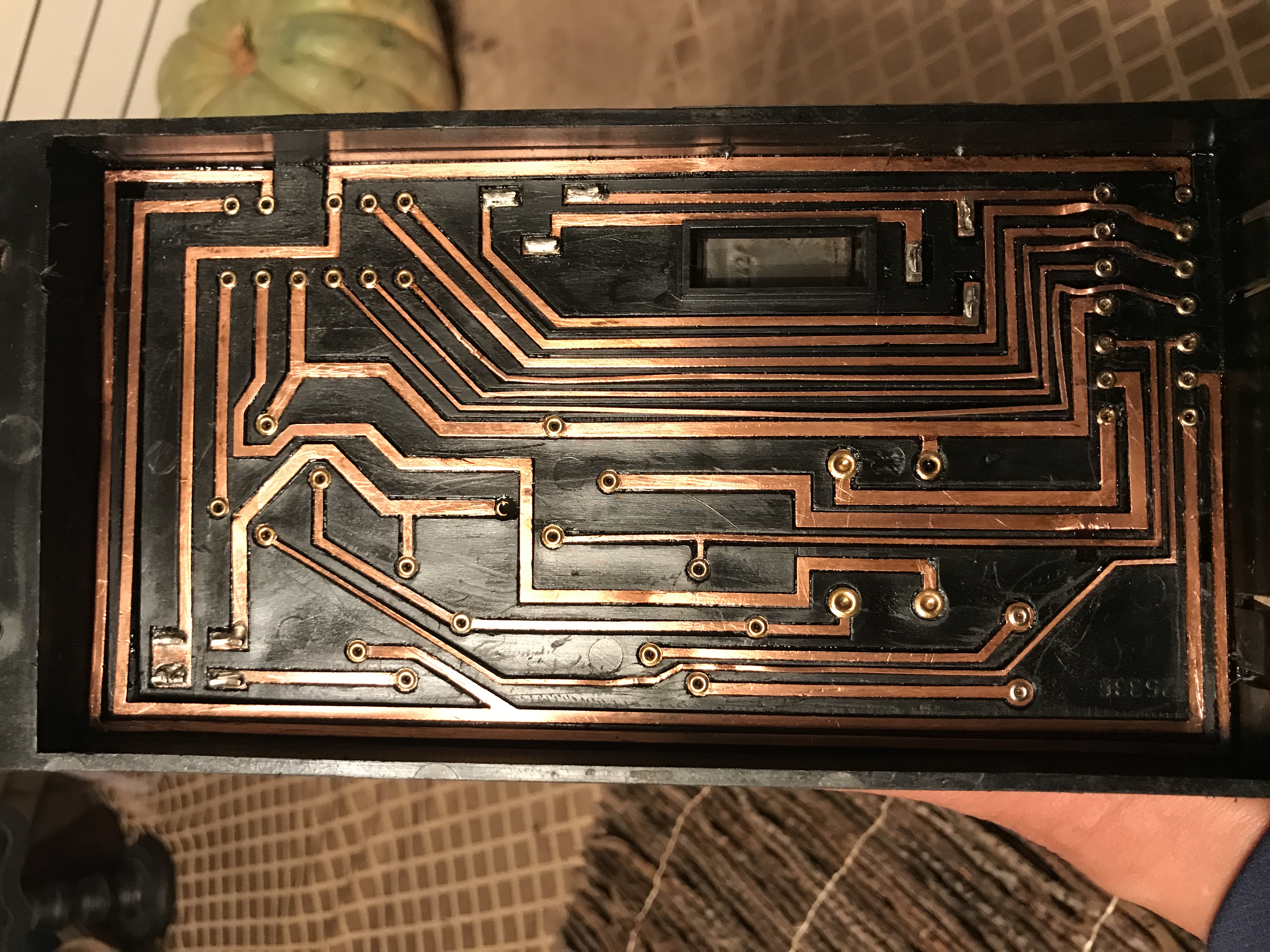

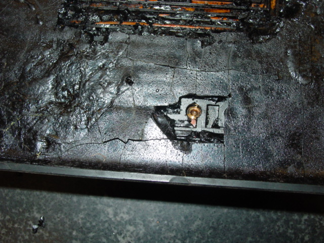

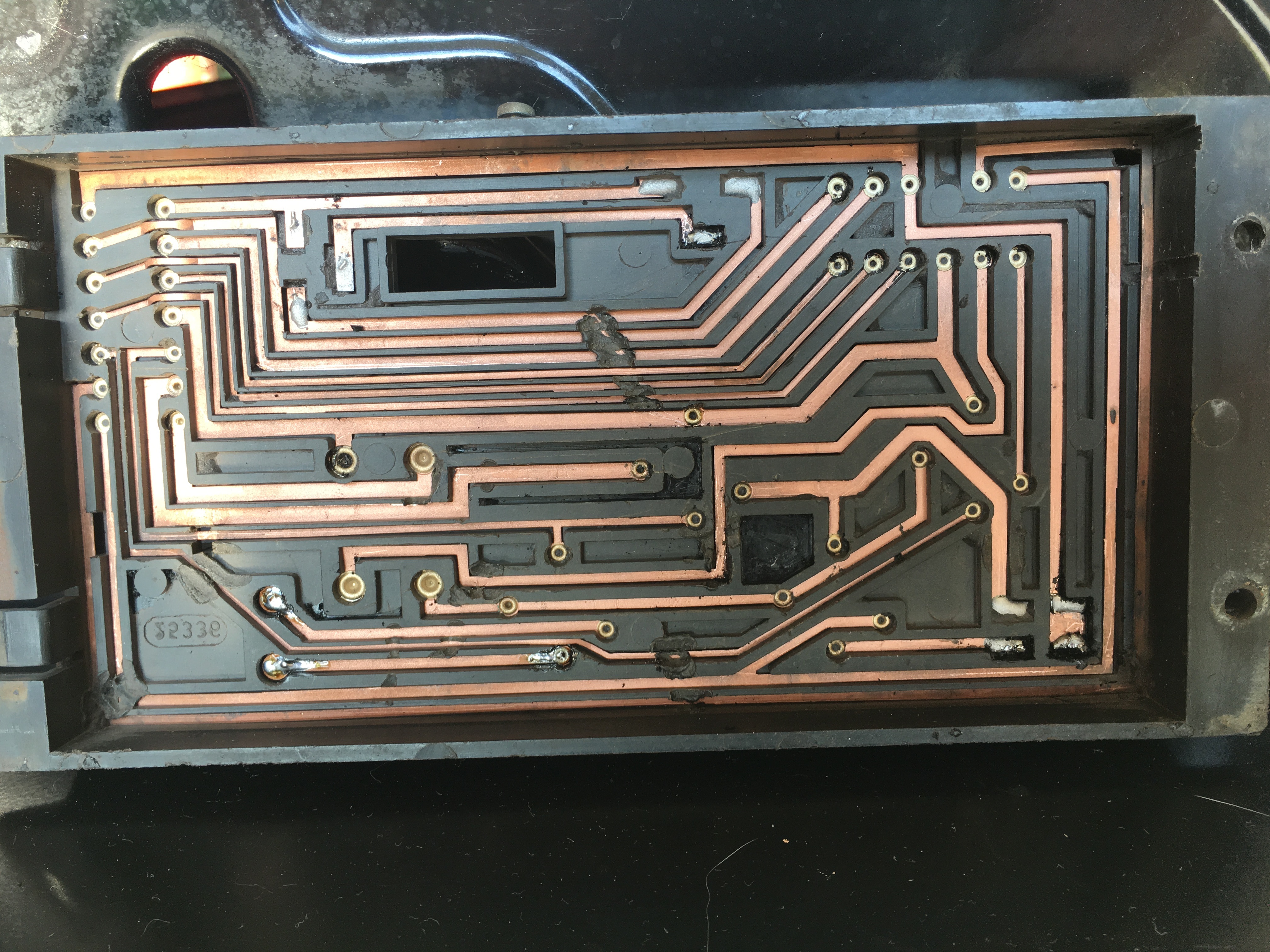

I did mine recently and just chipped the old tar out carefully with a screw driver and dental picks. I used a brass brush and CRC Contact Cleaner and Protectant to clean the traces and connection, then MG Chemicals Black Epoxy Encapsulating and Potting Compound to repot. My board worked fine when the car was retired so I just visually inspected all the traces and connection to pins, but if I suspected anything, I would have tested the resistance between traces and pins and terminals. I also use dielectric grease on all terminal contacts to protect from future corrosion.
(IMG:http://www.914world.com/bbs2/uploads/post-20845-1522247648_thumb.jpg)

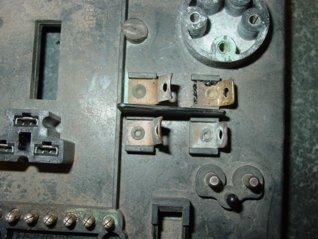

I soaked mine in regular gas in a solvent resistant tray to get the compound soft.
soldered all the riveted connectiions. Mine also failed at the Aux heating fan trace.
Great idea! Wish I'd done that. (IMG:style_emoticons/default/dry.gif)

I thought about soldering but wasn't sure I had a way to get the connections hot enough to flow solder. A couple of my connections that were exposed had some green oxide forming on them. I removed all of old tar and then cleaned with spray electrical contact cleaner. I coated the bottom this stuff:
http://www.starbrite.com/item/liquid-electrical-tape
It worked well and remains flexible. I think I got the idea from someone here.

I started stripping mine out last night. Looks straight forward.
Of course now that I have 90% of the potting removed, I'm learning that I probably needn't have bothered, and my board was fine as is.
