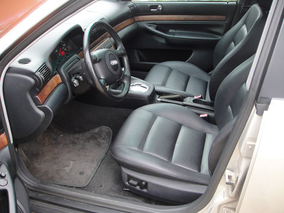

This is interesting timing..
I brought home a 1999 A4 for my wife to try out as a winter car last Thursday. It isn't a turbo, it is a 6 cylinder auto. This car has a ton of miles on it.. like around 220,000 It runs great and seems rock solid.
I have always heard that this era A4's had Electrical Gremlins and this one seems to be right on in that department. The windows stopped working the day after I gave it to her. Looking at A4 forums, I see that they ask if the windows stopped working during a heavy rain.. Yup.. Supposed to be a relay on the drivers floor that gets wet if the sunroof drains crack. Haven't checked that yet. The alarm and central locking don't work and dash warning lights are on and on and on. Some of these things I can live with considering it is real cheap and I only need it for the winter. She does really like it and if a few things can be fixed, I'll buy it for her. Oh, yeah.. Heated Seats went a LONG way in selling her on the car...

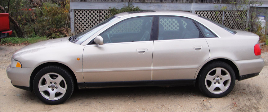

gandalf_025
post Nov 7 2010, 12:57 PM
Posts: 1,516
Joined: 25-June 09
From: North Shore, Massachusetts
Member No.: 10,509
As far as pictures being deceiving.
Here are a couple of pictures of the A4 I just brought home. By looking at the car there is no way you would guess it has over 220,000 miles. I'd be paying around 1300.00 for it and am willing to deal with some issues.. I'll buy 4 winter tires, Working Windows would be good and the check engine light out would be nice. The Alarm and locks, I can live without. As long as it gets an Inspection Sticker, I'm all set with it. and the Wife gets to leave her 911 home in really bad weather. If she REALLY likes it, next year I'll look for one with a lot less miles and send this one on it's way.

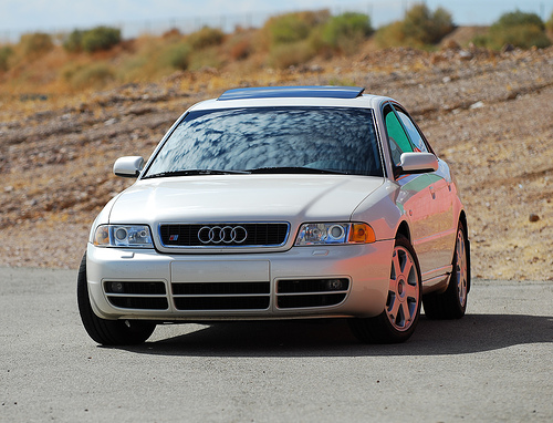

campbellcj
post Nov 7 2010, 08:14 PM
I can't Re Member
Posts: 4,705
Joined: 26-December 02
From: Agoura, CA
Member No.: 21
The front suspension does need attention when the bushings and tie-rod ends get worn - the car will feel like it doesn't want to go straight, and you can get weird tire wear (which hurts extra with >$200 tires).
Gratuitous pic of my S4 -
(IMG:http://www.914world.com/bbs2/uploads_offsite/farm1.static.flickr.com-21-1289182485.1.jpg)
2000 Audi S4 by cjcam, on Flickr
