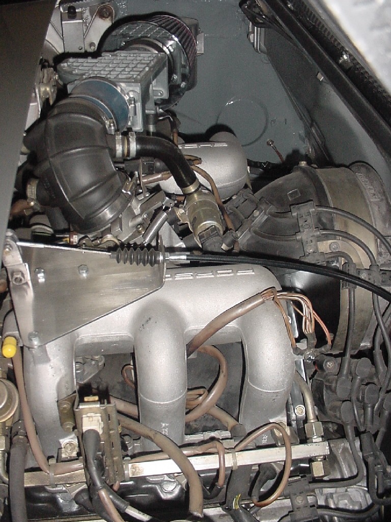

I made my own linkage for the 3.2's that I do. The original design was done over 20 years ago with no issues.
Stock 914-4 cable (and barrel nut).....
Attached ImageAttached Image

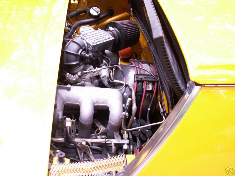

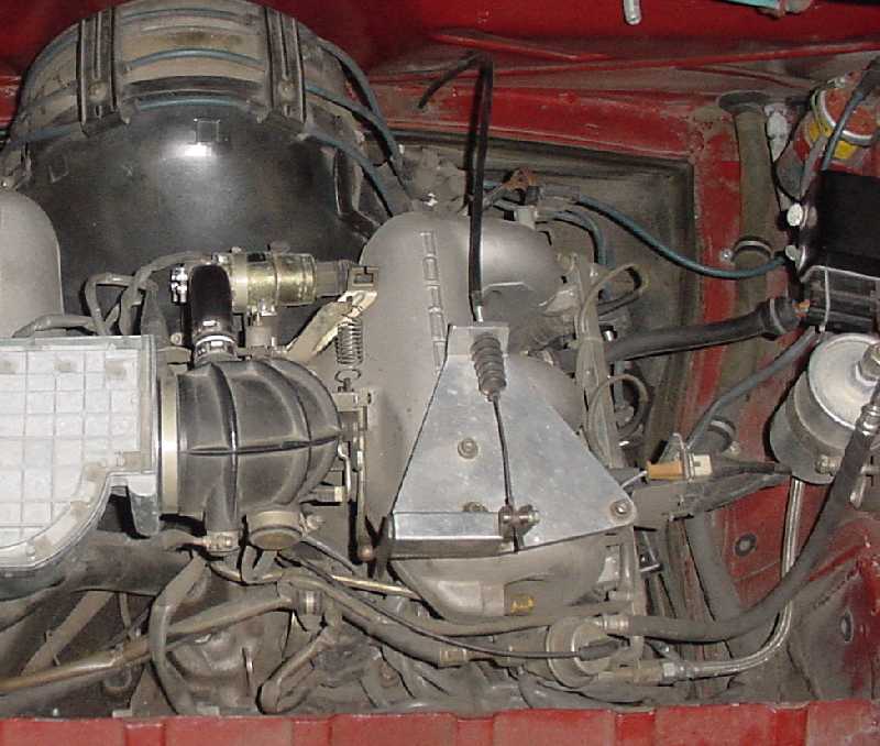

Here is how i did mine,
not a pic of my car, but the one I copied.
dflesburg
post Nov 17 2010, 09:01 AM
Posts: 1,722
Joined: 6-April 04
From: Warm and Cheerful Centerville Ohio
Member No.: 1,896
I did not have to make any parts. Just attached a barrel nut to the cable to catch the existing bracket.
