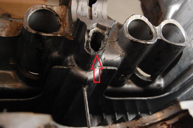

I recently tore apart my engine. I found that a part of the case was missing. Kind of hard to describe so I took a picture. It is on the passenger side below the main bearing that lies between cylinders 3/4. I did not find a hunk of metal in the oil, I think that the issue may have been there on the last rebuild.
Is this going to cause me any issues. Is there anything that I should do to fix it? I should mention that I am cheap and don't want to spend any money.

looks bad to me.
the area missing would give support to the main bearing boss. with out the area joining in the bearing web it will be a very weak and prone to distortion.

on looking closer.... thats at the lower cam boss. might not be such a big deal, but i'd locate another case and go from there.
if the p/o let that go by what else did they not bother with?

Is that the boss that holds the sump bolt in place...
The one that cracks off when over tightened?

QUOTE(r_towle @ Dec 14 2010, 10:21 PM) *
Rich
Why the question mark Rich?....That's exactly what go on.
Bet it was always leaking from the sump plate.
Case is pooched get another. The fix will cost more than the case.

QUOTE(Mark Henry @ Dec 14 2010, 10:45 PM) *
Rich
? was cause I could not tell with the pic so close...pull it back and it would make sense...just seemed like it may be, but hard for me to process that pic for some reason...
Jake said he fixed these frequently...but I would assume you need the piece...which is MIA.
I would get another case. the bearing seats dont look right either.
Rich
Absolutely. You'll be $$$$$$$$ ahead with a new case.

These cases are cheap and plentiful. Unless there's some compelling reason not to, throw that one on a bonfire and you'll save some money. It's cost more to do it twice.

That's what we refer to as the syndrome.... Happens all the time from medieval mechanics with the precision of a brick..
It can be repaired, cost about 250 bucks to do it right.
Good cases are hard to find, I now charge 1k for an inspected case if the customer's core is bad... We build from the customers supplied core primarily. Cores have become priceless.
Most people don't know what to look at when inspecting a case.
