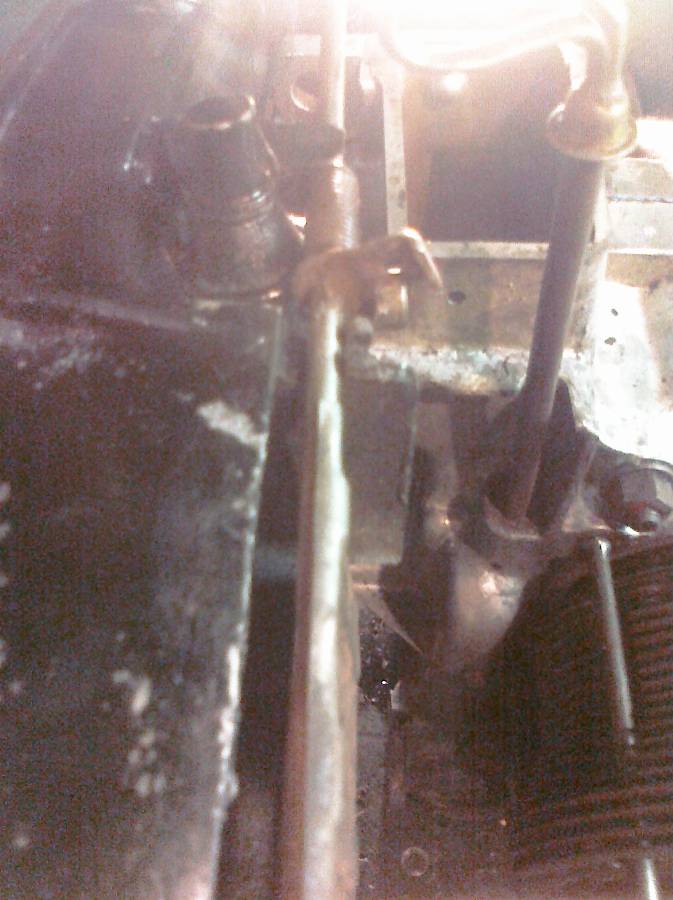

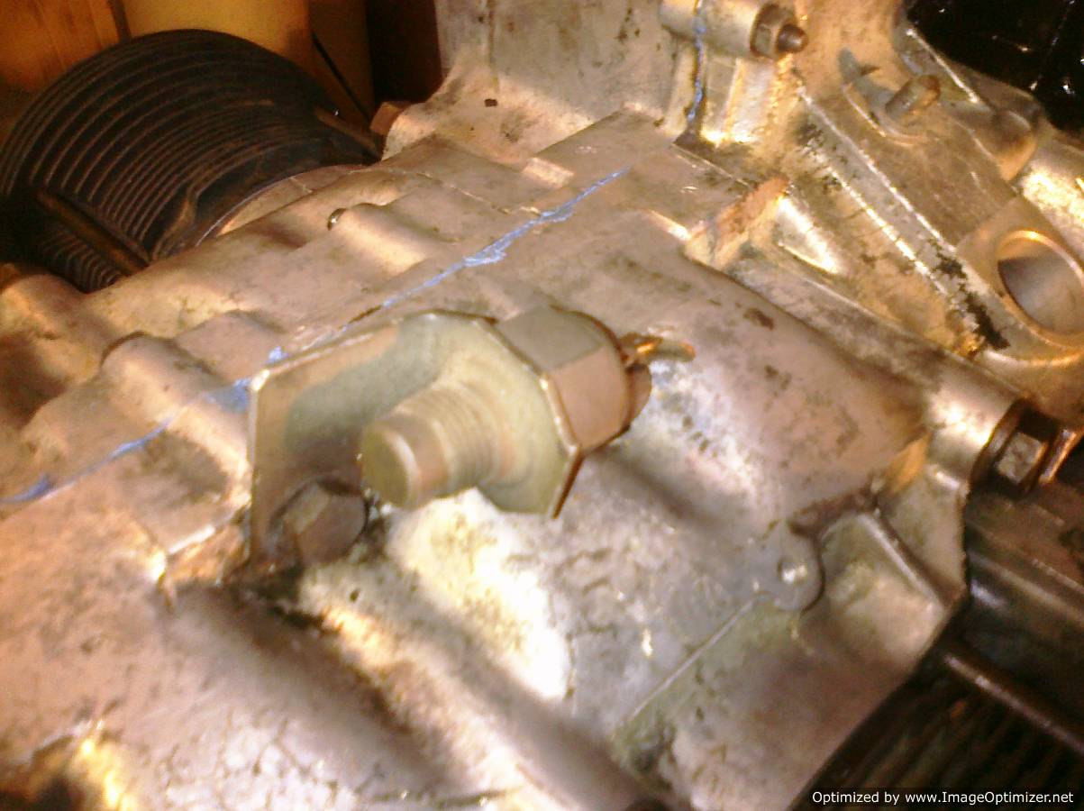

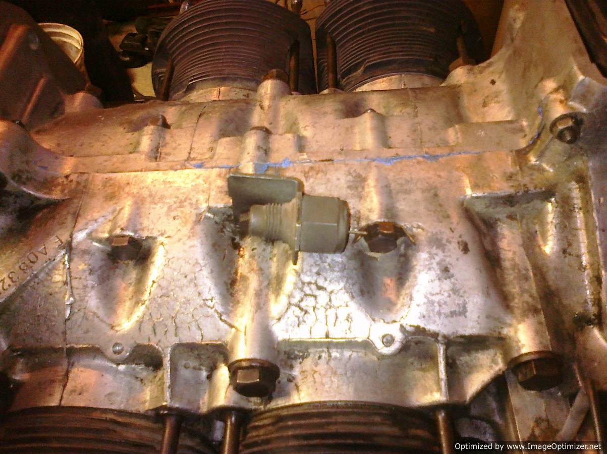

I am rebuilding my engine and am getting ready for the tin work. Here is a picture i have of a sensor and a piece I have no clue what it is. The engine was apart in a box when I got it.
Could someone tell me what they are/where they go.
Attached ImageAttached Image

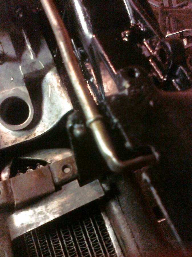

Also the flaps is confusing me. Does anyone have a picture of what is used to attach them and how the wire is attached?

Ambient Air temp sensor.
May be reffered to as temp sensor one or two....cant remember.
Look here for D-jet info
http://members.rennlist.com/pbanders/DjetParts.htm

Thank you. Do you know if its in the correct place?
and on the case bolt to the right there is a small connector of some sort. It has 3 tabs on it. Its not the best picture but any info on it?

"and on the case bolt to the right there is a small connector of some sort. It has 3 tabs on it. Its not the best picture but any info on it? "
thats a ground...if you get your wiring harness in place correctly, you will find the ground wires that practically fall right in place for that thingy (IMG:style_emoticons/default/beerchug.gif) g'luck

For the flap this is all I have. I am not sure how to mount it or attach the wire. Any help?Attached Image Attached Image
