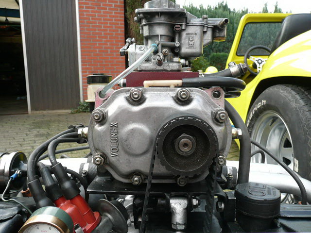

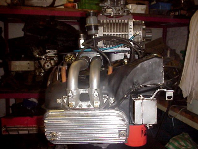

Volumex supercharger

Now I want a supercharger on my 914.. thanks guys..
@Type47, is your motor able to breath with that carb on it? Seems kinda small for a supercharged engine?
And how do you connect the belt to the impellor fan?

same way they did the AC. although it might need a beefier belt
914 had a pulley behind the impeller. belt exit went behind the fan housing to the right opposite teh alternator
or maybe could be like they did the smog pump. it was mounted atop the fdan housing. there was an extender shaft in front of teh fan. the fan housing had a 3 legged bracket suspended in front of teh fan mounted to the 3 holes that the Bus used for teh fan screeen
Jake has said that boosting teh type 4 creates head sealing challenges. perhaps modest boost #s would be OK
