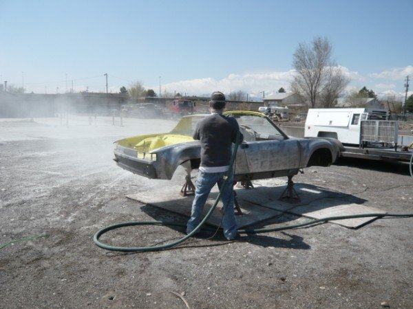

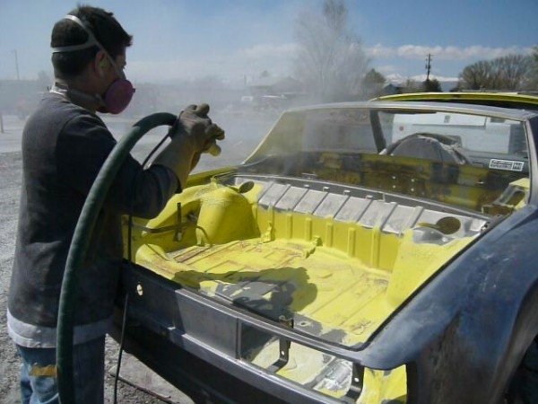

Just a heads up gang. This is commercial soda not Arm & Hammer stuff. While you can get a simple gun and shoot Arm & Hammer (good for carbs and small parts), the commercial stuff comes in 50lb bags and you sometimes pay by the bag. The commercial soda has the consistency of large grained sand.
My car was under $600 because we had glass hoods and we DA'd all of the flat surfaces prior to bringing it in. We used soda on both trunks, the engine compartment and the underside.

Are you kidding...no faceshield?

What you see is what you get. After about an hour I asked him if he wanted to use my saftey glasses. His eyes were bleeding.
