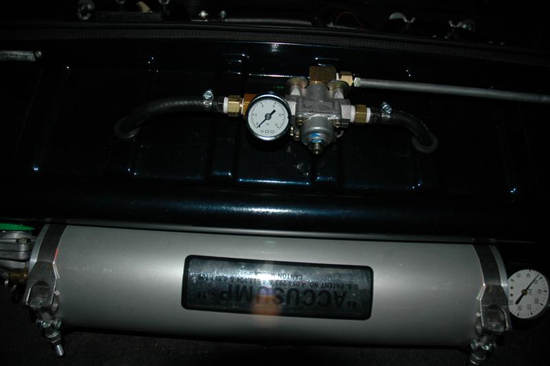

As has been said....get a CB pump up front with a filter between the tank and pump...one near the carbs....Holly regulator with gauge.....here's my Holly reg./gauge....although it's on a six the same would apply for a dual carb four....

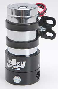

I went with the Holley 125 low pressure pump and their matching regulator. Check Summit or Jegs for best prices.
(IMG:http://www.914world.com/bbs2/uploads_offsite/i954.photobucket.com-11663-1301021620.1.jpg)
(IMG:http://www.914world.com/bbs2/uploads_offsite/i954.photobucket.com-11663-1301021620.2.jpg)
Not cheap but dependable and quiet.

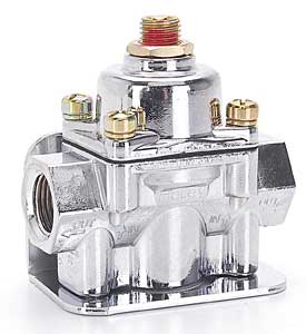

Think I like this Regulator
I also like the Holley pumps but they are pretty steep in price.

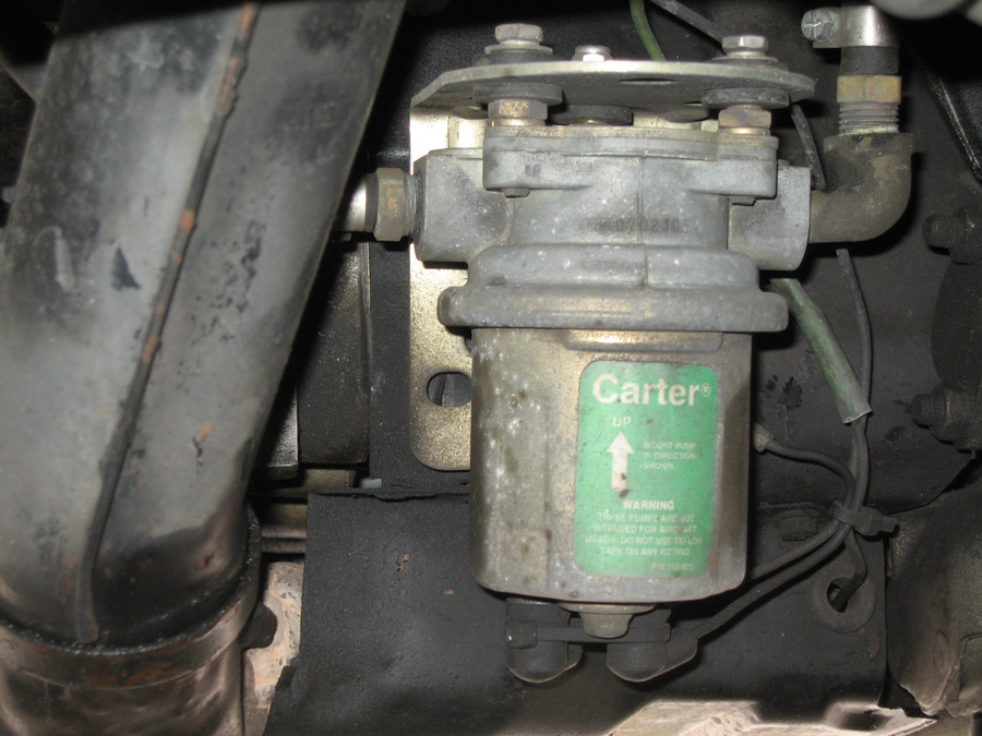

From my experience with rotary pumps, they say they are high volume low pressure, that they will give you 3 1/2 psi unregulated, but the actual is more like 5 or so, more than enough to get by a lot of inlet valves. I've got a carter rotary pump and the holley regulator, plus vdo in compartment gauge.
(IMG:http://www.914world.com/bbs2/uploads_offsite/images.thesamba.com-11782-1301091217.1.jpg)
(IMG:http://www.914world.com/bbs2/uploads_offsite/images.thesamba.com-11782-1301091219.2.jpg)
That's my type 4-engined bus there, as the 914 is fuel injected still.
