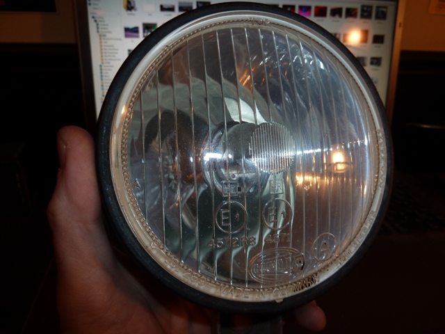

MDG
post Mar 25 2011, 02:07 PM
Wolf in wolf's clothing.
Posts: 8,653
Joined: 3-February 09
From: Toronto
Member No.: 10,018
QUOTE(ArtechnikA @ Mar 25 2011, 06:36 AM) *
These are (very) high-intensity clear-lens supplemental pencil-beam headlights.
I've seen a couple pair come through the classifieds here. I wish I'd had the foresight to take the pair from my car... I might have a picture but I doubt it'll show much... IIRC they were Hella lights and took an H1 lamp.
These? I bought these Euro lights off Gerold last year.
ArtechnikA
post Mar 25 2011, 02:16 PM
rich herzog
Posts: 7,390
Joined: 4-April 03
From: Salted Roads, PA
Member No.: 513
QUOTE(MDG @ Mar 25 2011, 04:07 PM) *
Maybe. I think so.
I don't remember the vertical lines, but then it's only been 25 years since I last saw mine, so I couldda forgotten a small detail.
At the time I had no idea how rare and special they were, and I always thought I'd be getting the car back 'real soon' ...
Anyway, when Gerold put those up I rember thinking they were just like mine...
MDG
post Mar 25 2011, 03:26 PM
Posts: 8,653
From: Toronto
Member No.: 10,018
QUOTE(ArtechnikA @ Mar 25 2011, 04:16 PM) *
Maybe. I think so.
I've only ever seen them with these lenses - I thought Eric has a set for his GT build with the yellow lens? The outer diameter of the housing is the same as the North American version but the lens itself is a larger diameter than the NA lights.

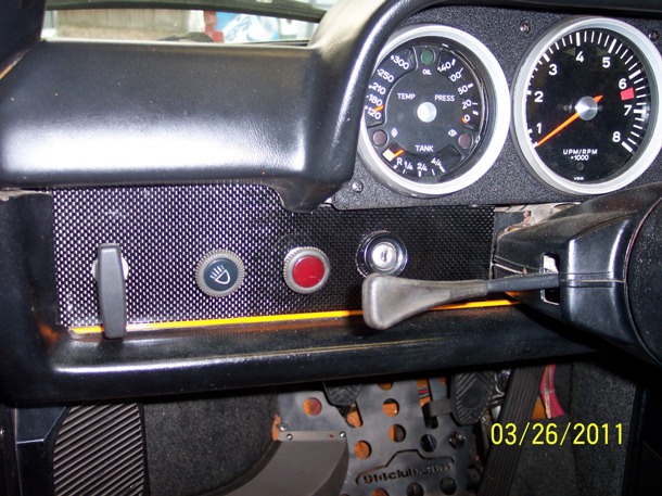

RON S.

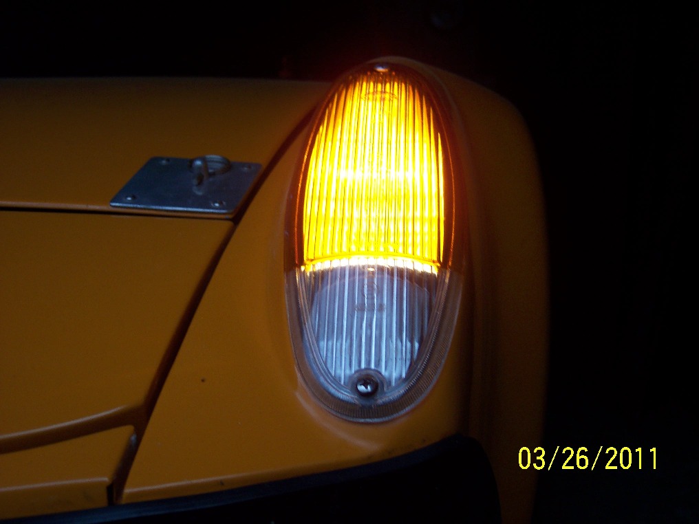

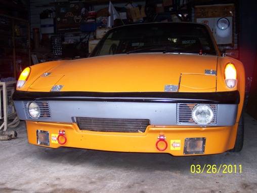

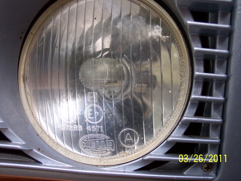

post Mar 26 2011, 04:36 PM
9140430841, FINALLY RUNNING
Posts: 1,216
Joined: 22-May 03
From: WALTERBORO,S.C.
Member No.: 724
[quote name='SirAndy' date='Mar 21 2011, 01:06 PM' post='1447194']
[quote name='RON S.' post='1447137' date='Mar 21 2011, 10:19 AM']probably due to different lighting laws.[/quote]
That Sir, was my point ...
I know for a fact that the law in Germany does prohibit the use of fog-lights with your high-beams. That is the current law and that was the law in 1970.
Fog-lights are wired to only run with the low beams. They must shut off when you switch to the high beams.
Every car i ever owned in Germany was wired that way. It's the law.
Note that i don't use the word "driving lights" on purpose as they were NOT driving lights from the factory. Ever.
PS: If you cars lights work differently, someone along the way must have changed the wiring.
[quote name='Jasfsmith' date='Mar 24 2011, 06:33 AM' post='1448474']
[quote name='SirAndy' post='1448164' date='Mar 23 2011, 05:18 PM']
[quote name='Jasfsmith' post='1447545' date='Mar 22 2011, 06:23 AM'] I can flash them when in low beam as well.[/quote]
If you can flash the fog-lights, someone did indeed change your wiring ...
http://www.jwesteng.com/porsche/914/fog.htm
[/quote]
Not I, and I seriously doubt that the prior owner (a doctor) did it. When the weather warms up, I'll try to trace the wiring.
[/quote]
[quote name='SirAndy' date='Mar 24 2011, 07:30 PM' post='1448734']
[quote name='ArtechnikA' post='1448681' date='Mar 24 2011, 05:12 PM']He's not talking about fog lights, he's talking about the driving lights...
( My Euro 6 had them too... )[/quote]
Well i'll be damned ...
German cars, especially of that period didn't have "driving lights" they way American cars have them.
The only thing i can think of is that because the headlights were otherwise hidden, Porsche added a additional driving light option to replace the fog-lights???
I can honestly say i have never seen this on any other German car of that vintage.
Time to whip out my PET copy and do some digging ...
(IMG:style_emoticons/default/type.gif)
[/quote]
Andy,
I wasn't trying to BS anyone with my inquiry. I am glad my response has generated some good discussion about the wiring issue. Attached are a photo of the "DRIVING LIGHTS" and the left side dash of my car.
This car is an original -6 numbered 9140430841. I bought as a rusting hulk off a local car lot back in 1998. The PO was a former Army man who brought the car back over here from Germany when he returned to Fort Hood Texas. The car is a full Euro car, every detail that separates the Euro market cars from the American market ones was in place when I got it. I actually feel lucky having a "Different kinda car".
I will repeat myself in saying that I personally removed the dash wiring harness during my restoration, and I actually WAS looking for evidence of someone butchering up the wiring harness to make the lights function the way they do. However, I witnessed NO evidence of any kind of tampering at all. All factory connections and taping is INTACT. All factory leads are only long enough to reach their plug in destinations on the light switch and the emergency flasher switch. Again, when I got the car there was NO hole in the vinyl dash fascia to indicate that a fog light switch had ever been there and been removed. When The car is running, and I pull the turn signal switch toward me, the driving lights will come on.
I must believe that it is originally the way it was wired when it left the factory. At least I know I'm not alone in this setup. (IMG:style_emoticons/default/idea.gif)

QUOTE(ArtechnikA @ Mar 25 2011, 03:36 AM) *
QUOTE(SirAndy @ Mar 24 2011, 10:30 PM) *
QUOTE(ArtechnikA @ Mar 24 2011, 05:12 PM) *
If you are thinking about 'driving light' in the context of 'running light' - that's not it.

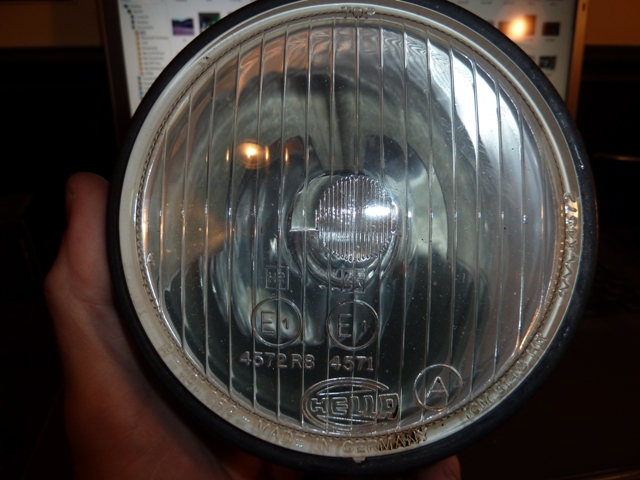

This is a nice rationalization, but I expect the practical reason is that all the stalk, relay, and headlight function was 911 bits on the /6's, and they just didn't change anything from the way the 911's worked.
I would love to see if a little-known 911 headlight mode made it into Euro /6's -- when the parking (city) lights are on (first detent on the headlight switch, illuminates a green dot in the cluster) the 'flash-to-pass' illuminates the _low beams_. I thought this was quite clever and I've never seen it documented - I stumbled onto it one night...
Hey Rich,

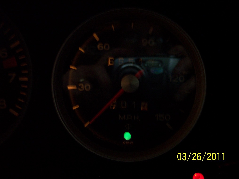

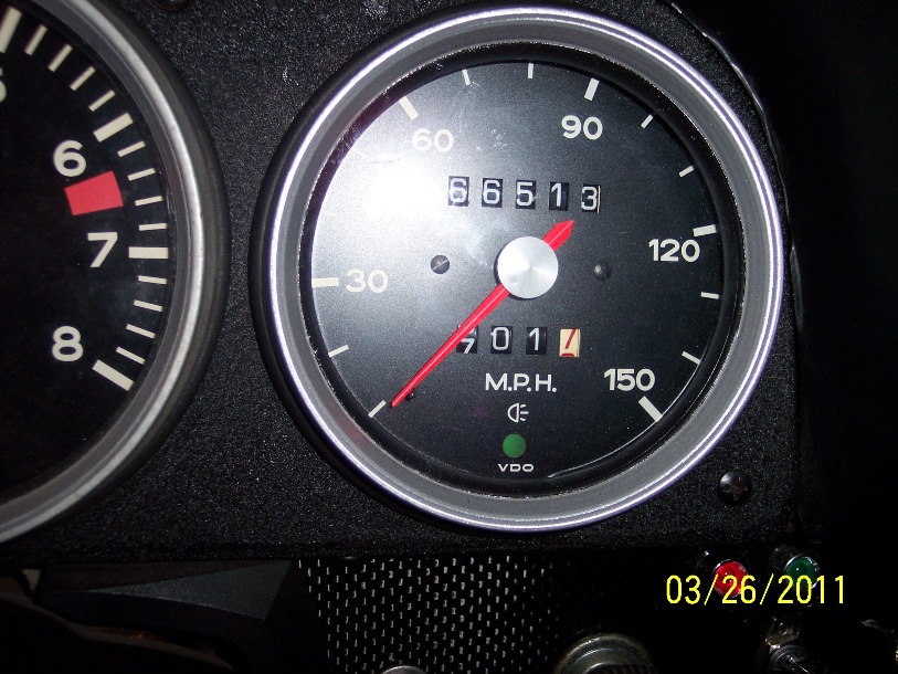

Here's the pics you are asking for of the little green dash light.
Parking lights on, green dasah light is on.
Ron (IMG:style_emoticons/default/biggrin.gif)

QUOTE(RON S. @ Mar 26 2011, 07:01 PM) *
Thanks - but that part I knew.
It will be difficult to test the interesting part, because it occurs to me that 914 headlights retract at the 'parking light' setting...
However (this will probably require two people...) the question is - when the parking lights are on and you pull back the flash-to-pass - what lights up? it _should_ be the _low beam_ lights.
Actually, this could be easier to test than I initially thought...
Enable the driving lights. Set the light switch to 'all off'. Verify that the driving lights light up when you pull the flash-to-pass. The high beams will light up too, but they won't raise. Pull the headlight switch out to the park position - the the 'green dash light' position. This time when you pull the flash-to-pass, the driving lights should _not_ light up (and if you can tell by looking into the headlight bucket, the low beams will.

Rich,
I just walked outside and checked. With the key on or off, light switch off, Flash-to Pass and Hi-beams come on with a pull of the lever, and Hi beam dash indicator also is on. With the key on, parking lights on, Flash-to-Pass does NOT engage.
All these years I've asked various people about the way my lights work, and the standard answer has almost always been that someone has rewired it to behave the way it does.
I have always believed the factory wired it the way THEY wanted it to work.
Also, if you notice in my dash pic, you'll see the pull lever on the left. I've removed my headlight motors, and converted the system over to the GT Headlight pull kit. But, I do remember that my headlights did NOT raise, when I would use the Flash-to-Pass during daylight operation.
Thanks for the lesson.
