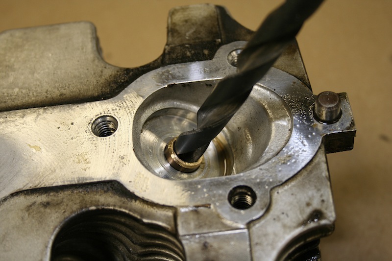

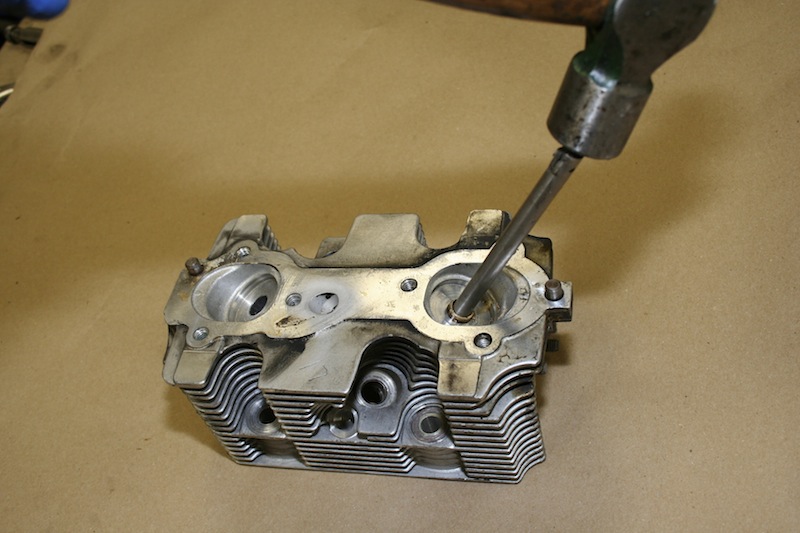

If you use bronze guides they need to be honed or the material "tears" Cast iron can be reamed.
In aluminum heads I would avoid just driving the old guides out. I use a drill and drill them thin but not all the way through leaving a step so you can drive them out by inserting a driver inside the guide and not on top.
I also chamfer the top of the guide before driving it out to prevent galling.
Remember that a valve transfers heat through the seat and valve stem and if you gall aluminum it affects heat transfer from the guide.

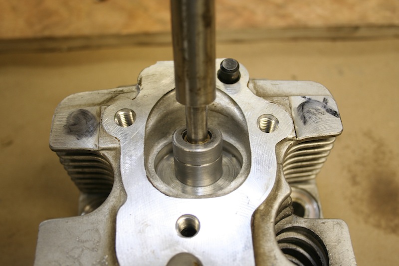

If you drill the guides out thin, they come out easy and no heat needed to remove.
To install I heat the heads but 425 is too hot in my opinion.
You can install the guides and have a shop hone them and cut the seats. That will at least save a few bucks.
When you drive the new guides in make a spacer to fit over the guide to prevent driving the guide in too far. The driver will hit the spacer and stop. It's hard to tell in this pic but you can see a metal spacer around the guide. The length is the factory spec for guide height
Also, don't use valve grind compound to lap the valves, that's a joke. The valves get hot, expand and don't ride in the exact spot anyway. If you cut the valves and seats properly they are both round and seat without any "help"
