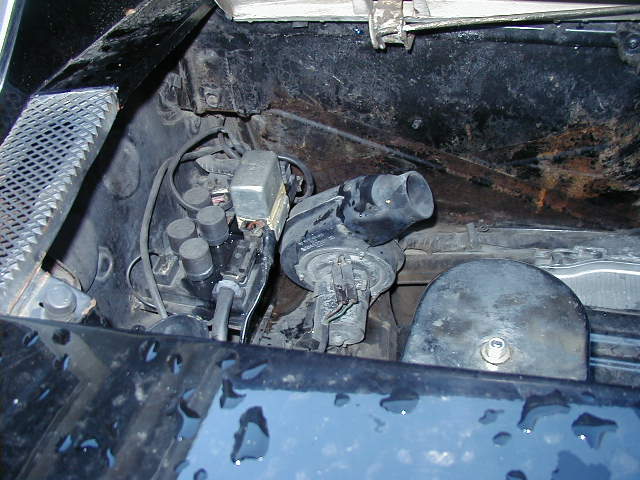

I didn't get a complete car when I bought my '75. Have acquired most of what was needed, but I'm finally trying to get heat into the car (just in time for summer, good timing, eh?) finding out a few heating items are needed.
This is what it looked like when purchased

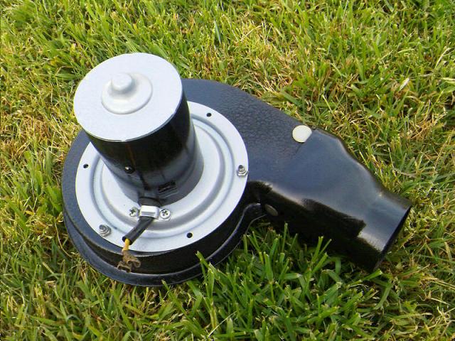

I recently disassembled the fan, cleaned and painted it, ready to install it.
It only has a single outlet (unlike the one on my wife's '71 - with two outlets) and I don't know if it uses a 'Y' connector to get fan air into the two j-tubes? (IMG:style_emoticons/default/confused24.gif)

IIRC later MY 75-76 had the Y connectors added again. Mine is an earlier MY 75 and doesnt have it. I know they are available from the usual places. Hope this helps.

Factory decided it didn't need both exchangers, so they went to a single feed. Splitter is available to feed both of them.

....Excellent detail job on the fan!
(IMG:style_emoticons/default/thumb3d.gif) (IMG:style_emoticons/default/thumb3d.gif) (did they come like that ?lol)

The 70-72 fan has two separate outlets, on opposite sides of the shroud.
The 73-74 fan has a single outlet, which was ducted to the left-side exchanger only. The top of the J-tube on the right side was capped off with a plastic cap and a hose clamp.
The 75-76 fan has a single outlet, but that outlet has a Y fitting on it. The outlet replaces the part you can see in the photo that has a square inlet and a round outlet; on the later fans it has two round outlets.
It sounds like early 75s used the 73-74 style of fan, which presumably means the right side J-tube is capped off. You can do that pretty easily (I think a spray paint cap fits well) as a permanent solution or as a temporary one until you get the Y.
