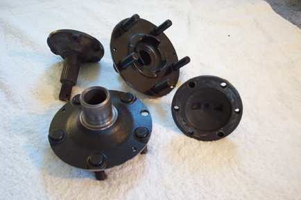

Is there a difference between 930 CV's and 930 CV's? I see them advertised in magazines like Hot VW's for like $40-$60 and I see Porsche CV's for something like $90.
I'm sure these CV's all fit the same, I was wondering if there are other internal differences between the different lobro parts. . . or do they just have a different part number for the Porsche just for price gouging's sake. Or are they all the same and some people have different importers/pricing structure. . . just buy from the cheapest guy.(IMG:style_emoticons/default/mueba.gif)

Call them and find out what the "kit" includes. Some kits include boots/grease/flanges. The cheaper kits come with a dry CV joint in a box. I wouldnt trust anything but lobro.
I have tested using the early 911 CV's that are the exact same size as a 930 but only have 4 bolts and two pins. I drill them out for the other two bolts and go on down the road. So far so good.

Do the 911 CV's hold together ok with the 2 pins and 4 bolts? My stub axles are 911 w/ the pin holes. I figure my application wouldn't be stressing them too badly.
Otherwise, is there any reason they couldn't be drilled and tapped for bolts?

The holes for the pins are too big to be tapped. They will work fine on the outboard side of the axle.
Those are SC flanges.. they dont exactly fit our wheel bearings (I know how to make them fit..) but the early flanges slide right in.
B

Uh oh,
Which part of the flanges do not fit right? I purchased them eons ago from Rich Johnson for my 914 w/ the rest of my suspension.
I wonder if he knew that or has already modified them. .. I'm clueless. I just buy stuff I think might fit <_<

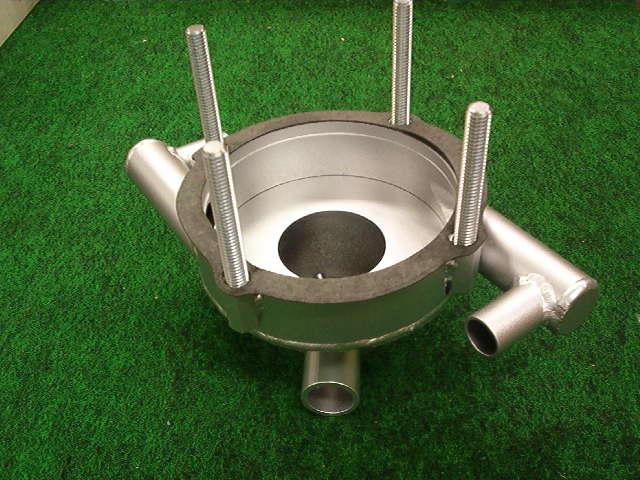

I found a relatively new conversion company surfing Ebay, Desert Hybrids. Run by a Mechanical Engineer with a CNC out of Tucson AZ. Different component layout than RH, I haven't seen a RSH kit to compare. Seemed like a bright guy from the email. Uses the Kennedy parts that no one else will admit to. Billet water pump housing anyone?? (IMG:style_emoticons/default/smile.gif)
Desert Hybrids
Cool. Of course the one pictured is not a "billet", but a "weld-up". I'm no expert on centrifugal pumps, but the sharp angles on this one don't seem right.

Seems to me if you have a clean sheet, engineering degree/CAD, CNC, then you should be able to produce a higher tolerance pump than that. i.e. machined elbows with a lip or features to hold the hoses on securely. Maybe it's a prototype...
He must use his CNC's alot more on high production parts since you need to run these 24x7 to pay for their capital and operational costs.

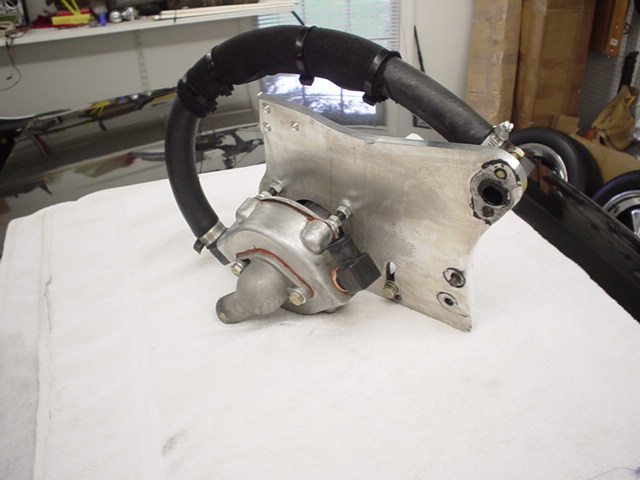

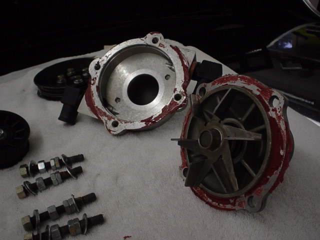

For comparison, this is the Renegade pump. I prefer the the inlet/out fittings since they swivel to allow proper hose orientation vs. being fixed. The conversion pumps are notorious for blowing hoses since there is no bypass provided to relieve pressure prior to thermostat opening. I agree that a ridge should be provided on all hose fittings.
The nuts tack welded to the desert housing make me a little nervous. They take the stress of the bolts securing impeller housing as well as pressure applied from drivebelt while in operation. The tension applied to secure belt when tight is transmitted to these nuts. Guess the nuts were easier to install vs. machining into housing but either a full weld should be applied or machine these threads into pump housing should provide added strength.
Attached is a Renegade pump. Excuse the RTV mess. Mo' is not always better : ) Got it right the second time around.

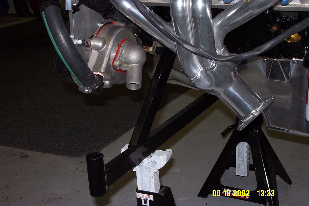

Davids(Desert Hybrids) steel pump housing lines up nice when mounted on the engine.
Bob

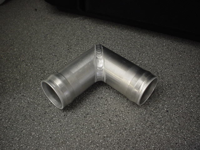

Renegade now offers this piece to aid in eliminating kink in rubber hose at water pump inlet. I am currently running a steel spring in my hose to eliminate kink and plan to install this piece next time system is drained.
What I'd really like to see is this extention be part of water pump inlet.........two less hose clamps, two less potential water leak points.
