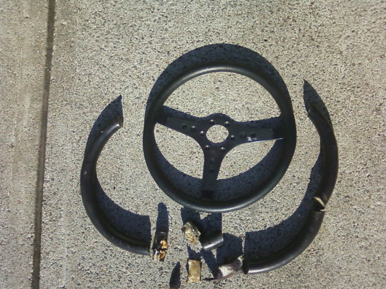

I have an Racemark steeering wheel , the leather is shot and seems to be bubbling something from inside out.
So I attaked it with a band saw. Strange inards, U shaped steel channel ,rivetted to the spokes and then coated with a rubber like goo.

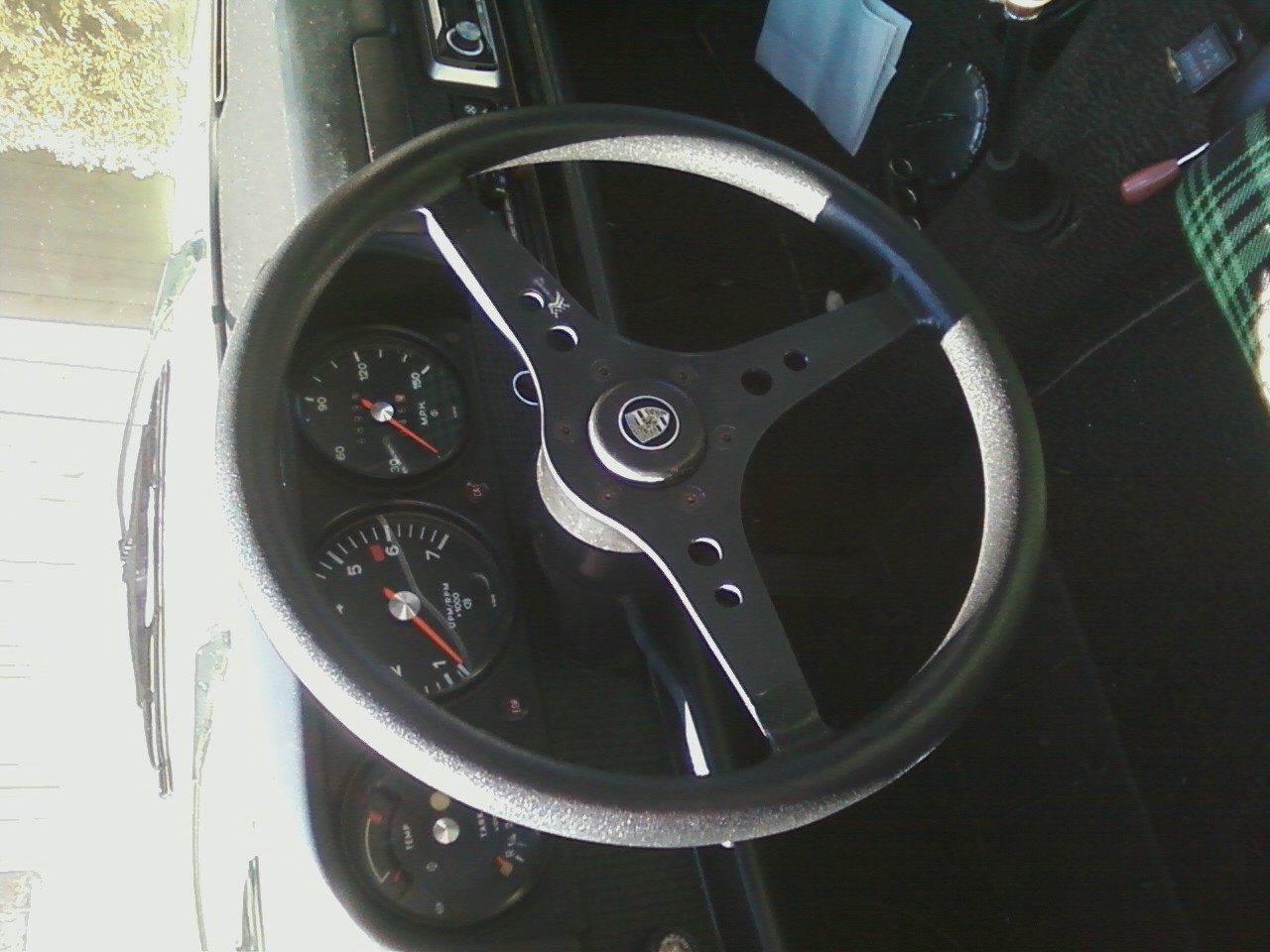

I like my 370mm prottipo in my GT, so I decied to make my Racemark 370mm
Rolled a piece of 6061 al 1.05 dia. to 370mm and welded it to the spokes.

Whoa!!! (IMG:style_emoticons/default/sawzall-smiley.gif)
So you rebuilt your wheel (IMG:style_emoticons/default/w00t.gif) and it looks very good in pix..

I searched everyware for Corinthian leather, No luck.
http://en.wikipedia.org/wiki/Corinthian_leather
So off to the auto parts store, and found , gheto swade.
Otherwise known as spray bedliner.
looks and feels fine for my driver.

Its an aluminum tube . It is way lighter than the way it was. If I like it I am thinking about trying to stich up a leather cover .
In WA state i dont really have to worry about to much sun.
