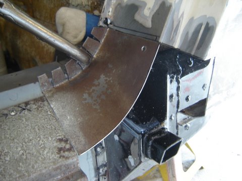

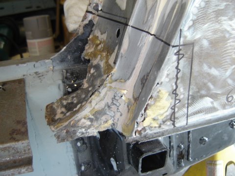

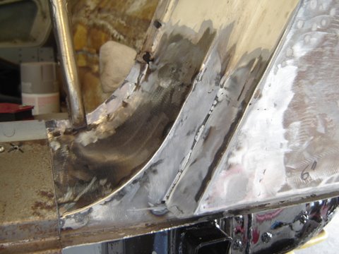

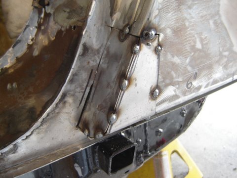

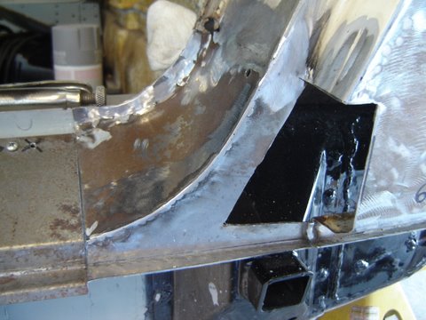

Had to create the transition from the driver's door threshold to the striker plate as well as the leading edge of the front fender. I didn't realize that latter portion was nothing but braze and bondo until I started grinding the paint back to get my cut lines.
The lower section of the rear fender (directly under the sail) is still free from the car. I screwed and clamped it in place while I made the pieces pictured. Once it's welded back onto the car, I am going to have very limited access to the back side of the repairs.
What I WANT to do is treat/seal the back side of the repair which will be the most prone to be hit with moisture/debris from the tire.
That said, here's my issue:
I do not yet own a paint gun, nor epoxy primer. I'm going to Ospho the back side of this area and then I hoped to prime, seam seal, and undercoat it (do not care about not having body color back there--just want "tough") with the fender still unattached to the car.
I know it's frowned upon but is there something in a rattle or brushable product I could treat the area with to make it impervious to the elememts later?

Rust-oleum and por 15 can be applied with a paint brush.
Also harbor freight has paint guns for $15-30. Get a 1.8 tip gun.

QUOTE(TargaToy @ Jul 23 2011, 12:07 PM) *
Your repairs look great! (IMG:style_emoticons/default/smilie_pokal.gif)
Our projects appear similar in scope. I will probably get torched for this, but I have been using Eastwood products in "blind" areas over bare metal. Specifically, "Rust Encapsulator" in an rattle can. On areas directly exposed to the elements (fender wells, etc.), I use rattle can rubberized undercoating over top of the encapsulator. However, I can not speak to the longevity of this method over the long haul, as the car remains on jack stands.
