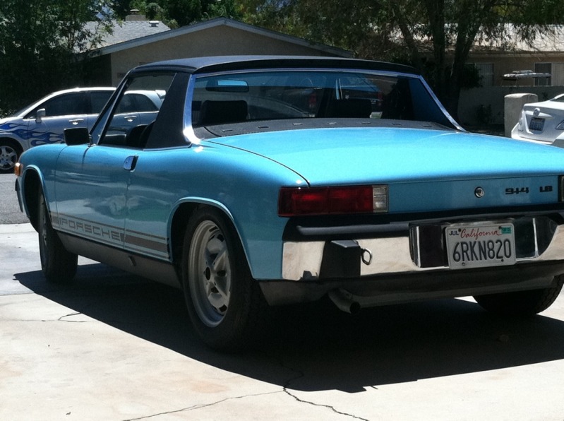

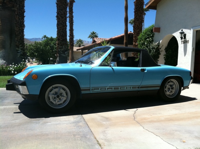

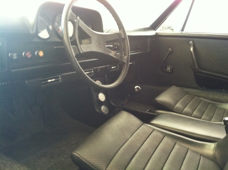

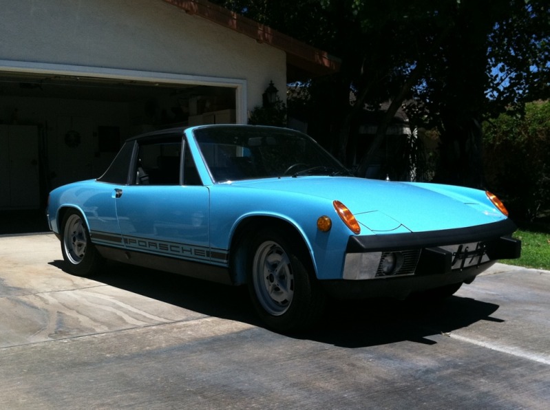

Here are some pics of her as she sites today.
(IMG:http://www.914world.com/bbs2/uploads_offsite/img.photobucket.com-10656-1312576214.1.jpg)
(IMG:http://www.914world.com/bbs2/uploads_offsite/img.photobucket.com-10656-1312576215.2.jpg)
(IMG:http://www.914world.com/bbs2/uploads_offsite/img.photobucket.com-10656-1312576215.3.jpg)
(IMG:http://www.914world.com/bbs2/uploads_offsite/img.photobucket.com-10656-1312576215.4.jpg)
Lots of little items to address, but she will be as close to "AS-DELIVERED" as I can make her.

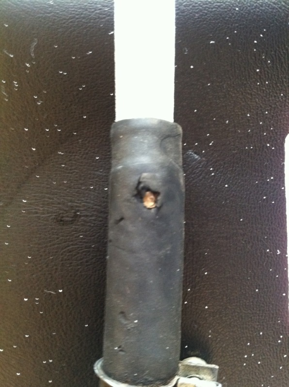

Fuel injector leak that put a damper in the first drive.

I just read Bee Jay's thread and realized I'm damn lucky my fuel leak didnt lead to fire. I had fuel spewing all over left side of engine, dropping on to the engine tin right below fuel rail, and then dripping down on to the heat exchanger.
When the car died, I pushed it off road and called AAA. when flat deck arrived, I turned key to unlock steering wheel. I heard fuel pump going and looked underneath to see fuel dripping off heat exchanger. Turned off key and flat decked it home.
At home, removed air intake, and revealed fuel sitting on the engine tin, right under th einjectors. a tturn of the key, and I saw the fuel spewing out of the pinhole in the injjector hose.
Again, damn lucky she didn't burn.

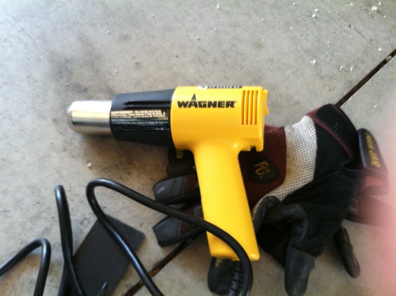

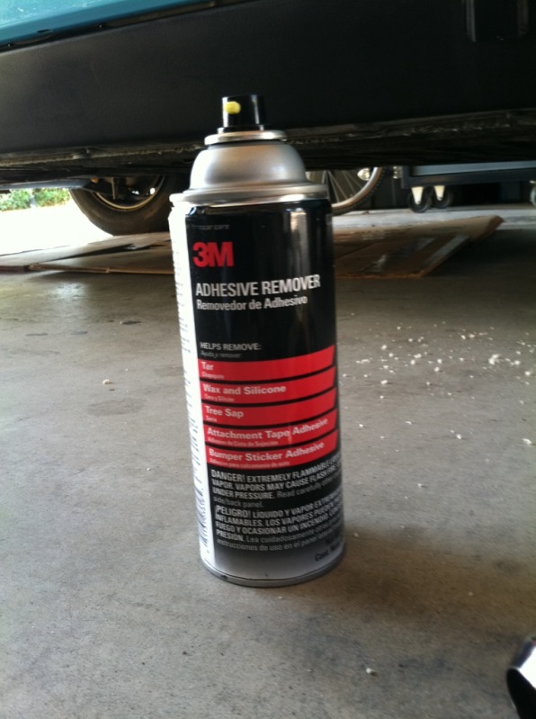

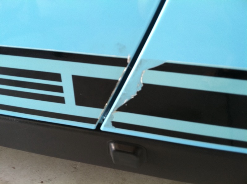

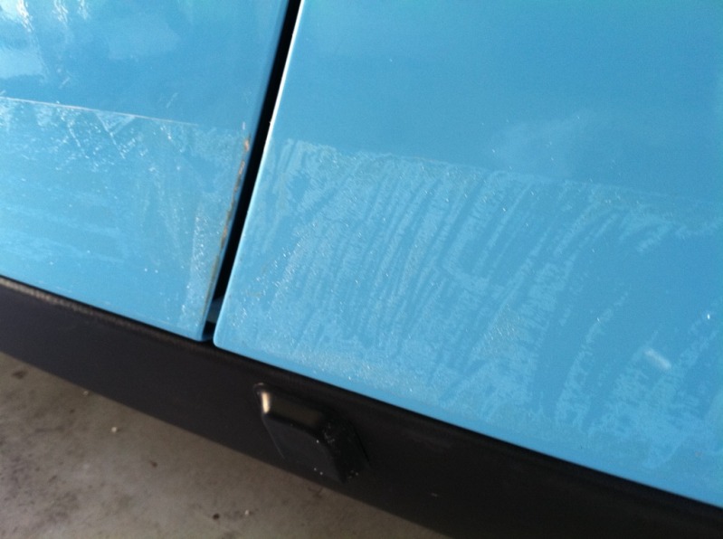

Starting cosmetic clean up today. Removed old stripes and now trying to get the adhesive cleaned up. 37 year old adhesive does not want to come off.

Naphtha removes adhesive real good.

The car is looking great! Good catch on that leaky injector, I had something similar happen after the car had been sitting for a while... split fuel line, had a dang geyser shooting out of the engine bay. I must of stood there for 15 minutes with the fire extinguisher in my hand waiting for something to catch... (IMG:style_emoticons/default/wink.gif)
