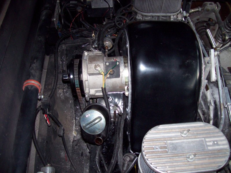

Here is how I cooled my 914 engine.

I have an external oil cooling system I'm looking and my engine temp is not extremely high. It runs around 270 (from the CHT connected to my SDS). Oil temps run between 220 and 240 on the high side. So, I'll get to the cooler at some point.
That's an interesting shroud 904svo. Did you notice any lower temps using it?
