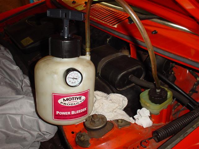

http://www.motiveproducts.com/
These are the pressure bleeder I was talking about. They make a Euro cap which threads right on to our res tanks. They are the cats ass. I use it for bleeding all my cars.

Yes I agree with Zach. I have used one for about 5 years. Makes bleeding a one man job.

Yup. I built a pressure bleeder with an old cap way back when, and it was a bit of a PITA. The Motive bleeder is great because you can run a whole quart of brake fluid through the system without opening the reservoir.

Yup, that what I did -- a one-gallon water sprayer from Home Despot for something like $10, an old MC reservoir cap, and a brass adaptor that accepts the sprayer hose. Works great.
