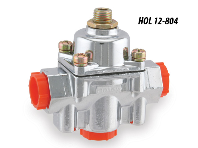

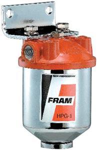

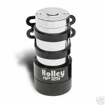

Yeah, although that doesn't count what I already spent on the Holley pump, regulator and Fram gas filter..

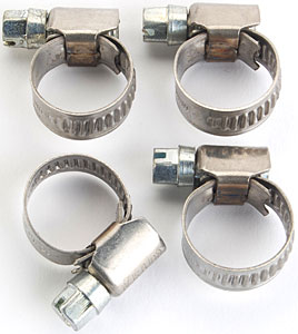

You can also get the "screw drive" hose clamps from Jegs that do not cut the soft hose.
(IMG:http://www.914world.com/bbs2/uploads_offsite/www.jegs.com-10819-1319041170.1.jpg)
http://www.jegs.com/i/JEGS+Performance+Pro.../16050/10002/-1
Notice they did not cut the slots all the way through, so no sharp edges.
I searched about 10 local FLAPS and could NOT find a 3/8" fuel injection hose clamp that would go over the 30R9 WHEN IT HAD A HOSE BARB IN IT.

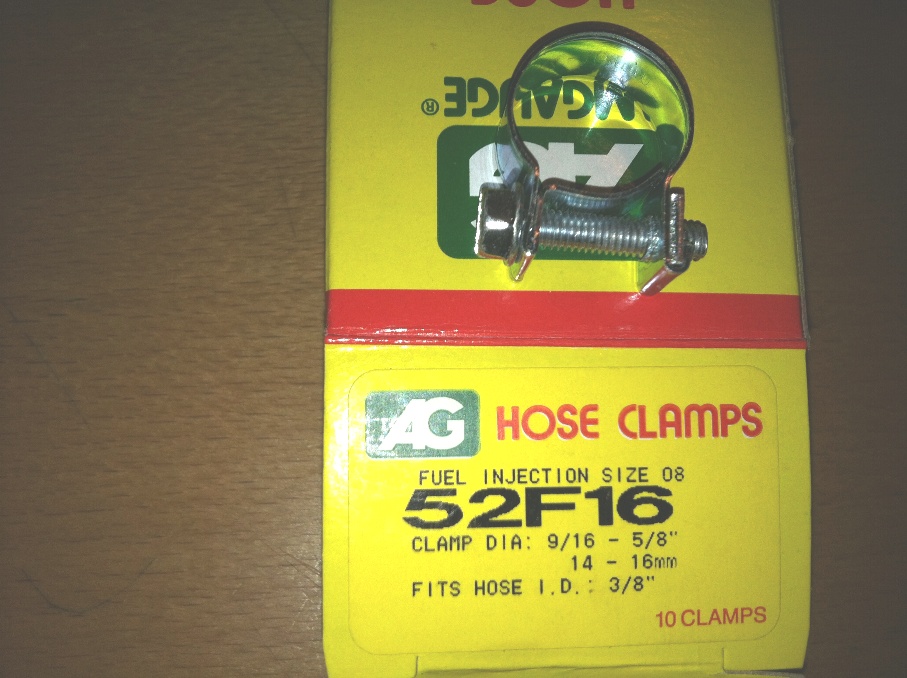

Stu
These look like they will work. I'll see when the hose arrives.

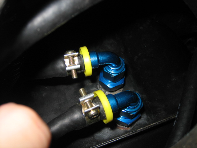

I tried to get at those hoses from the bottom (see first pics) and it was impossible. Plus getting stabbed by the sharp edges of that braided hose was a PITA.
Problem is solved for the future now. Ill post pics later of the solution in a new thread.
