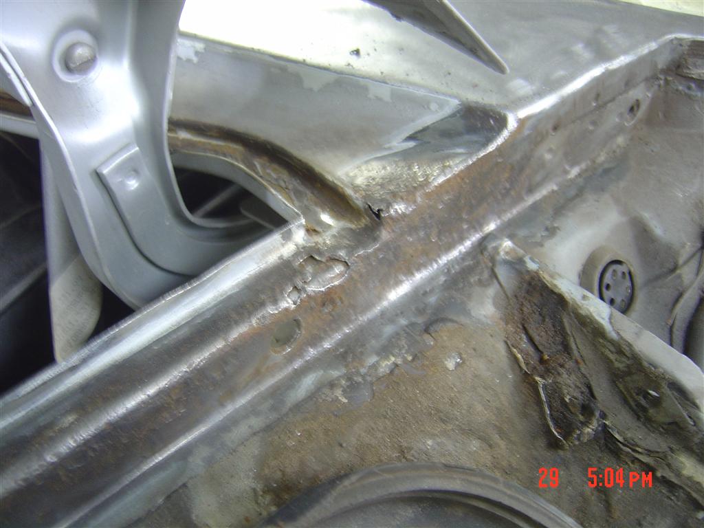

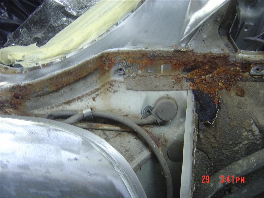

scotty b
post Oct 19 2011, 10:12 AM
rust free you say ?
Posts: 16,375
Joined: 7-January 05
From: richmond, Va.
Member No.: 3,419
QUOTE(Phoenix-MN @ Oct 19 2011, 08:04 AM) *
front suspension pan (battery acid rust out)
Rear seat pan (leaky rear window)
(IMG:style_emoticons/default/agree.gif) Those are the main ones. In addition to that, is one you can't see with the fenders on the car, near the cowl they tend to rot out. But like I said, you can't see that with the fenders on. Pic is of one I just did. then there are the headlight buckets. suspension pan repairs can get ugly, and quite costly.
http://kahikocustoms.com/wordpress/?p=102
