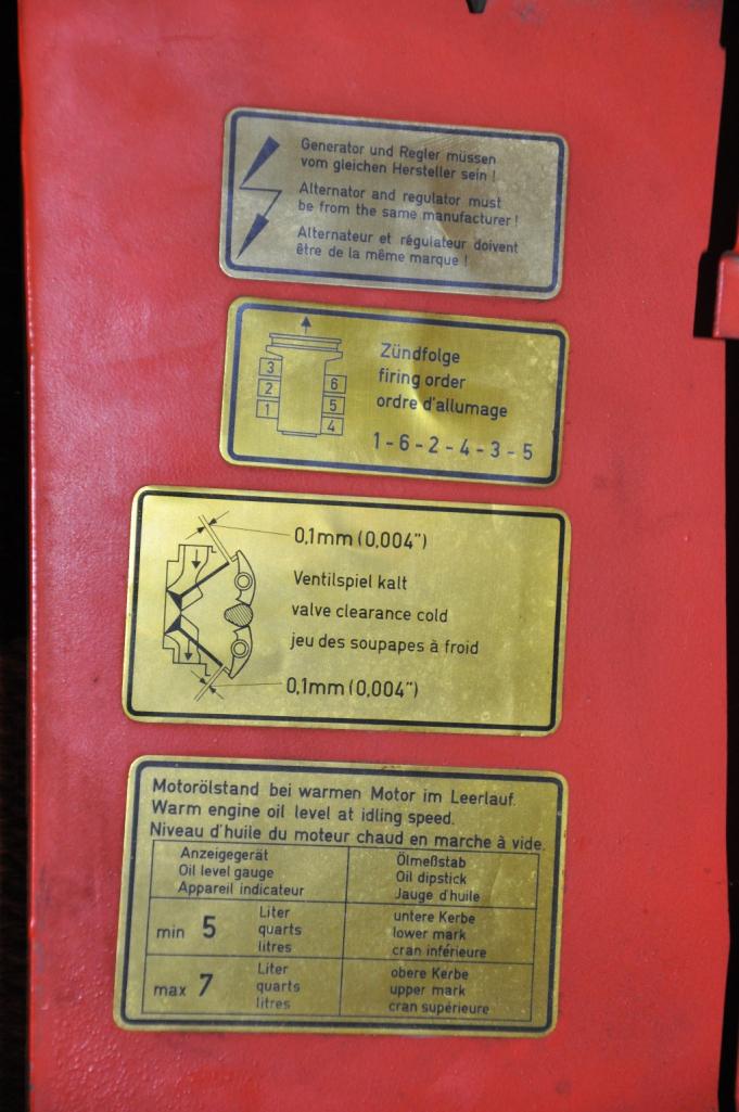

Offhand, I'd say 4cyl. lid
The foil stickers are arranged 90 degrees off, the missing ones seem to have been wrong too. No sticker over battery.
Tabs to hold a rain tray that was never used on 6s
But manufacturers are known to use what they have on hand.....
The blue lid in one of the replies appears repainted from white and the stickers are spaced away from each other.

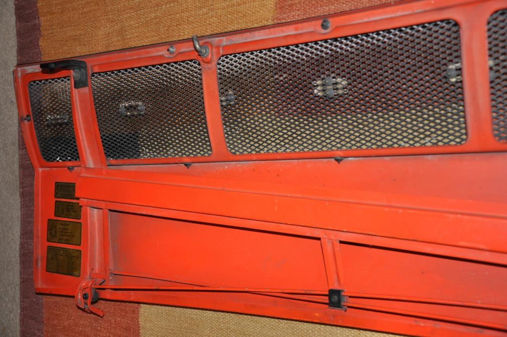

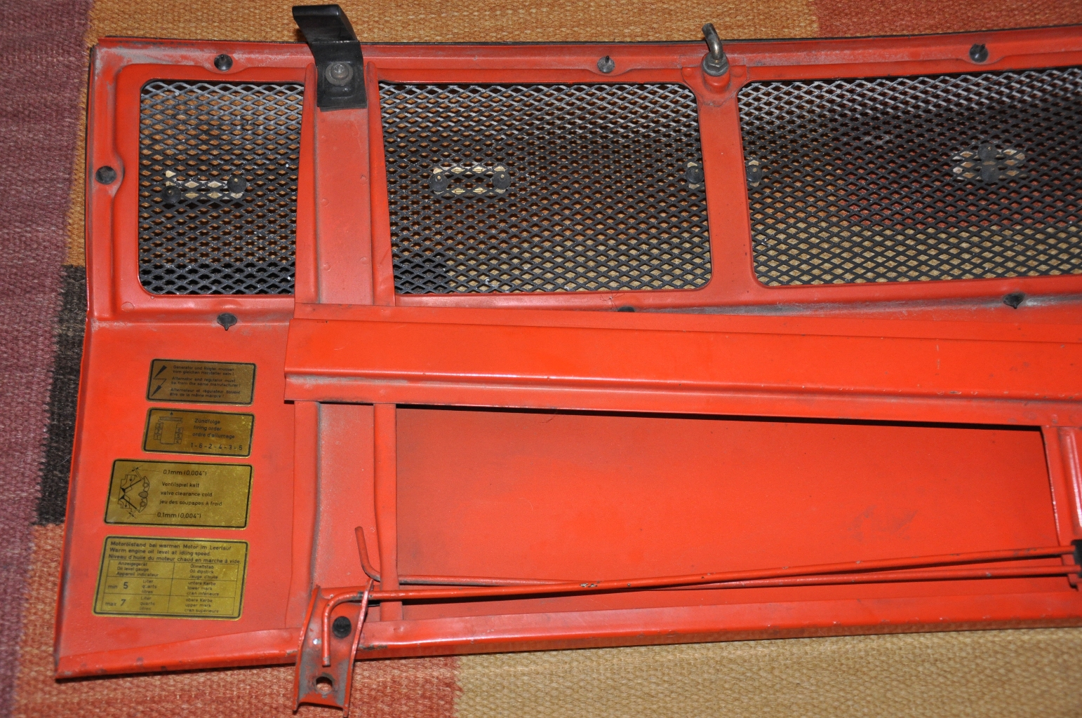

Check attached pics of orig green lid and restored orange lid . No tabs on either.
Will check a third lid that is orig as well.
pics of 6 eng lids
My lid was a repaint from paint code 80 silver metalic to black so who knows what they did with the stickers! Also mine doesn't have the screw holes for the rain tray so it couldn't have had one!

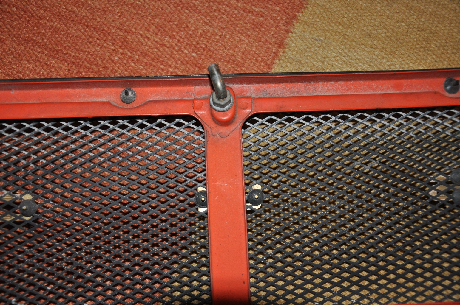

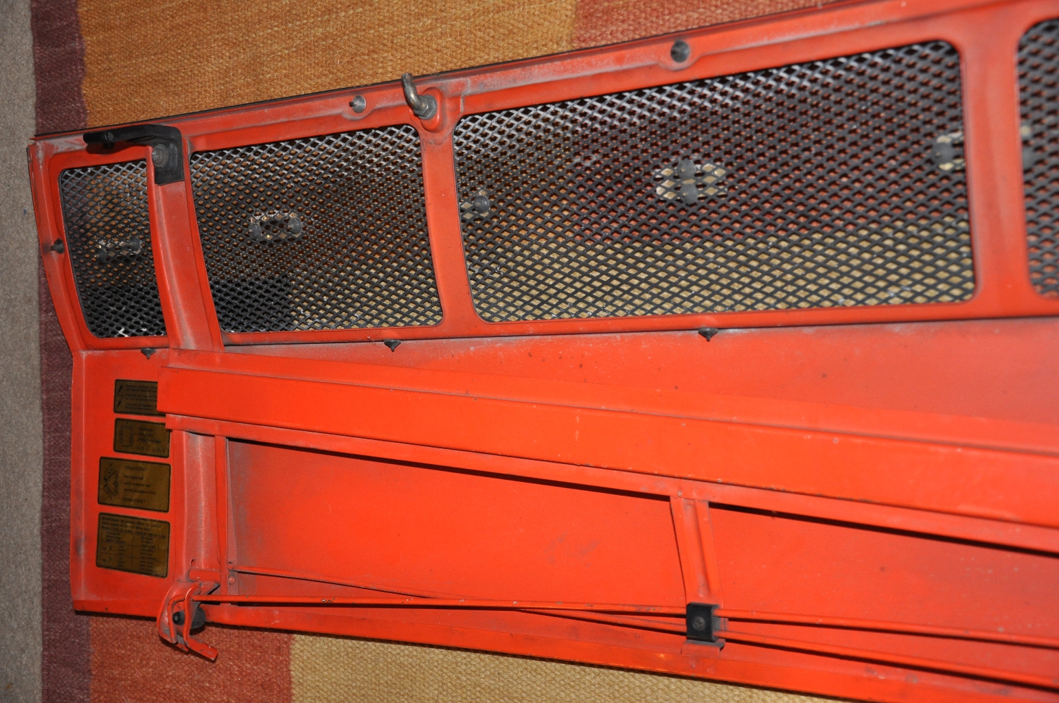

No tab or sign of one and some pics. I noticed there are no threaded holes on the cross brace on this -6 lid and torrsion bars are a smaller diam.

and a few reference pictures since this lid will be media blaster before it turns Canary yellow for my car (IMG:style_emoticons/default/popcorn[1].gif)
