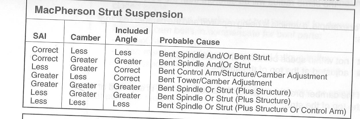

When you say "locked out", does that mean you can't get LESS than 1.2 degrees or you can't get more than 1.2 degrees on the right-front?
There are a lot of bent spindles out there.

If you can post the SAI readings (if taken) they can be used to diagnose whether any suspension parts or structure (tower) has any damage, bent or mis-alignment.

Here are the SAI numbers:
Before/After
Left 12.19/11.97
Right 11.74/24.04
Included Angle
Left 10.86/10.97
Right 10.83/22.84
I do think this car was hit from the back at some point but it actualy drove pretty well even before the alignment although it seemed to hunt in straight lines.
Before/After
Left 12.19/11.97
Right 11.74/24.04
Included Angle
Left 10.86/10.97
Right 10.83/22.84
And here is the flowchart

I did say the car was hit in the back at one time, however the struts are new and the car has barely been driven.
ellisor3
post Jan 14 2012, 03:55 PM
HPWhore
Posts: 811
Joined: 23-October 08
From: Fleming Island, Florida
Member No.: 9,683
So you are saying there may be an issue with the right strut plus structural damage since SAI Camber and Included angle are all greater??
Jeff Hail
post Jan 14 2012, 04:31 PM
Posts: 1,141
Joined: 3-May 07
From: LA/ CA
Member No.: 7,712
QUOTE(ellisor3 @ Jan 14 2012, 01:55 PM) *
I am more concerned with the before measurements. The SAI and camber were very close before any camber adjustments were made. You mentioned the corner balance went well. I assume this is a lowered car with the bump steer kit installed. How did the ride height turn out?
Based on the specs I dont think without seeing/ measuring the structure is off.
The before specs showed a slightly lower SAI on the right front but IA was ok.
Everything went skyward when the camber was adjusted. I'd go with a strut housing/ spindle assy. Check the ride height also to make sure both control arms are level or at least equal if car is lowered. You mentioned the struts are new. The housings or just the inserts?
