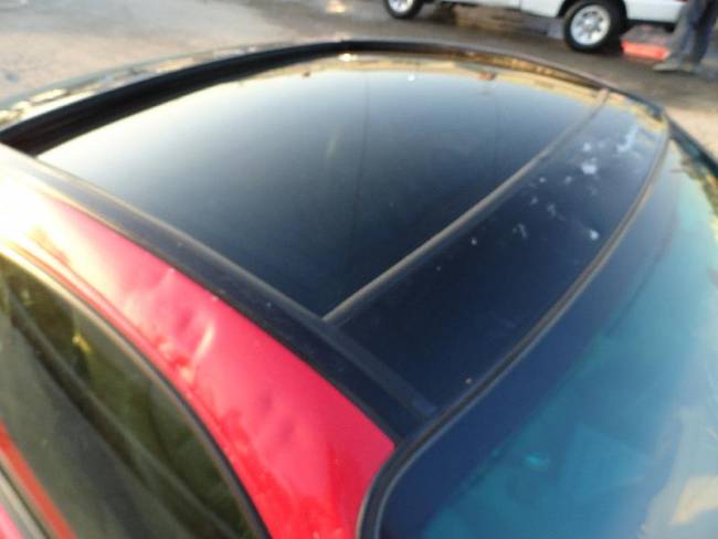

(IMG:http://www.914world.com/bbs2/uploads_offsite/wreckedcarsforsale.com-172-1331343751.1.jpg)
Money shot...
However there are a couple of ways of going about fixing it... The Mayco way, then the real way...
The real way? 15-20k.. If not more.
New fenders, new front bumper, new doors, new glass, then the bodywork...
Mayco way.. "We could fix that for 3k!" Shitloads of bondo, and a new bumper skin (if they couldnt plastic fix it).
If you want it and the suspension and drivetrain check out... Get your hands wet and learn bodywork. Fix it slowly yourself and be proud of the work you have done and the mistakes you made.
If you scored the fenders and doors from a salvage yard, you probably have a months worth of hammer and dolly work plus a gallon of bondo to fix the rear.. Some plastic welding on the front bumper, and then about $800 in materials to paint, or 500 if you went with an off the shelf non waterbased color.

Oh and the targa roof not being closed all the way is bothersome...

If you can verify that the roof and windows work and fit properly I would say the low side would be 5K. It will need a full repaint. If the roof and windows are out of place you're looking at frame time at 8+ finished (IMG:style_emoticons/default/sad.gif)

That is probably the only way I would really want to do it. And, yes - the top not closing fully could be very bad.

Look at the rear of the rocker on the drivers side. That wasn't a baseball bat, and it might be pretty hard to fix. The more I look at it, it was rolled. The damage on the roof, and the way the driver's mirror dented the door. For all I know, it could have landed on a tree trunk or fire hydrant. The roof isn't closing, which can't be good.

Looks like the top is tweaked. To me, that says it's perilously close to "parts car" territory.
