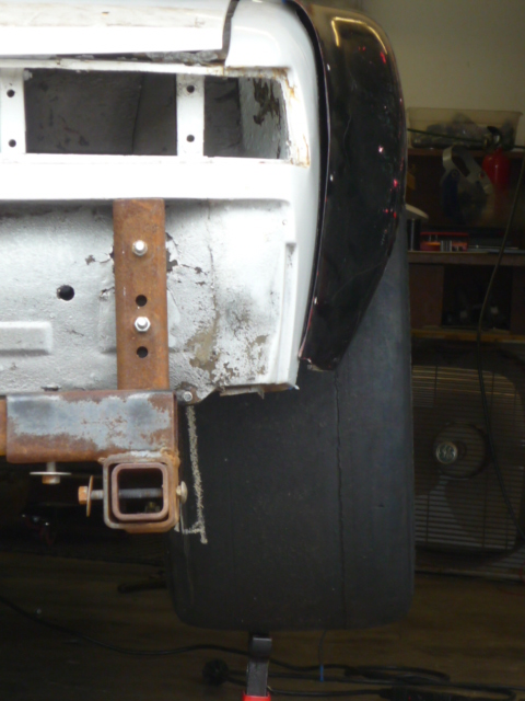

I'm looking at a set that are 16x10. Since you only have about 10" to work with on a stock rear GT flared car, a 10" rim/tire may fit (if your rims have the perfect offset), but will have no room to move under compression. I'm running 9" slicks at the track on my car and it's a really tight fit if you take the movement of the tires into account. (IMG:style_emoticons/default/shades.gif) |

I have just enough to slip a fat envelope between the tire and flare The outside is not the problem. If the tire is too wide, it will rub on the inside under compression. A 10" wide tire does not leave much room on the inside for movement, even it is really close to the outside lip. The 9" work OK, if the offset of the wheel is correct. (IMG:style_emoticons/default/shades.gif) |
