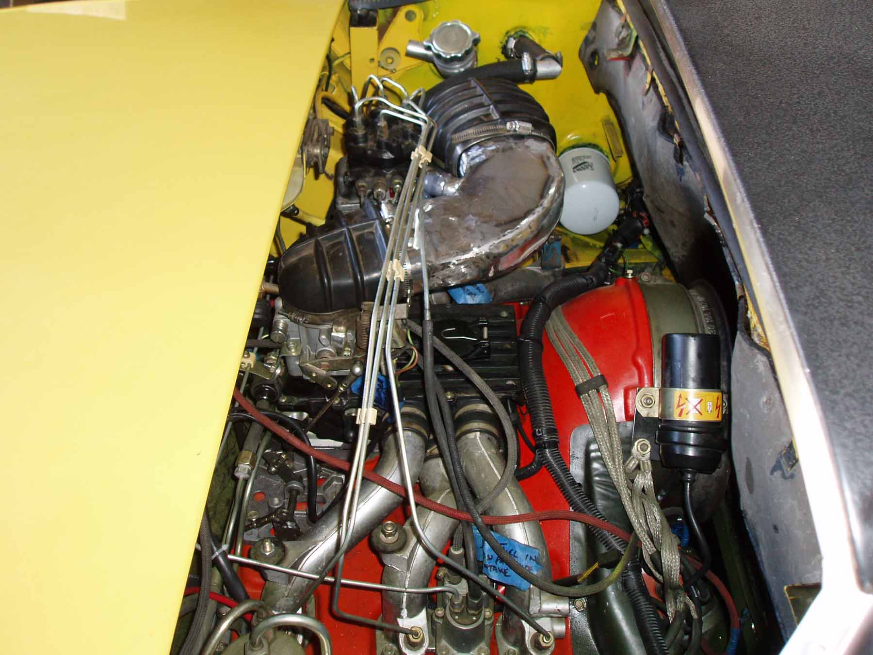

So, one of the design things needing to be addressed to meet the and of the month deadline for completion is how to hook the CIS box to the intake. I have been looking at Volvo air boots, but the best think I am seeing is the 924 boot here:
http://www.ebay.com/itm/Brand-New-Porsche-...de7&vxp=mtr
Any other suggestions? I am wishing to go from vertical to horizontal and with the 924 boot I can do this with a simple elbow (IMG:style_emoticons/default/smile.gif)
That looks very similar to the 3.0L intake!
You can do something like I did for the Volvo intake and the welded up elbow. I cut the original intake boot and made the elbow to fit my needs! Then I clamped the cut intake to the elbow to match everything together!
Jeff,
This is looking like the best setup for the intake. How did you make the connecting tube? I will need to know so I can copy it (IMG:style_emoticons/default/smile.gif)

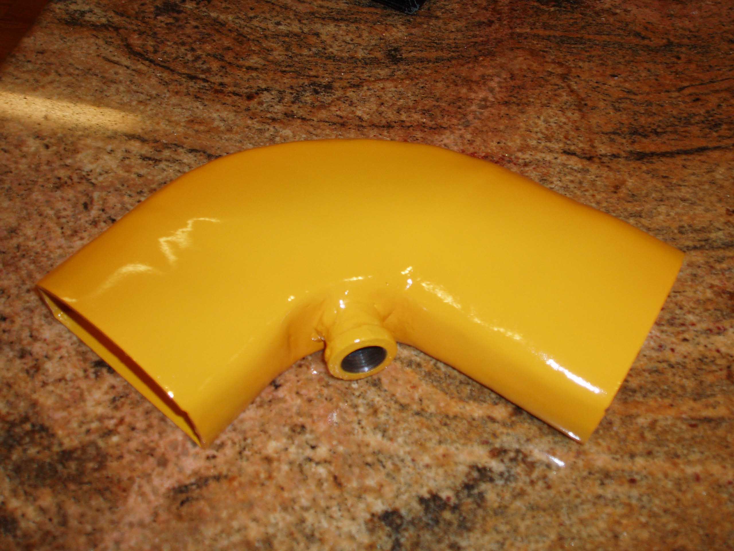

PS: I used two different boots so I could cut extra material on each end to allow me to grind off the humps on the boot surface and give me plenty of clamping area!
Here it is in raw form and powder coated!

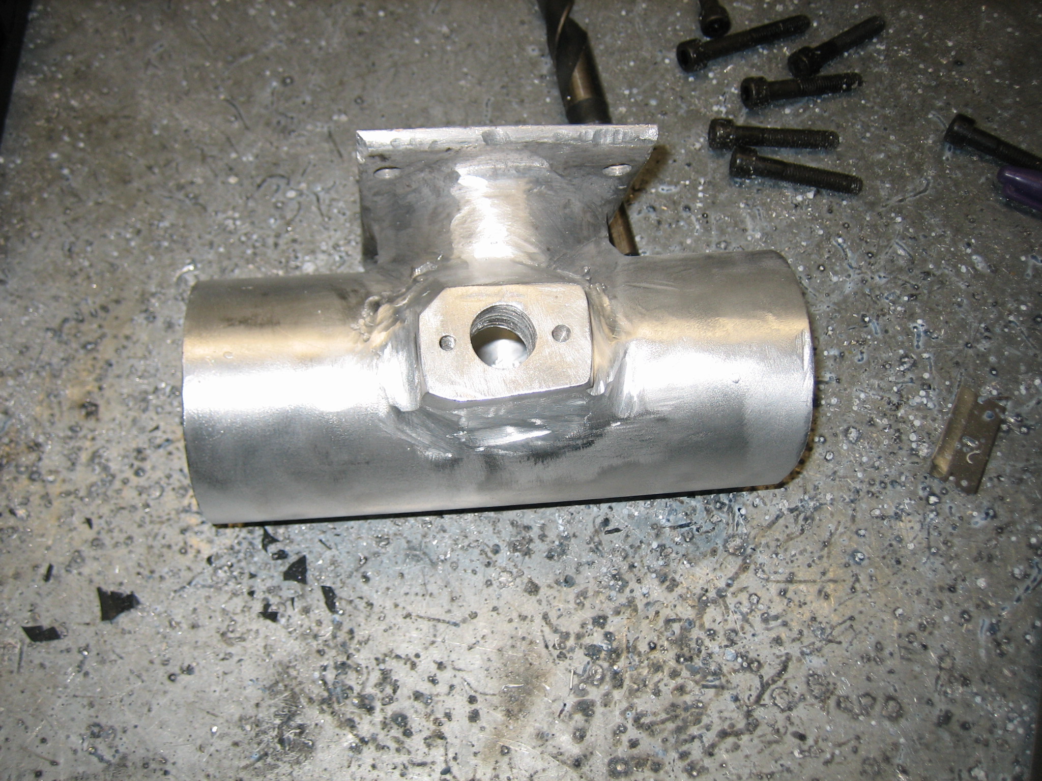

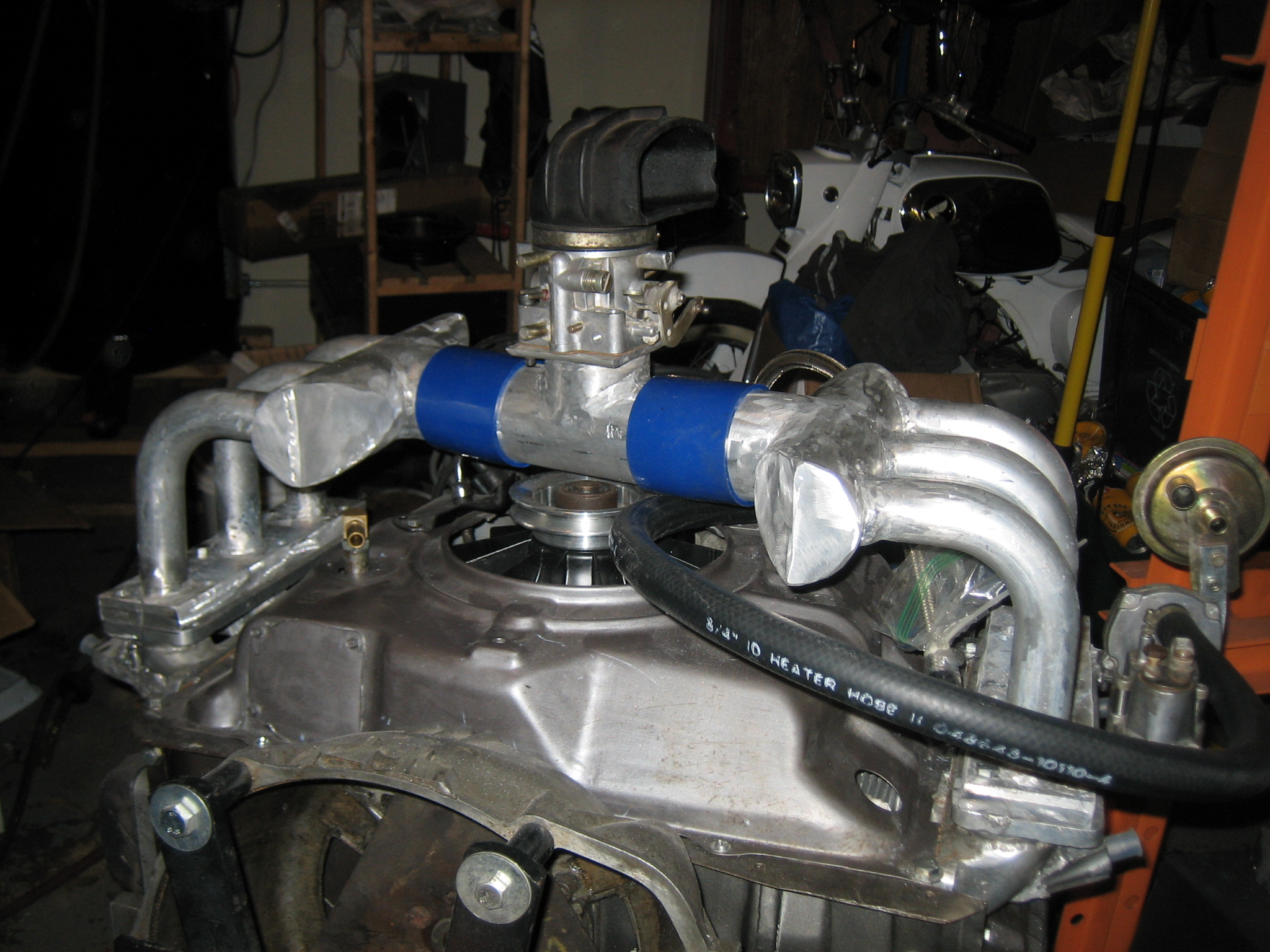

Good progress today. Made up the tube by hand bending and beating the hell out of some 16g steel. That was fun. I will finish it when I know how long I need it to be.
Here is an idea of the total height of the TB and stuff. I think this will fit just fine (IMG:style_emoticons/default/smile.gif)
Here is the center section with the bung I made and welded in for the cold start valve and aux air tap.

So, I finished up some welding on the setup, then leak checked to find out some of my welds suck (IMG:style_emoticons/default/dry.gif) Its my first time. What really sucks is that I am OUT of wire. So, I have to wait until tomorrow.
Meanwhile, I have the transmission and diff all reassembled and ready to mate up to the engine, I have the remove-install cart out and need to air up the tires, and I am making up the very simple wire harness.
I had to get inventive today, too. The air lines are 3/4", 5/8" and 1/2". The 3/4 and 5/8 are connected directly to the plenum where they will experience maximum vac. I could not find any large vac hose locally and quickly, and the OE stuff is actually welded aluminum tubing with special ends that would not fit my setup. So, I bought some throttle pedal return springs in a package for $2.49, took the one about the right dia and stretched it out. I cut it to length and slid it into the hose. No way that they will collapse now (IMG:style_emoticons/default/smile.gif)

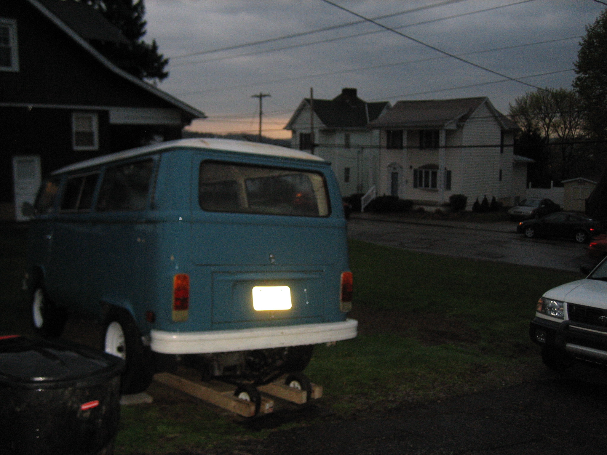

Its under the bus......then it started to rain (IMG:style_emoticons/default/hissyfit.gif)
jsayre914
post Apr 1 2012, 05:14 PM
Post #1196
Speed Up !!!
Posts: 3,210
Joined: 10-February 08
From: Timonium MD 21093
Member No.: 8,696
QUOTE(Dr Evil @ Apr 1 2012, 07:11 PM) *
Do I get to drive it at Hershey?
(IMG:style_emoticons/default/rolleyes.gif)
Dr Evil
post Apr 1 2012, 05:23 PM
Post #1197
Send me your transmission!
Posts: 23,041
Joined: 21-November 03
From: Loveland, OH 45140
Member No.: 1,372

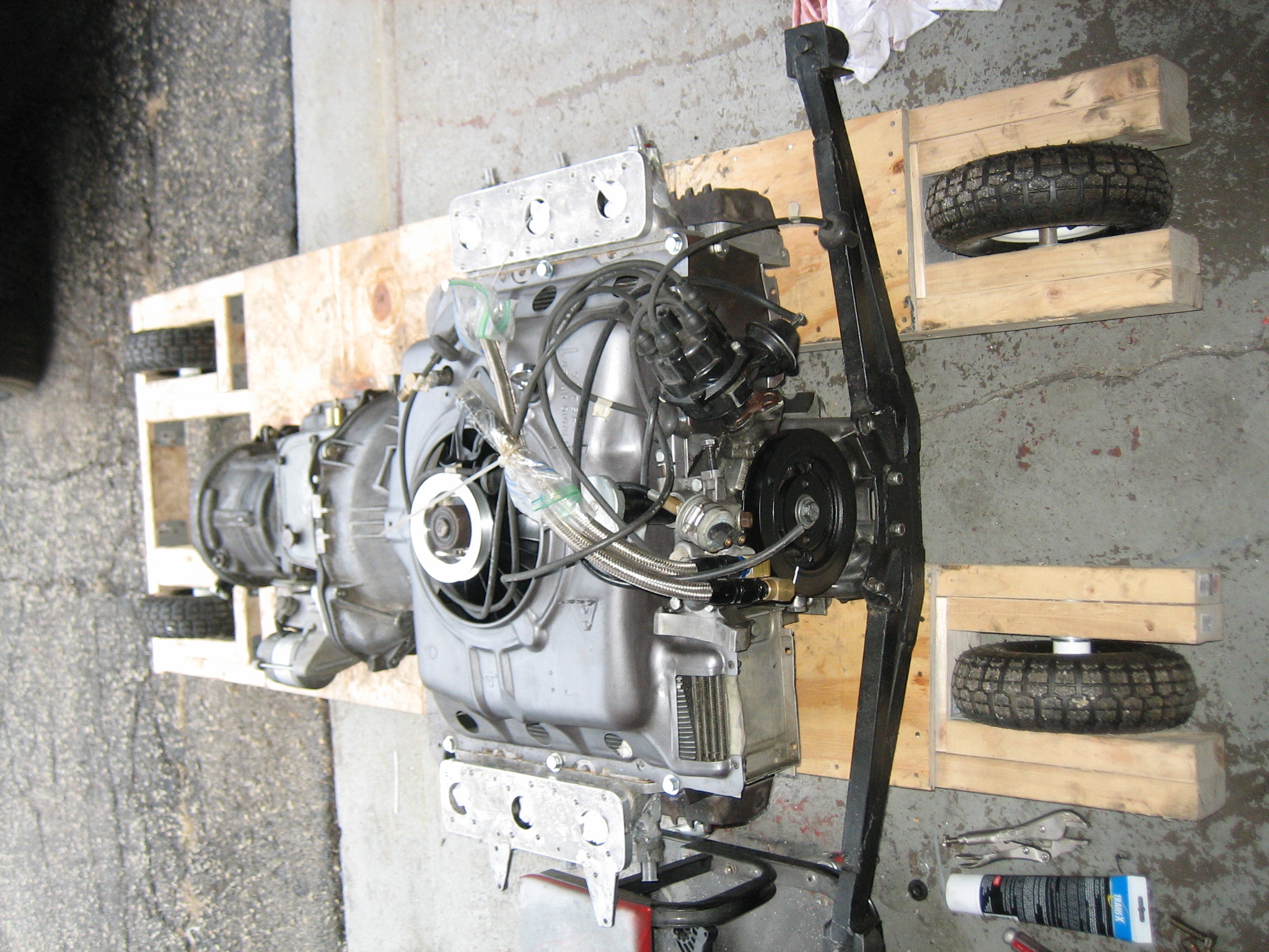

Yes, you can drive it at Hershey....if it makes it (IMG:style_emoticons/default/wink.gif)
Drive train assembled on the purpose built trolley:
Under the bus.....damn rain. It looks like it may stop (IMG:style_emoticons/default/dry.gif)
