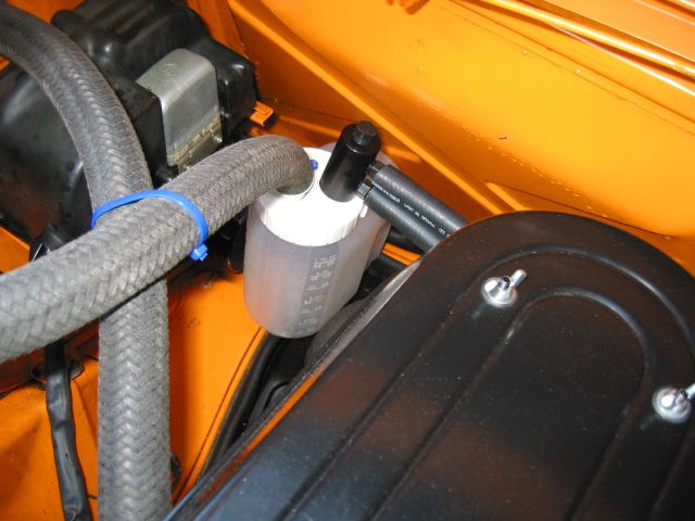

Here's mine. I think I made it from a RubberMaid...

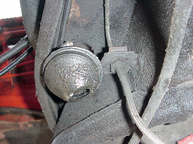

I'm curious. I don't know which line you guys are all sending off to a catch can. My /6 has a line from the top of the tank that goes back to the top of the motor. Are you taking that line off and running it to the catch can? Or is it that vent that I have under the tank that has some stupid filter off of it that has a drain hole in the bottom and leaks oil all over the bottom of my motor? I'll get pics.

Second line that comes off the oil filler Mikey.. It pukes oil everywhere after 20-30 minutes of hard driving. Most people put a small K+N on the filler line. It doesnt stop the oil vapor from covering the engine.
Your car has a line that runs to the bottom of the air cleaner.
B

You mean this one? I don't have any line going to my air filter. I have indiviual K&N's.

Yeah, that's the one that comes off of the filler neck.
I'll have to do something with that as well. I don't want any more oil on the bottom of this thing when it goes back together. I HATE that.

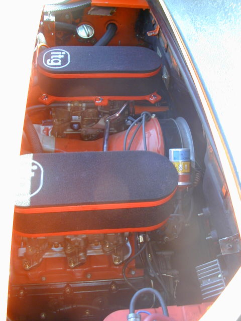

[QUOTE]I just got some ITG filters and a purty little puke bottle w/ breather.[QUOTE]
Hi Chris,
Got a picture of the ITG filters?

Yep.. Mikey.. that is supposed to go to the bottom of the factory6 air cleaner. If you have the Weber splash shields... you wont have a place to put it.. and you will have to build/buy a splash can.
ITG:
Rusty.. I cant find a pic of race engine we have.. We run ITG also.
B

I looked at a couple-3 stock 6ers over the years prior to doing my conversion. All of them had oil all over the engine compartment. All had a breather/filter mounted on the tank filler/vent .
Each had been modified rather than have the hoses running to the carb air filter.
When I did mine, I didn't want oil in the engine room or have it go into the carbs....thus the catch can.
During normal street driving, the tank stays dry. When I started seriously autocrossing, it began to pumping out a fair amount of oil.....as much as 6-8 oz per event. High rpms and tank slosh, I figure.
As an engine ages overpressure in the crankcase increases.....it's gotta go somewhere.

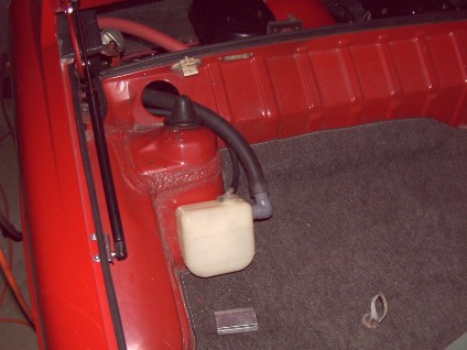

I'm lazy. I have a long hose dumping into the rear trunk of the 3.0 914/6. I would rathed clean up the oil vapor mess in the trunk (without carpet) than clean the engine. I clean it before every road course event and it is fine. Not much pukeing going on with the hose from the filler being 3 feet long.

Mikey, when I get home, I'll snap some pictures for you of the stock /6 air cleaner underside.

QUOTE(Lawrence @ Apr 19 2003, 09:20 AM)
Now I do...(crappy pic though, it's very bright out today).
