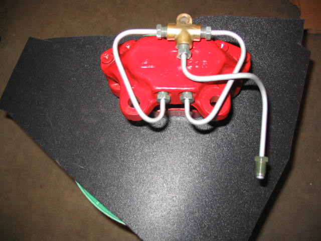

I've replaced all the brake lines on several cars and have the snap-on single and double flare kit. I can't do the bubble flare with my kit.
Bubble flare is on the right.
