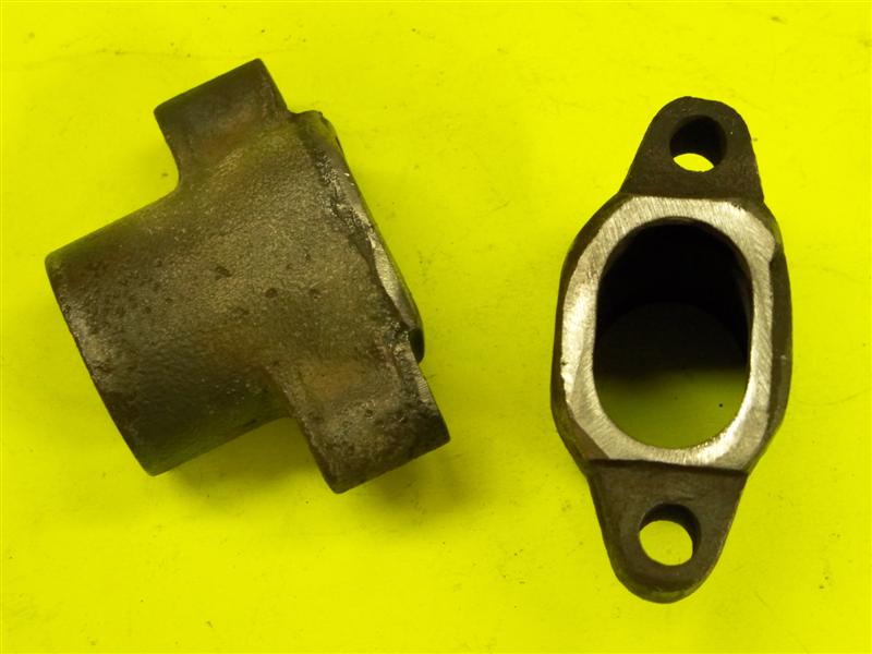

If not, borrow an exhaust stub pipe, bolt it down to the other stud and rung a drill through the side that is broken to start drilling it out.
If you use bushings around the bit to keep it centered...and youa re very carefull, you can get the job done.
Remember the hole has a bottom to it and you dont want to go to far or you will blow a hole in the head...
I have done more than a few on my back with a hand drill...just take your time, use a jig if you can...even a piece of aluminum or steel with the right size hole it it will work to help you keep it straight.

This can help in the extream case where drilling it out is necessary
