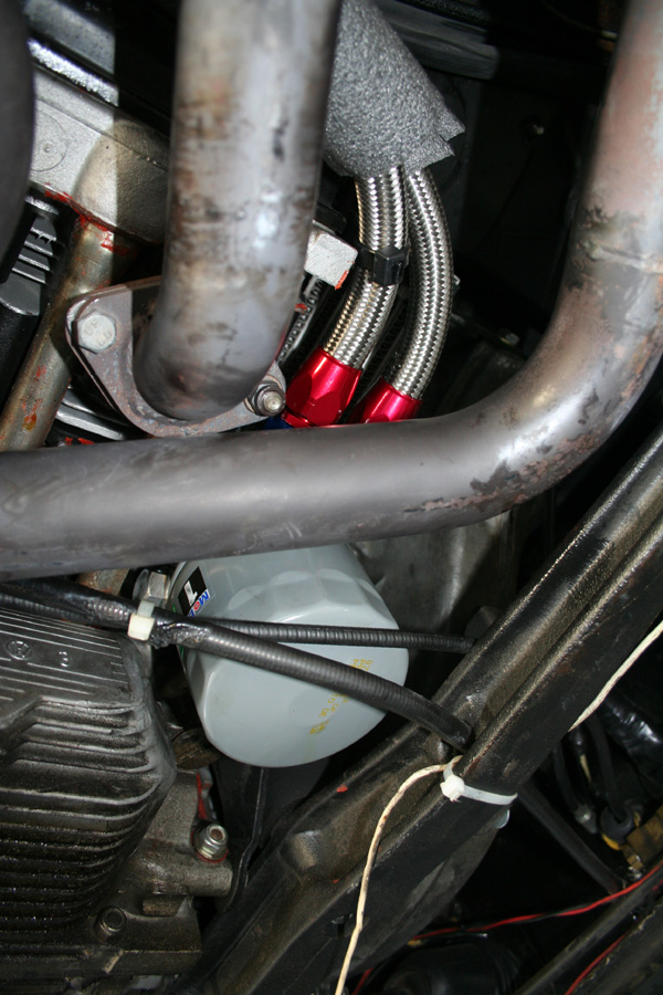

I have a sandwich adapter with thermostat on mine. The oil filter fits fine. The filter in the picture is a Mobil 1 M1-109. A Bosch 3402 also fit fine.

QUOTE(Elliot Cannon @ May 28 2012, 03:12 PM) *
Nice looking set up. Which sandwich adaptor is that just curious?
