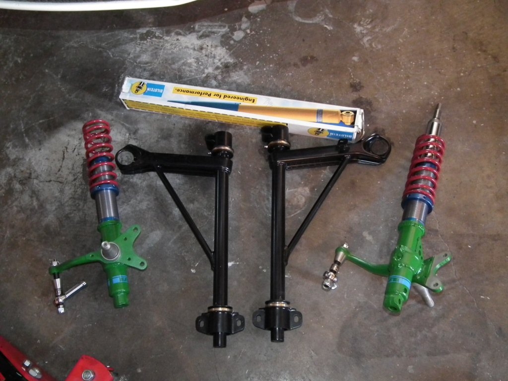

Just like the thread says:

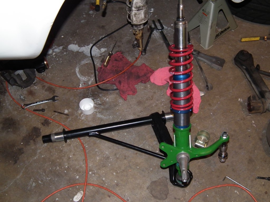

I am putting this in:
(This has been posted in the Elephant racing poly bronze thread from the other day.)

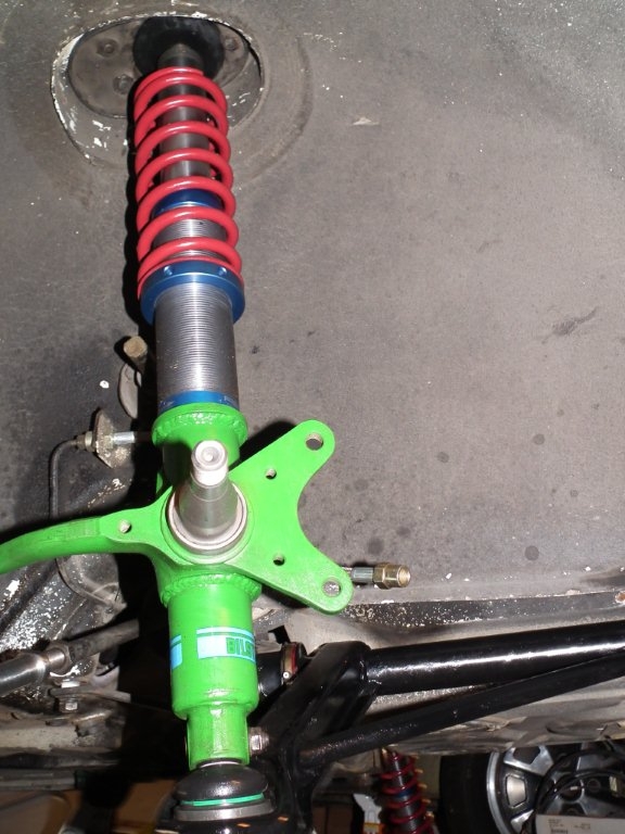

Here's the driver side prepped and waiting to install.
Here's the passenger side installed.
GPR supplied the parts and did the setup for me. It has around 1 degree of negative camber as I am running Hoosier A6s. Bump steer kit also installed.
I also have their front sway bar, and will be installing that next.
Heh, I can sure tell I don't do this for a living. It took me a couple of hours to install and I still may take it apart again. (IMG:style_emoticons/default/smile.gif)

I love the tuneability factor. Does the shock tower have or get any reinforcement?

From what I have come to understand, for Auto cross it does not need to. (I did ask the question also. )

Very cool. I think it may be a good idea to strengthen the shock towers. Even if just for piece of mine.

I am using 200lb springs for the initial setup, and am quite sure that will change. It's going to be interesting to see how the car handles afterward. This is a street/track car. It spends most of it's time autocrossing, but I do sometimes drive it around. And this leads into the 935 a-arms. I looked at those, and asked about them also. I was told that they would be too fragile in street use. Too bad.
The advantages are better variety of springs, larger range of height adjustment, and as someone said, slightly eaiser to change springs. I would be curious to hear from someone who has tracked this setup. (IMG:style_emoticons/default/smile.gif)
Costwise, I try not too look at the recipts too much. (IMG:style_emoticons/default/smile.gif) I had GPR do all the welding that needed to be done, and the installation of the ER Polybronze. I am a hobbiest-mechanic and didn't want to mess that part up. So:

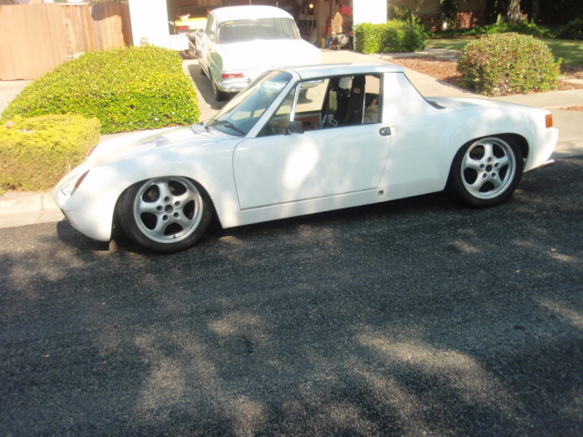

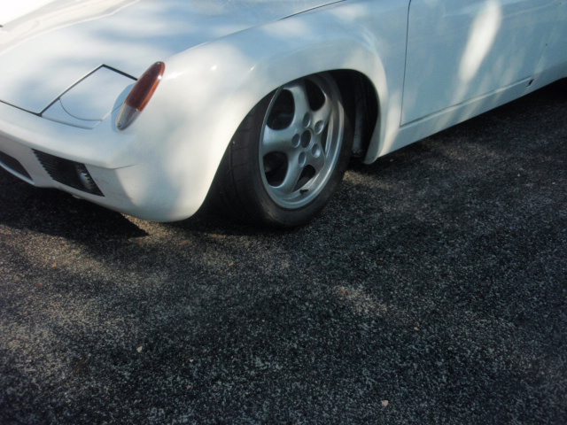

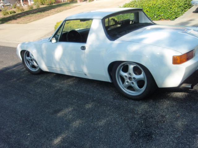

Update.
All installed and drove it. Ran into to plenty of snafus, but finally did get it done. Has the GPR 21 mm front sway bar also.
1. Is this too low? about 4.5 inches from the jack point, and 5 inches in the rear. (Not corner balanced yet.)
2. I am getting a funny noise in a tight turn, something is rubbing. Need to troubleshoot that still.
Ok. Here's some pics.
