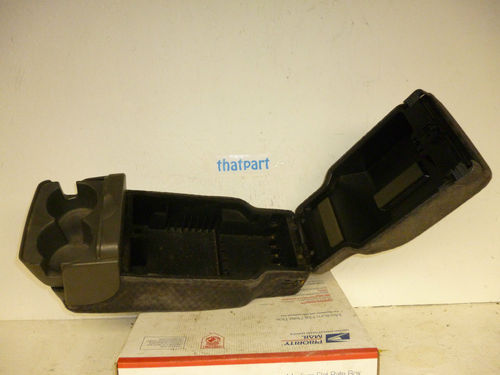

I have been searching ebay for used armrests / center consoles with built in or pop out cup holders. I think that the pop out type might get too close to my shifting area (although I do have a short shifter installed.)
This pic is one from a Pontiac Bonneville. Looks kind-of fat. I know that dimensions are key here. i.e. the cup holders conflicting with the heater control switch throw and the shift pattern.

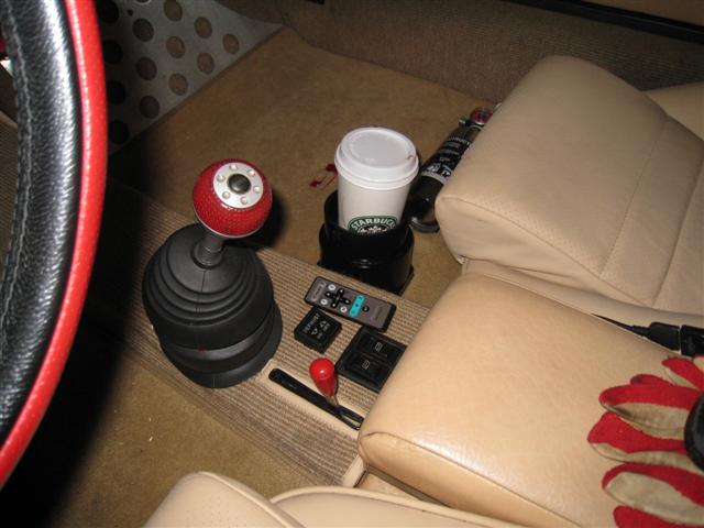

Check my thread from back in 2006. Quick and easy cup holder in the ashtray location.
My Cup Holder Thread

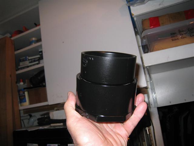

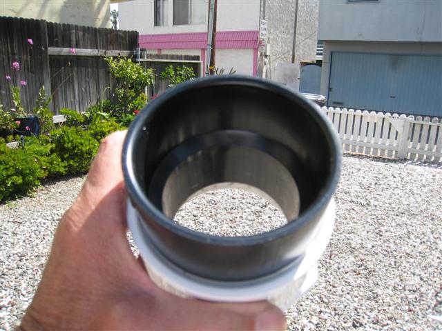

I fabed a simple cup holder from two PVC plubling parts. The base is pretty heavy and hasn't tiped over yet.
I love the tapered / pvc adapter. How ingenious to see that for what it could be whilst strolling through the plumbing section. (IMG:style_emoticons/default/smile.gif)

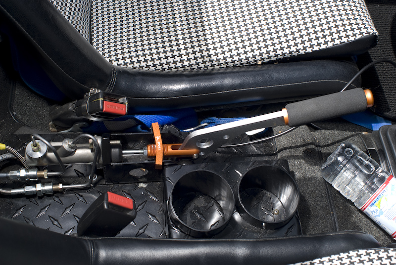

I made mine from fiberglass pipe and diamond plate aluminum. Fiberglass pipe from petroleum wholesaler, free sample. Very thin wall and perfect size.

QUOTE(kg6dxn @ Jun 17 2012, 09:34 AM) *
Good God man - speaking of petroleum wholesalers, that hydraulic e-brake rig looks like something built for use on an oil derrick! What the hell does your coffee mug look like?!? (IMG:style_emoticons/default/laugh.gif)
(Srsly, that e-brake looks sweet! I'll have to go check the previous Sasquatch build threads and see what you did...)

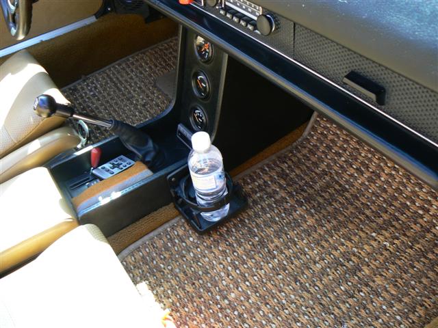

Well if I can't get an arm rest out of it I think that the two finalists for me are:
drum roll please.
The VW Thing / ash tray unit.
Although I am afraid that it might interfere with the heater controls.
HAS ANYONE USED THIS SET UP?
LOOKS LIKE IT MAKES IT HARD TO MANIPULATE THE HEATER CONTROLS.
http://www.jbugs.com/category/vw-thing-drinkholders.html

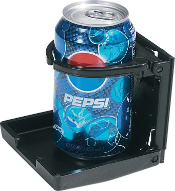

If I have room between my extinguisher (mounted to the side of my center console) and the passengers seat doesn't slide forward into it.
http://www.cabelas.com/product/Collapsible...;Ntt=cup+holder

QUOTE(pnewman @ Jun 17 2012, 11:26 AM) *
Well if I can't get an armres out of it I think that the two finalists for me are:
drum roll please.
This looks like a good solution. Looks high enough not to get in the way.

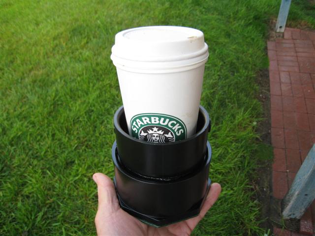

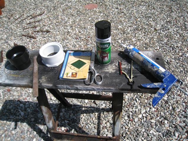

I stole the pvc pipe idea but used a 4 in by 3 in reducer with a 4 in cap in the bottom, then put some industrial Velcro on the bottom of the cap. 5 bucks to buy, 5 mins to make and it works awesome.
I highly recommend it at least as an interim solution.
I agree.
Until I can put together something more permenant.
I think it's a winner.

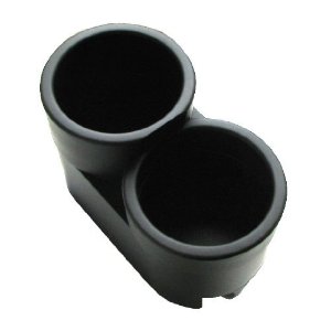

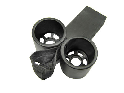

Check out the BMW cup holder which fits over the center console edge:
http://www.amazon.com/BMW-Genuine-Dual-Hol...g=5336432695-20
Model E32.

QUOTE(PBC914 @ Jun 18 2012, 06:48 AM) *
Model E32.
I wonder how stable it is.
Here is a pick of it.
