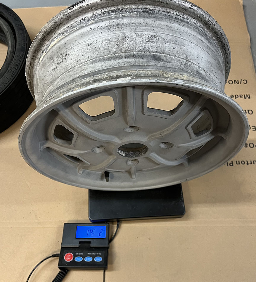

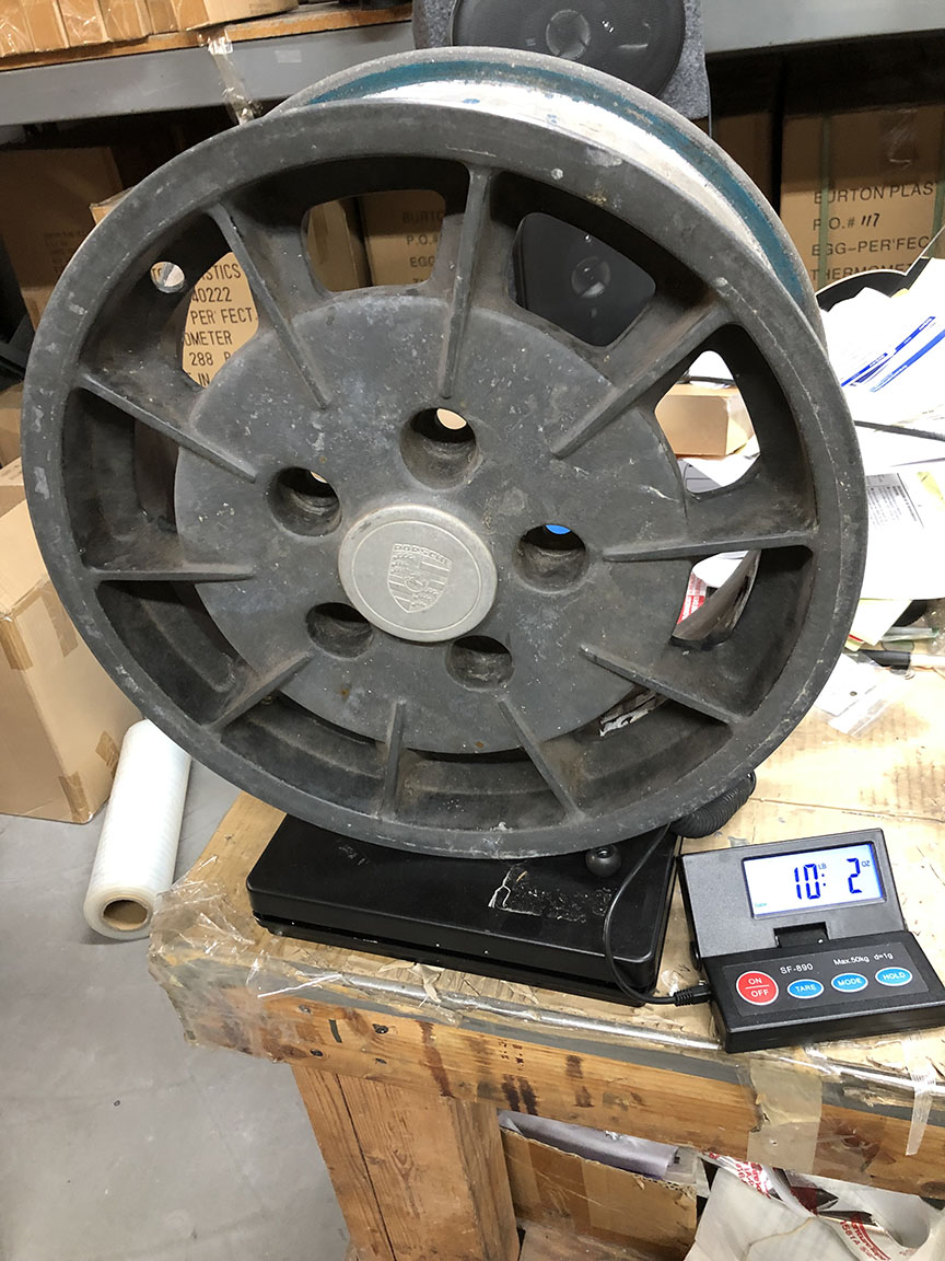

I saw this old posting and I have pictures and weights of a couple of different wheels for the 914.
The Mahle 5 lug Gasburner is 10lb 2 oz ---
The Pedrini 4 lug is 14lb. 2 oz
Just so you know
Best Bob B

Pedrini? (IMG:style_emoticons/default/smile.gif)

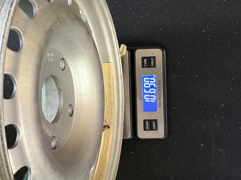

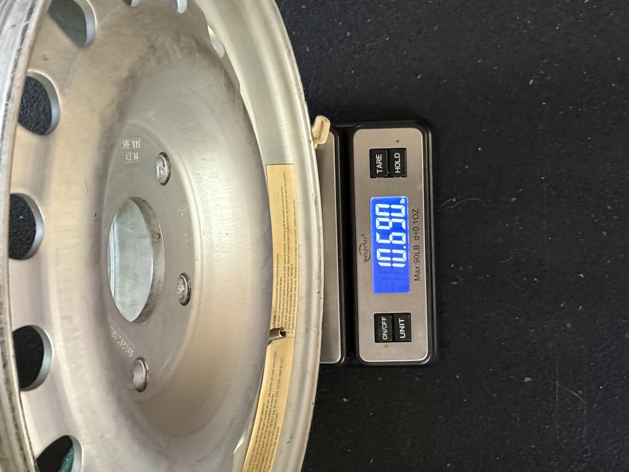

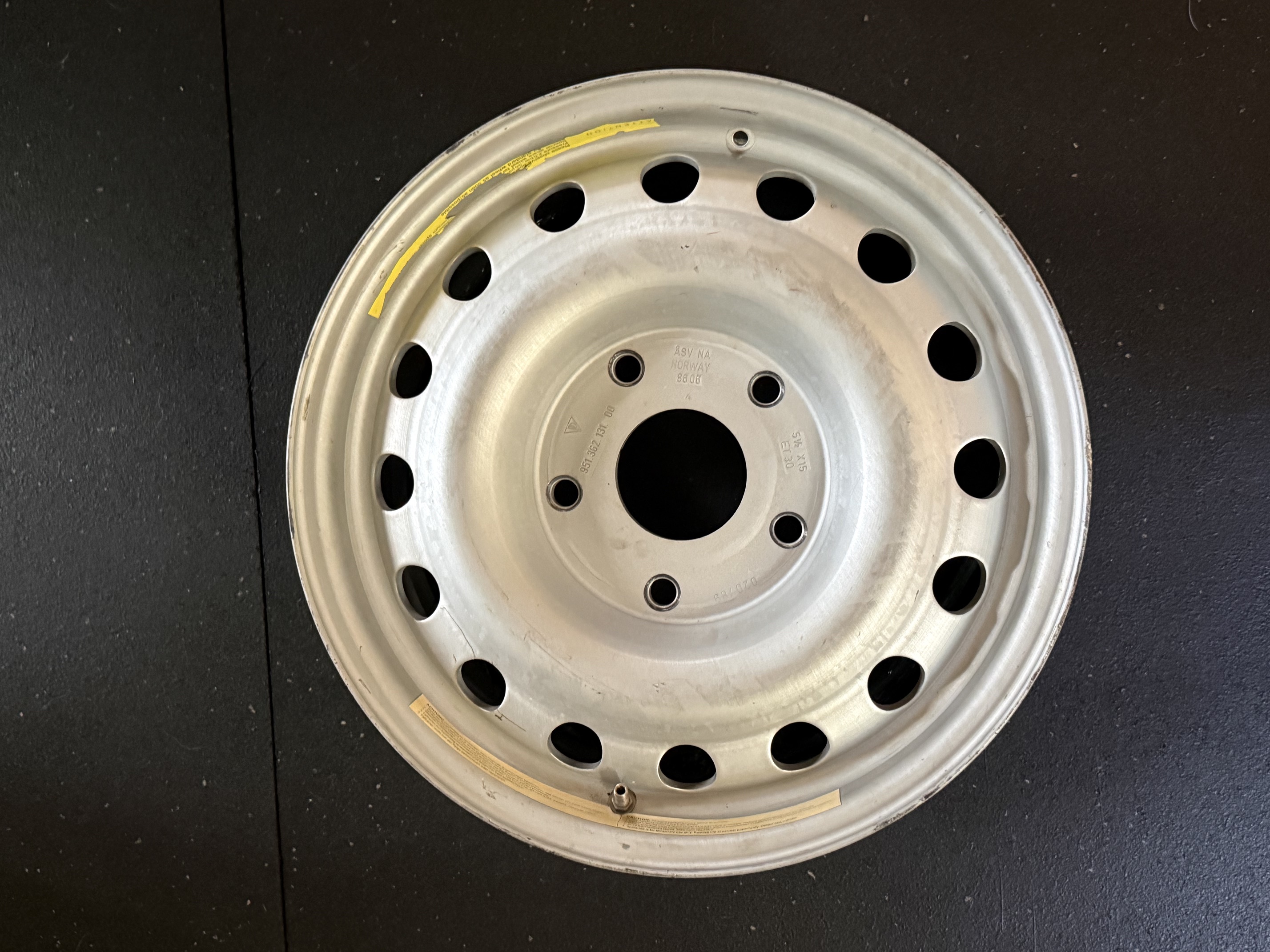

951 spare. Same 5 1/2x15 as four lug Fuchs and also forged but 2 1/2lbs lighter.
