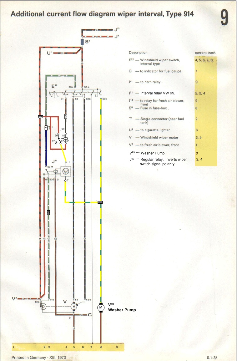

Valy
post Jul 31 2012, 03:58 PM
Posts: 1,677
Joined: 6-April 10
From: Sunnyvale, CA
Member No.: 11,573
This is what I have on my car.
I like it since it has a programmable interval wiper delay with no additional switches or buttons added in the system. It also runs my electric water pump.
It's a win-win-win (IMG:style_emoticons/default/smile.gif)

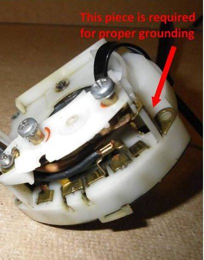

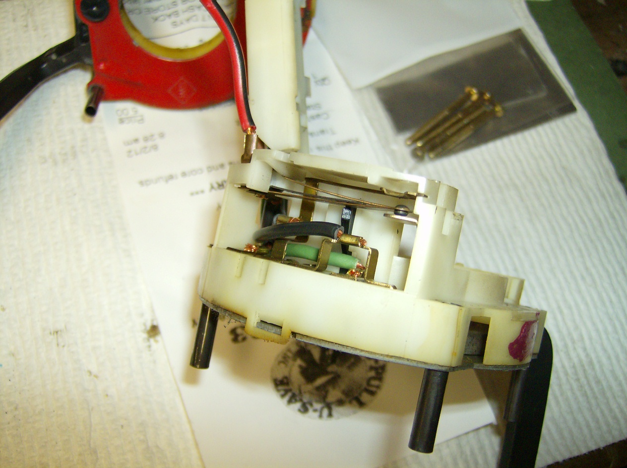

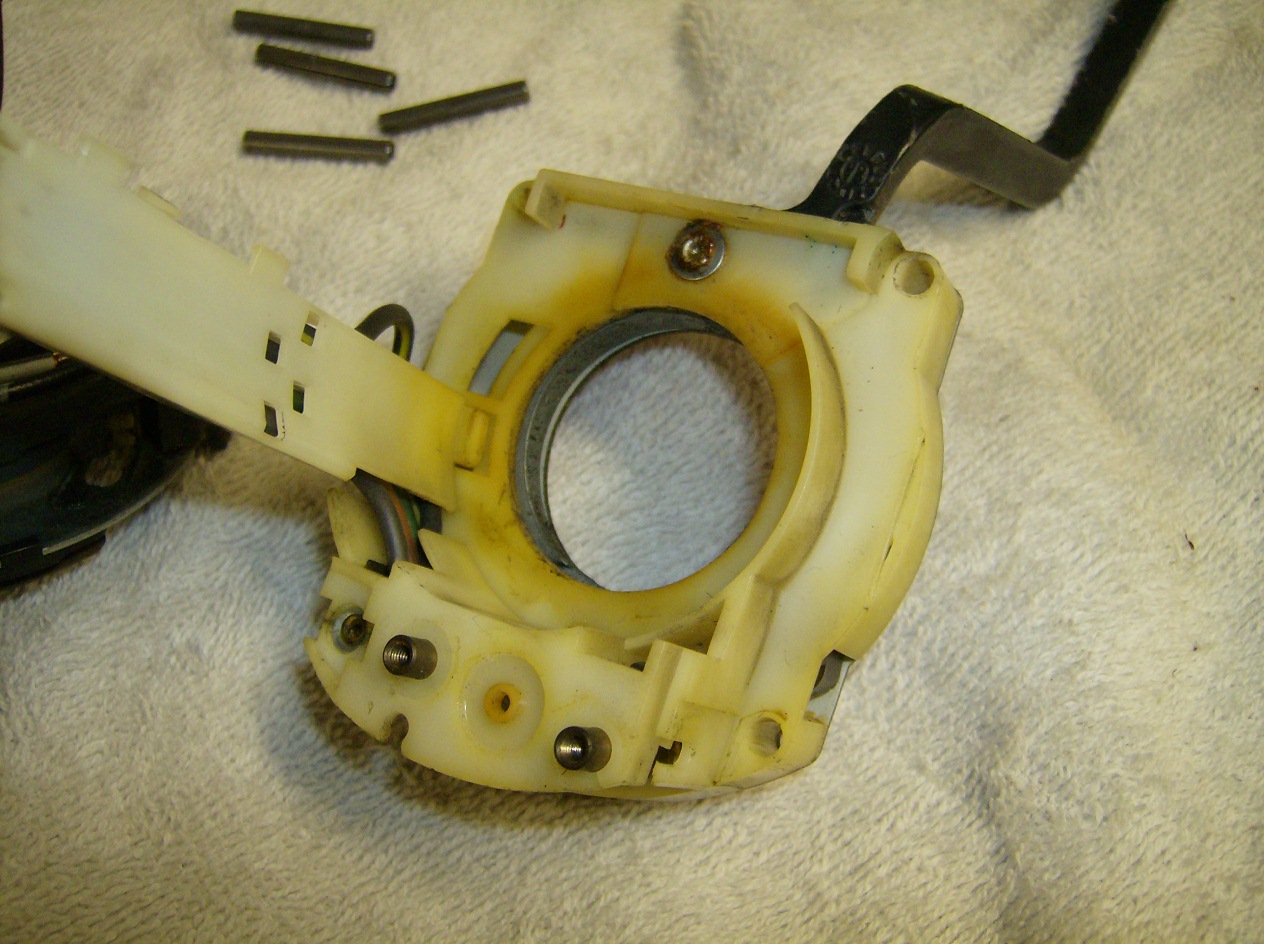

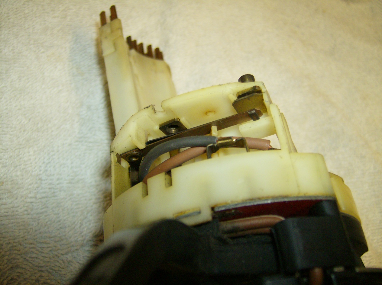

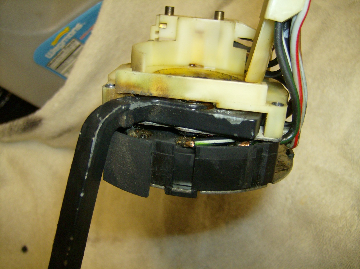

I needed pictures of a good known switch for what you'll see below. Gahhhhh!
Notice something missing in the pictures below?
Cupomeat
post Jul 31 2012, 07:23 PM
missing my NY 914 in VA
Posts: 1,349
Joined: 26-November 07
From: Oakton VA
Member No.: 8,376
Its like flying in clouds, You can't see the ground...
Damn, I suppose you could fabricate it.
markb
post Jul 31 2012, 07:27 PM
914less :(
Posts: 5,450
Joined: 22-January 03
From: Nipomo, CA
Member No.: 180
I wish you would have said something a couple of days ago, I just cleaned out a box of old broken ones & tossed them all..... (IMG:style_emoticons/default/dry.gif)
tomeric914
post Jul 31 2012, 08:24 PM
One Lap of America in a 914!
Posts: 1,321
Joined: 25-May 08
From: Syracuse, NY
Member No.: 9,101
QUOTE(Cupomeat @ Jul 31 2012, 09:23 PM) *
Thought about it.
QUOTE(markb @ Jul 31 2012, 09:27 PM) *
Me too! Isn't that always the way it happens?
I know I've seen this part somewhere in the garage but was unsuccessful at finding the needle in a haystack. If anyone in the Syracuse area has a broken wiper switch that they could part with that tab, please let me know! Same switch in '74 and later Bug, Thing, Porsche 924, etc.

mrbubblehead
post Aug 1 2012, 06:55 PM
Twodollardoug
Posts: 1,155
Joined: 17-December 10
From: calimesa ca.
Member No.: 12,492
how funny, i just did this mod. valy posted up the wiring diagram, i found the same one and it helped tremendously. you beat me to it valy.
i used a 5 wire wiper switch, and used a micro switch to operate the pump. the pump came out of a late model jetta.
here is a source i found for an NOS 6 wire switch if anyone is interested.
http://www.thingsforthething.com/catalog/i...63e6d4fdb244c55
and a reproduction
http://www2.cip1.com/ProductDetails.asp?Pr...C-111-953-519-G
Eric_Shea
post Aug 2 2012, 07:01 AM
PMB Performance
Posts: 19,304
Joined: 3-September 03
From: Salt Lake City, UT
Member No.: 1,110
When I was working on my switch applications, I felt something hit my shoe in the shop... Luckily I bent down and picked that piece up and somehow managed to get it back in the right spot. (IMG:style_emoticons/default/biggrin.gif)
tomeric914
post Aug 2 2012, 12:28 PM
Posts: 1,321
Joined: 25-May 08
From: Syracuse, NY
Member No.: 9,101
I know the piece dropped out on me as well, but that was at least 3 years ago and I have no idea where I put it.
So today I went back to the pick-n-pull and grabbed the wiper switch out of the 924. The bad part is that 924 switch is a 6 wire vs the 914 5 wire BUT I swapped the plastic conduits and put a terminal on wire #6 (red/black stripe)which is 12 volt out for an electric washer pump!
The other bonus is that the ground can't fall out of the 924 switch.
The other interesting thing I found was that there was a stop in the 924 switch that didn't allow it to go to the intermittent position, yet I got the intermittent relay out of the same car. Did Porsche make intermittent wipers an option, ship the relay to control the park function of the wipers on all cars and then charge for the removal of the stop?
mrbubblehead
post Aug 2 2012, 12:55 PM
Twodollardoug
Posts: 1,155
From: calimesa ca.
Member No.: 12,492
i got my 5 wire switch out of a 75 914. and the little grounding chingus couldnt fall out either. the brass piece was molded into the plastic.
