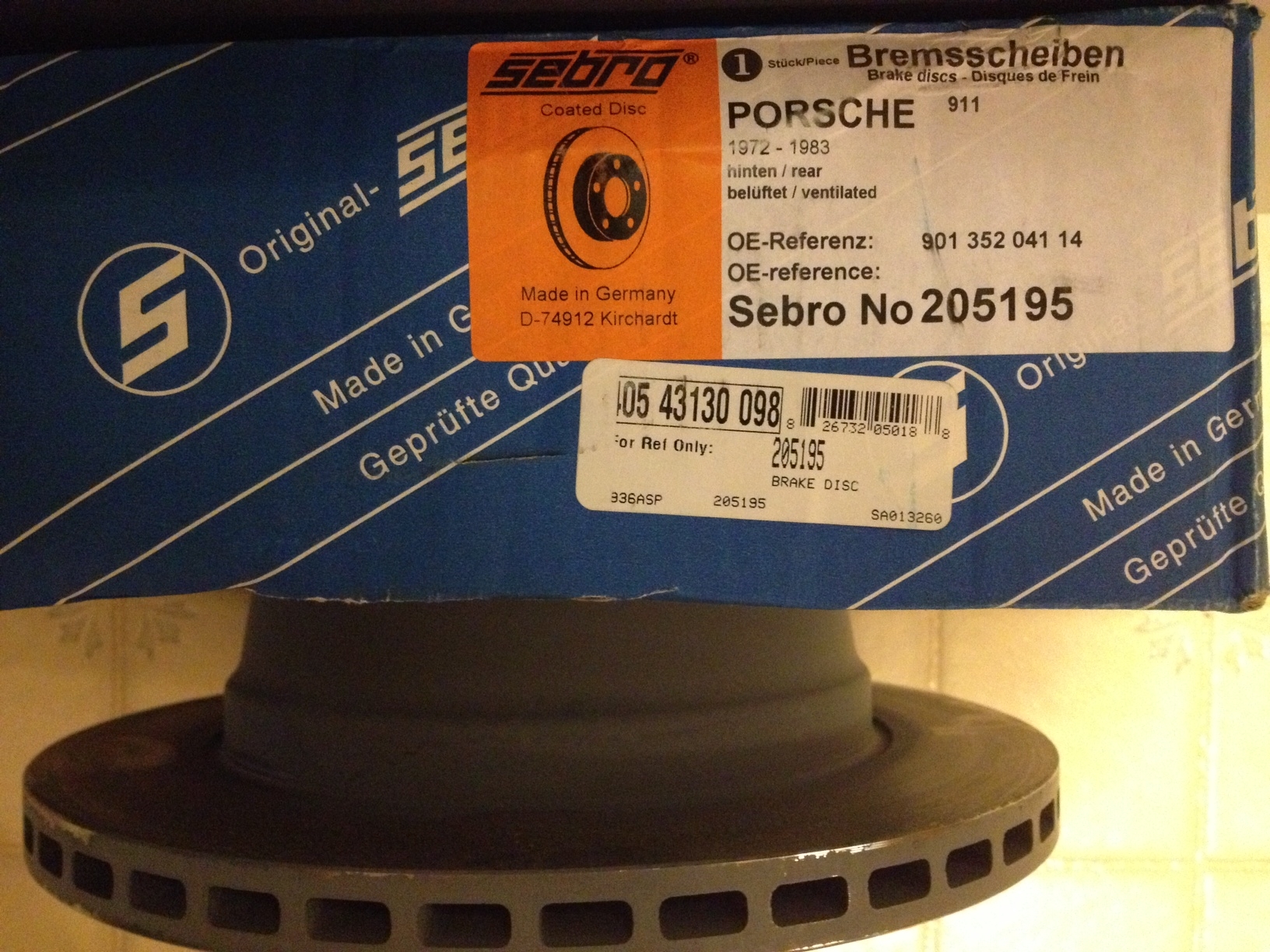

post Oct 3 2012, 06:25 AM
914-6 GT in waiting
Posts: 20,587
Joined: 19-September 09
Member No.: 10,825
914-6 GT rotor from PMB Performance

GTs have vented rotors. Two models I've seen:
1. 914-6 caliper with spacers and longer fasteners. Hence the rare as hens teeth GT calipers. I have a set for sale in the classifieds but you probably won't like the price.
2. Rally modified GTs with 911 handbrakes and handbrake assemblies that used 911 rear calipers.
Both used a custom offset GT rear rotor which is still available from Porsche for $250ish... each.
Best bet is a 911 rear rotor with mounting ear spacers or rotor spacers under the hat.

Which rotors go with the "rare as hens teeth GT calipers"? Do you have to modify anything?
1. Factory GT rotors @ $250.00 (which really isn't that bad when you consider you probably won't ever have to get another pair).
2. 911 Rear rotors with the following mod(s):
a ) 5mm spacers under the caliper ears, or
b ) 5mm spacers under the rotor hats.
