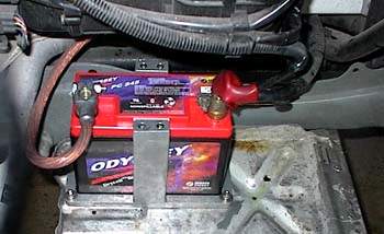

just ordered an odysee with billet hold down for $169.
battery $109
hold down $60
daliracing.com
