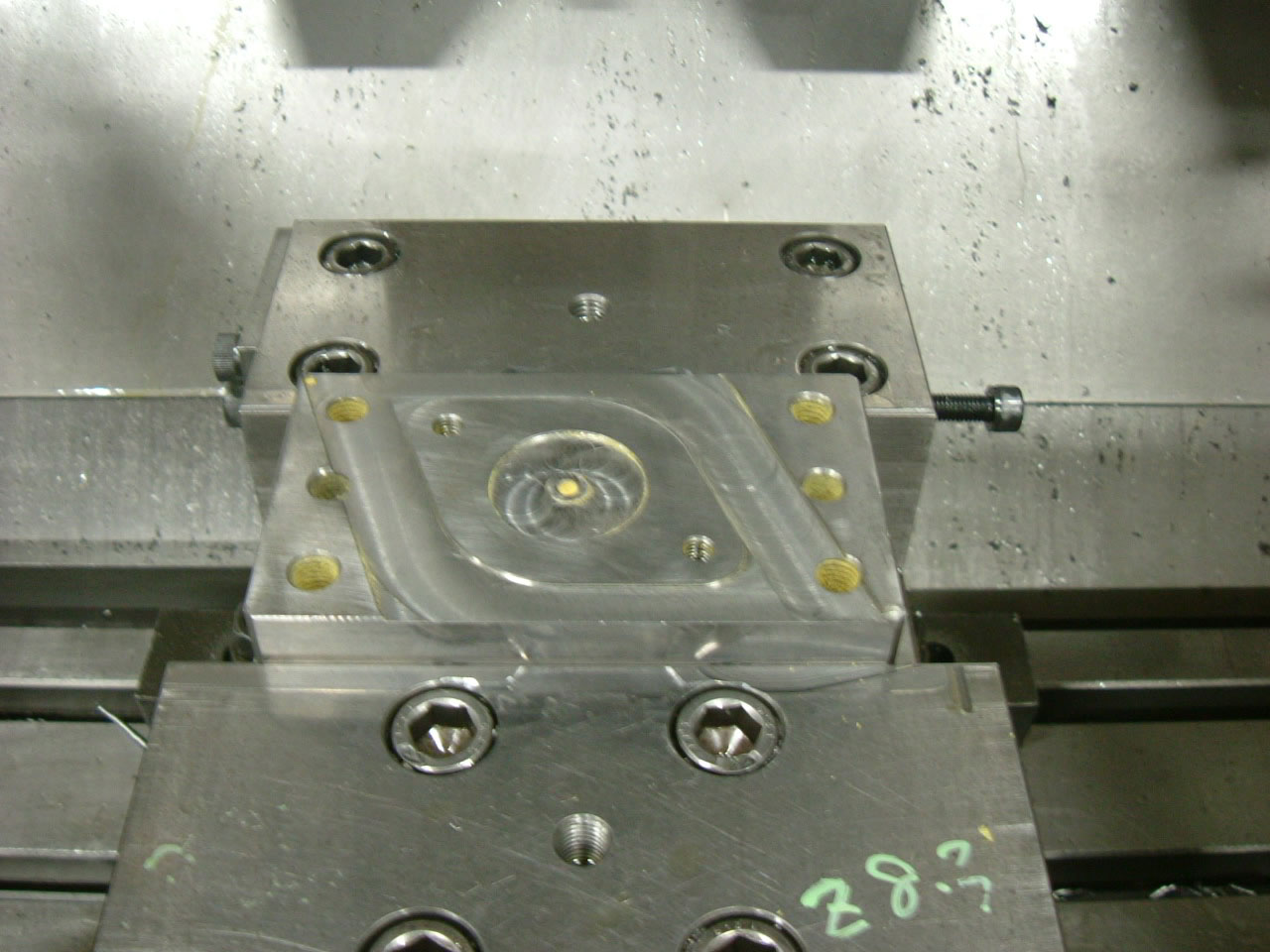

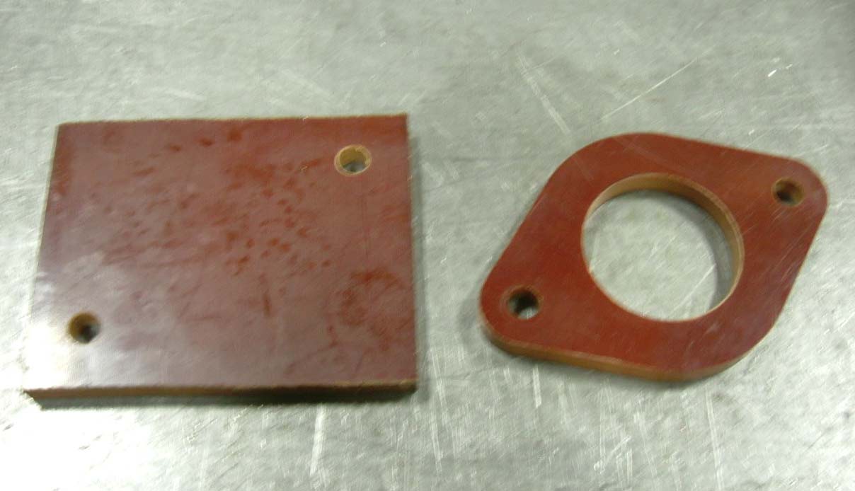

Here is the material after I roughly cut it out on the band saw. Than I made a small jig from some scrap metal to mill out the holes for the stud bolts so they are perfectly pitched to keep it positioned well.
![]() This is another jig I made for ones the holes are drilled and it fits into to give it the 2D profile. I did this on the CNC mill after work. Than I bolt it to the jig and mill away in the shape. |

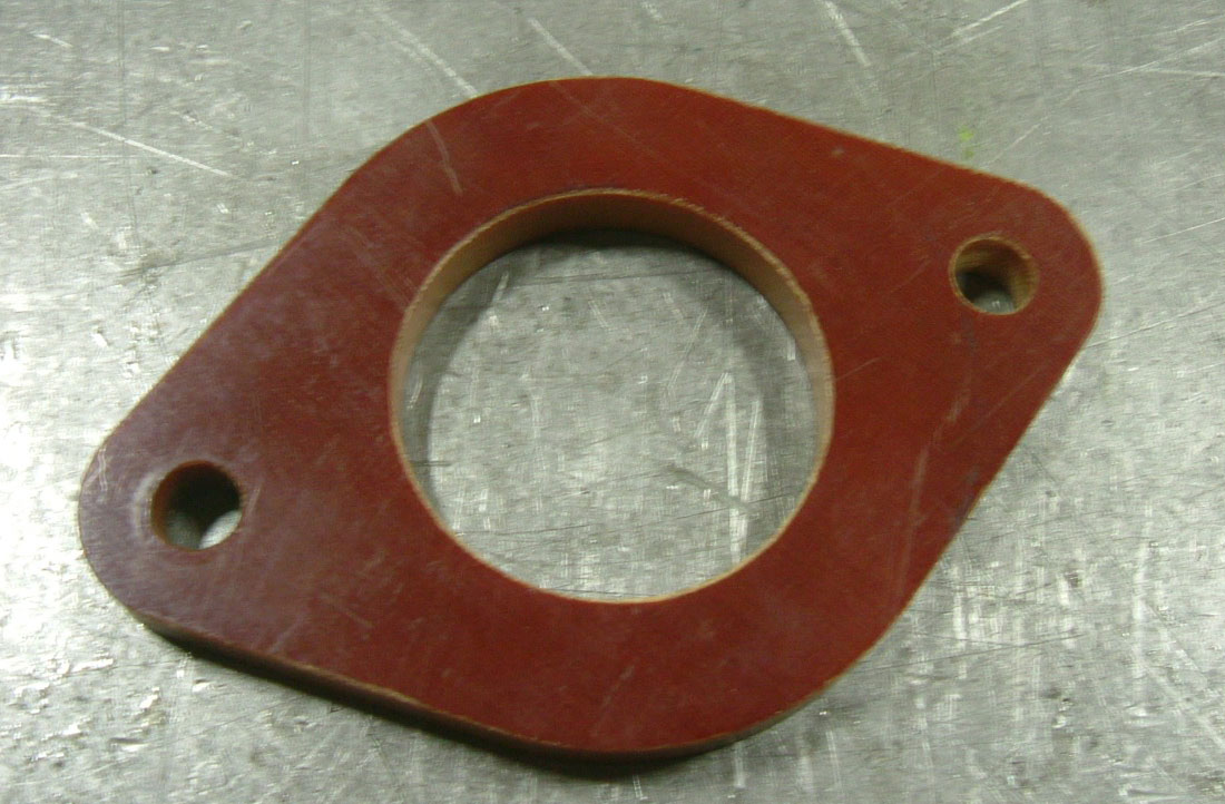

Another one but close up. Is this really bakelite or is it Phenolic? I believe they are the same material. You're right, they're the same (http://www.professionalplastics.com/BAKELITE). You couldn't machine the original bakelite, it was always molded, but now it's now made with different reinforcing materials, paper, canvas and linen, that make it machinable. Right about the Dellorto whistle, too. CB Performance sells a spacer/gasket that covers that gap and eliminates the chirps. . |

Another one but close up. Is this really bakelite or is it Phenolic? I believe they are the same material. You're right, they're the same (http://www.professionalplastics.com/BAKELITE). You couldn't machine the original bakelite, it was always molded, but now it's now made with different reinforcing materials, paper, canvas and linen, that make it machinable. Right about the Dellorto whistle, too. CB Performance sells a spacer/gasket that covers that gap and eliminates the chips. . Do you happen to know the part number for this CB performance part? I have been looking over their site and have not found anything....perhaps I am looking in the wrong area. I was thinking about going with two sets of paper gaskets and sandwhich my new bakelight spacers in between. |

Thanks for the links, checked them out and they were helpful. I also finished rebuilding my carbs today and they are almost ready to go.....new gaskets on the way. My spacers fit perfectly. I am going to cut some new stud bolts for them and do some small touches on the following weekend as I only have time to work on the car on Sunday. I can't wait to get my car on the road and drive it finally.
