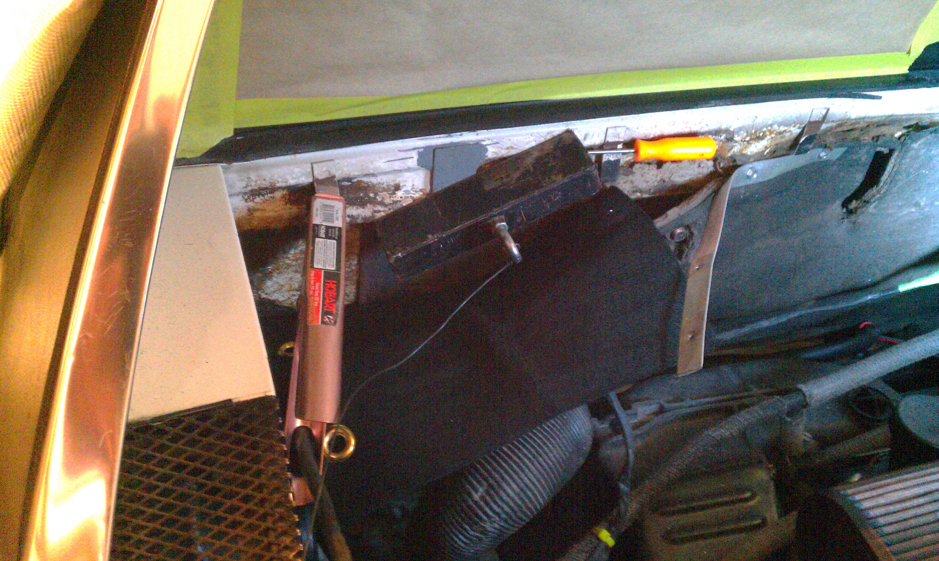

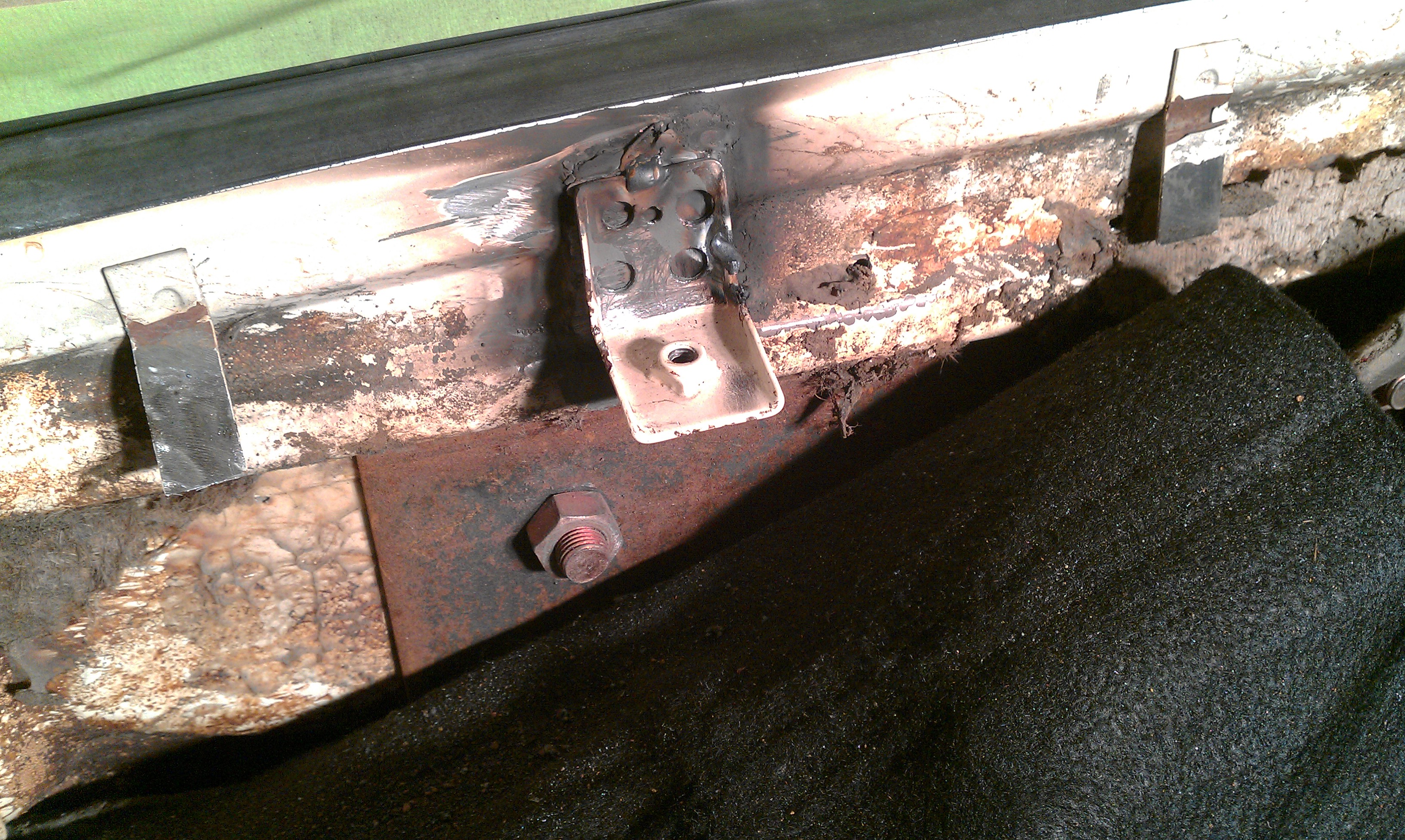

Taking a time out on my rustoration project.
Decided to tackle my problem with the engine lid hinge on my other car.
Late last summer I found the hinge was coming away from the body.
Hinge wasn't cracked. Spot welds were still intact.
The damn firewall had cracked. Right above the top spot welds. (IMG:style_emoticons/default/sad.gif) (IMG:style_emoticons/default/sad.gif)

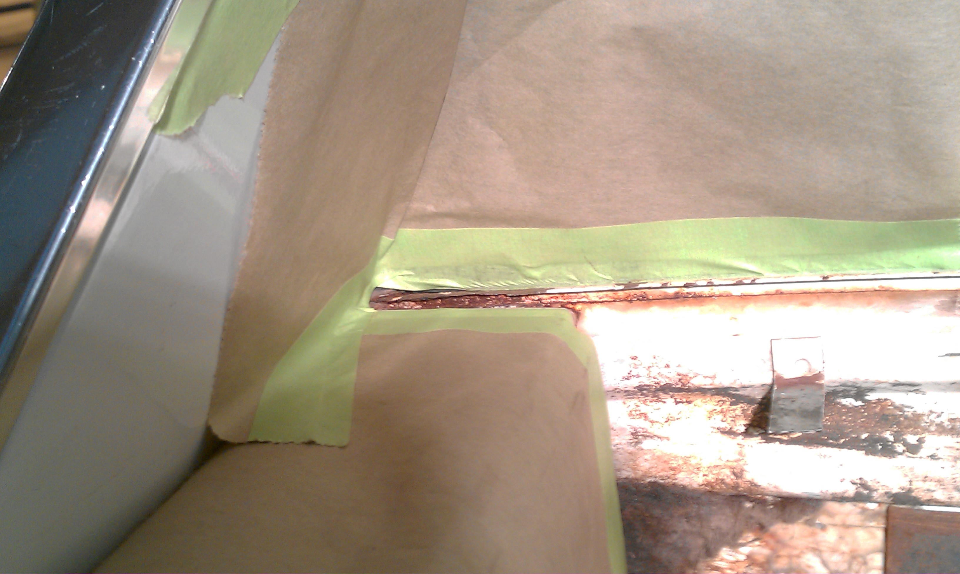

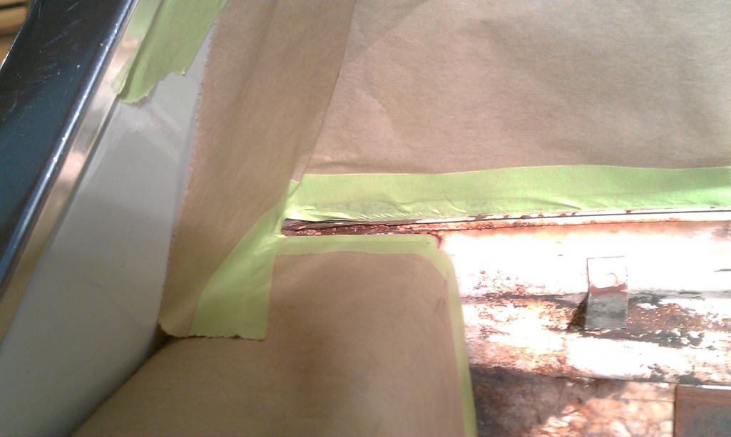

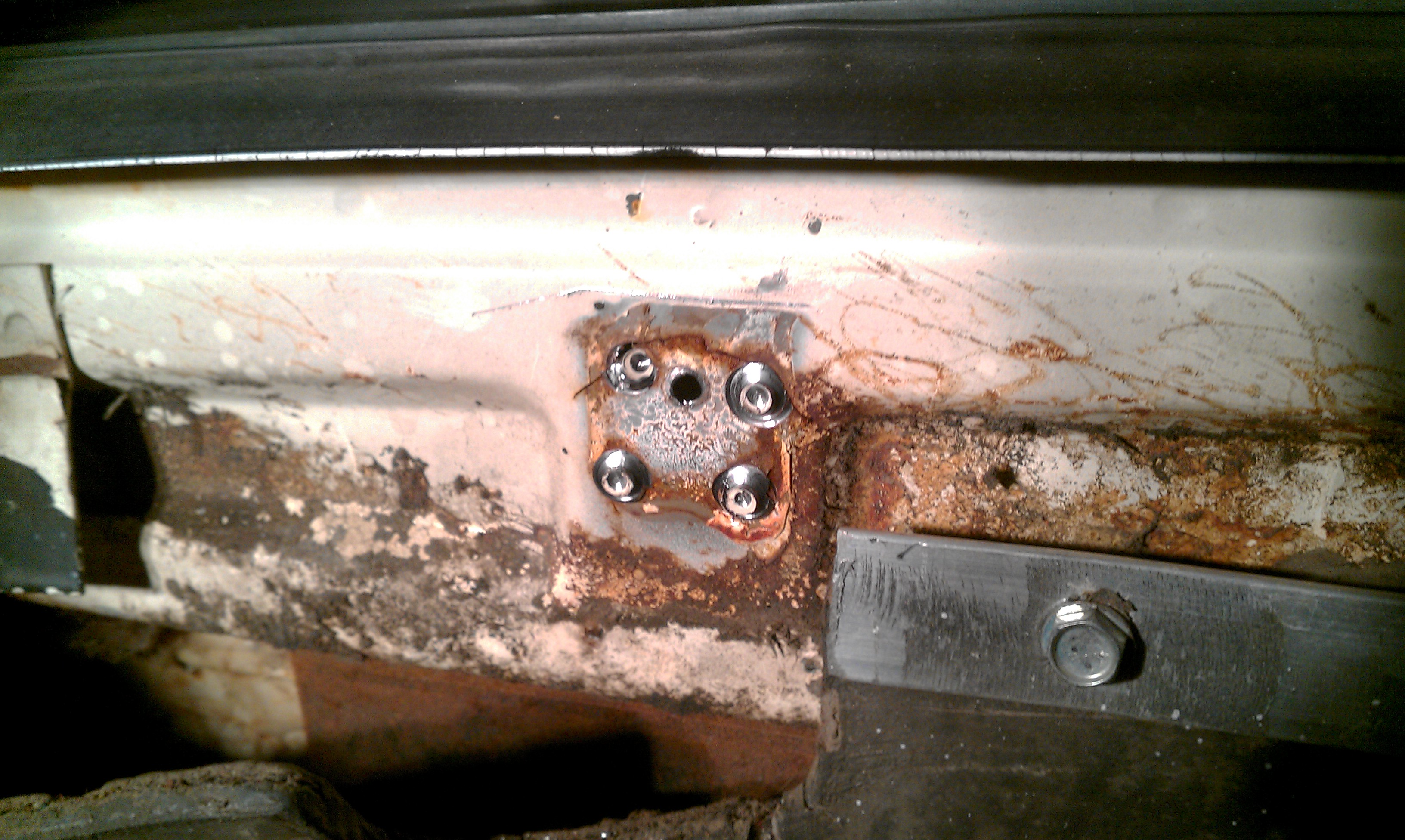

The extra hole was a feeble attempt at tightening it up last summer.
Tried a self taping screw. Didn't work
Couldn't see the crack until the hinge was taken off.
Man that is some thin metal ..................... Going to put in a patch.
Left the shop with the weld thru primer drying on the work bench.
I don't understand why the metal is so thin. I assume it has sometime to do with forming the ridges in the firewall.

I think we'll attach the patch on top to tie it all together.
No way to access to butt weld.
Might need to shorten the lid side of the hinge a smidgen to get the perfect fit. Or length the slot.

If you overlay the metal it would push the engine lid rearward, and close the gap between the trunk lid, so slotting the holes is a good idea.
That's a tough place to fix. The two layers of metal and the bends in that top section make it a challenge.

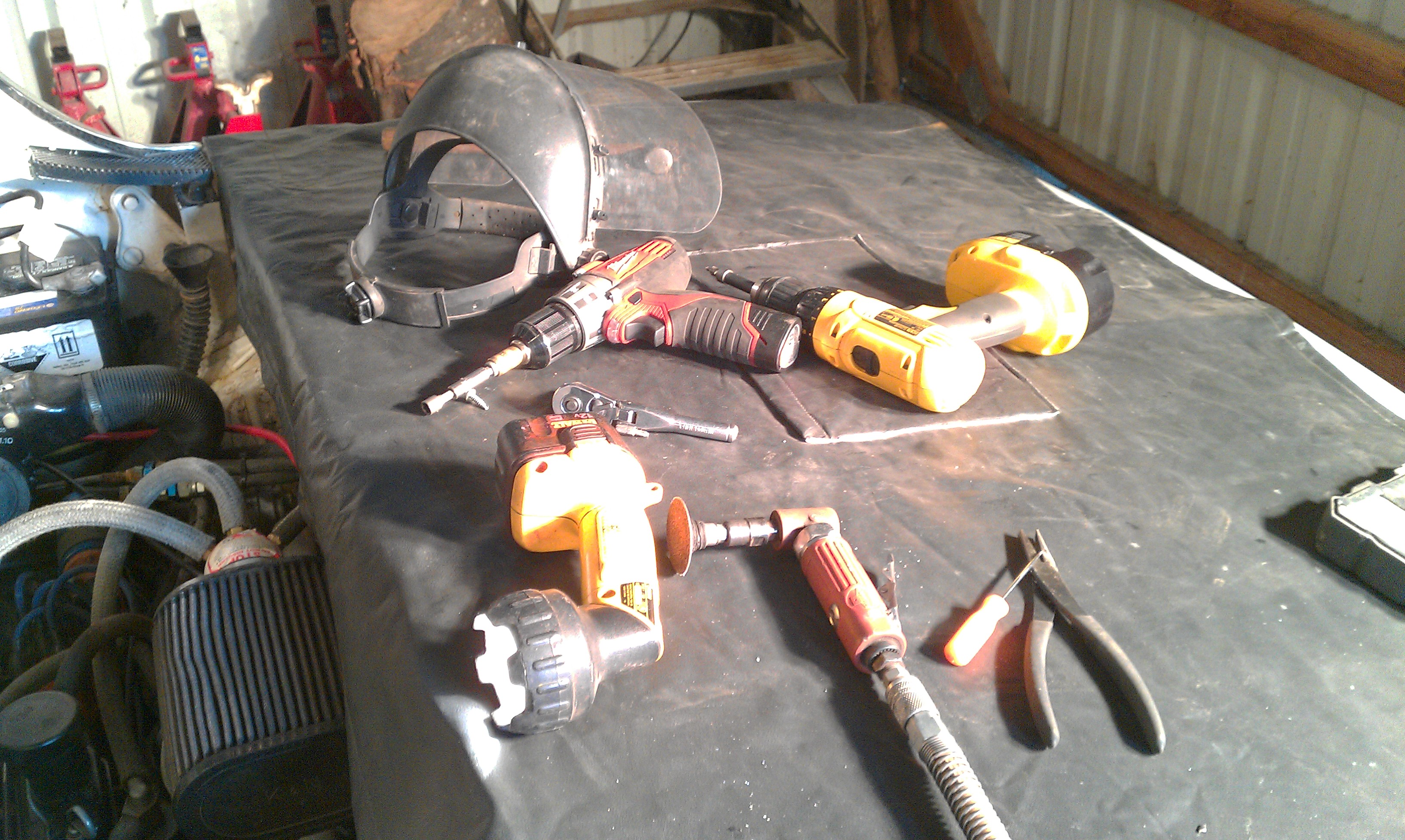

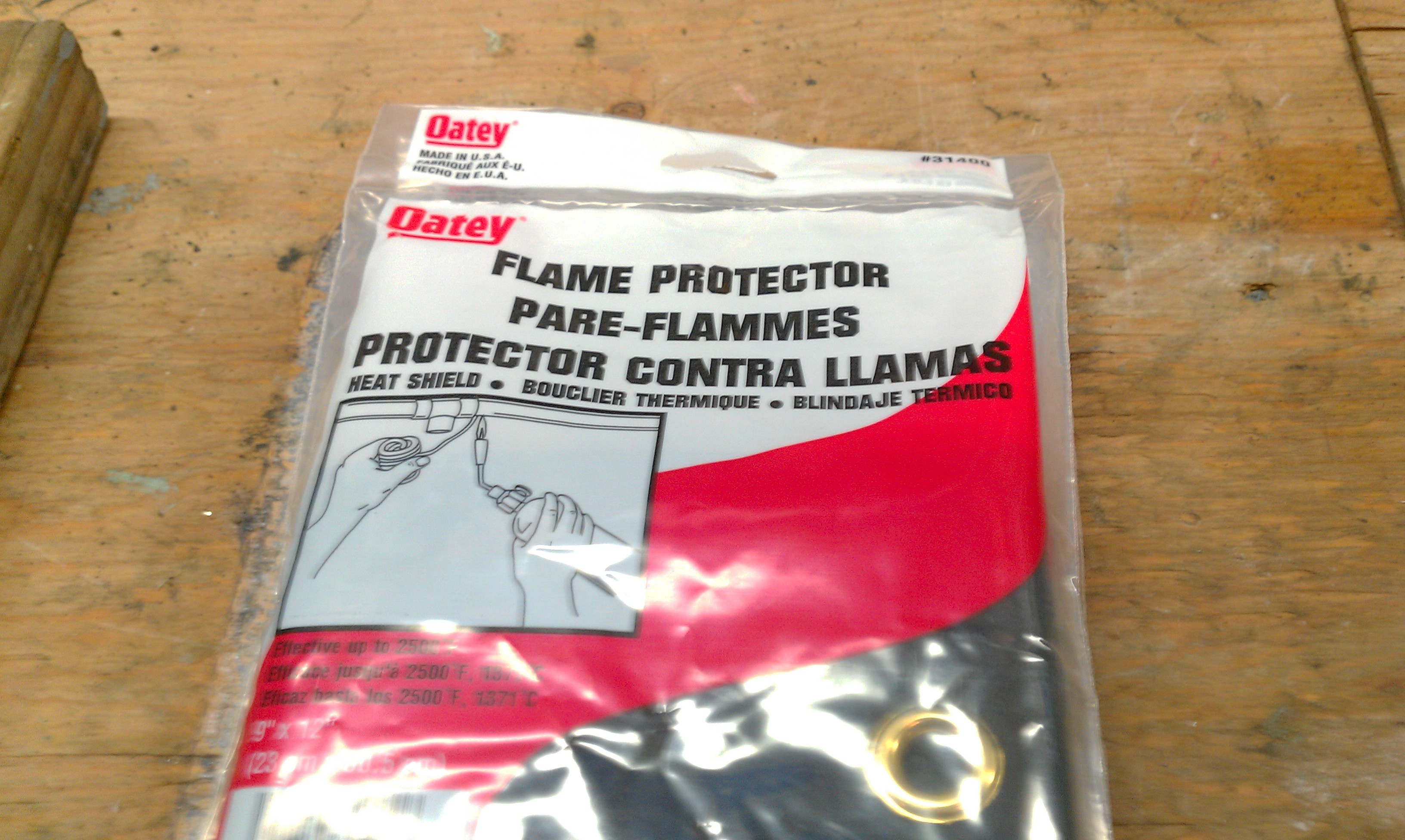

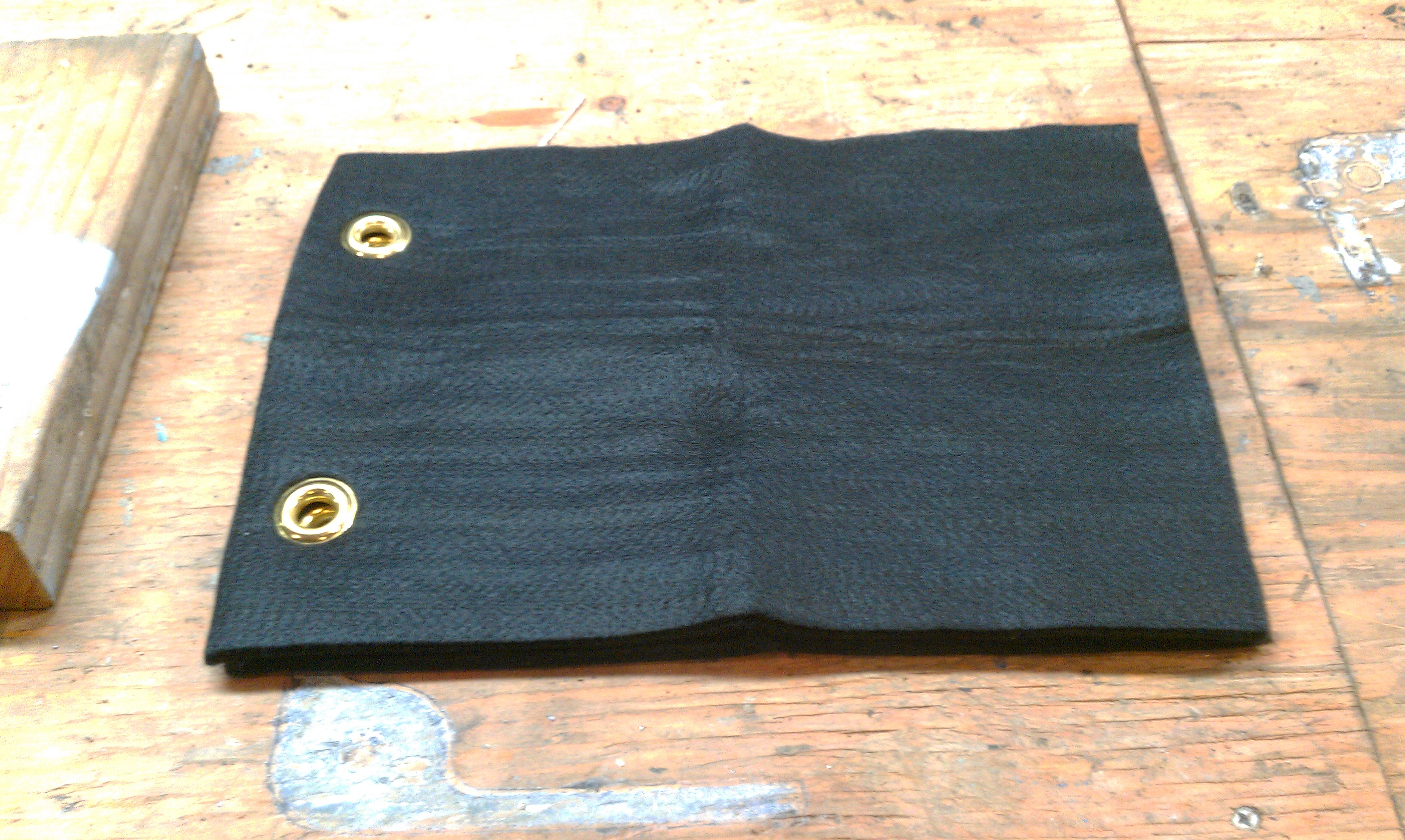

Just thought I would add a little note.
Here's a product I use when welding or soldering brass pipe.
Fire proof mat.
Bought this one at HD for $18 each. Kind of expensive. But better than a Car B Que.
Bought two.
Didn't want to catch the engine sound deadening mat on fire.

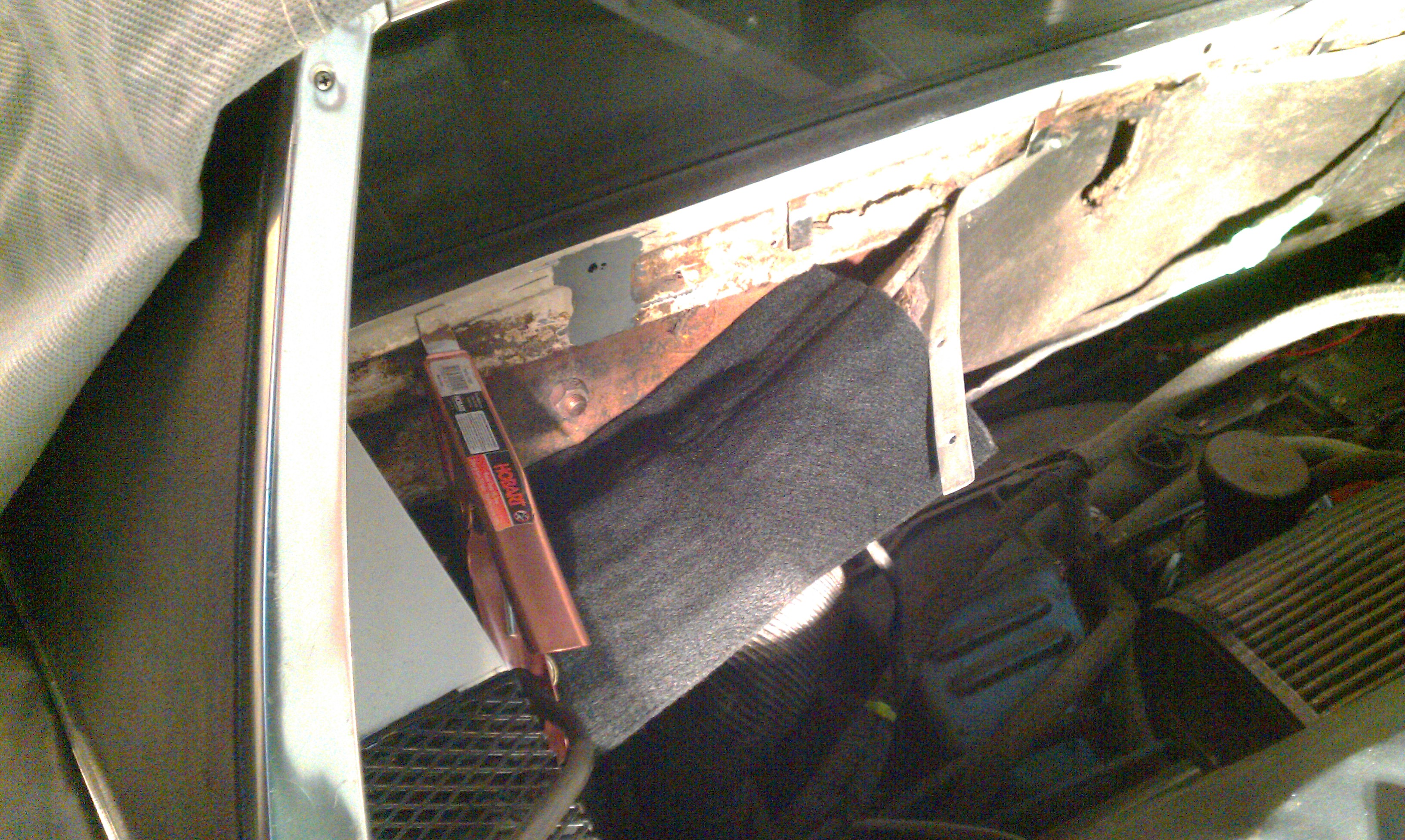

Getting ready to weld on the patch.
Prepped location with weld thru primer.
cary
post Nov 29 2012, 08:43 PM
Posts: 3,900
Joined: 26-January 04
From: Sherwood Oregon
Member No.: 1,608
Aligning the patch and holding it with my Big Ass HF magnet.
cary
post Nov 29 2012, 08:45 PM
Posts: 3,900
Member No.: 1,608
Tacked in, ready to check alignment.
cary
post Nov 29 2012, 08:56 PM
Posts: 3,900
Member No.: 1,608

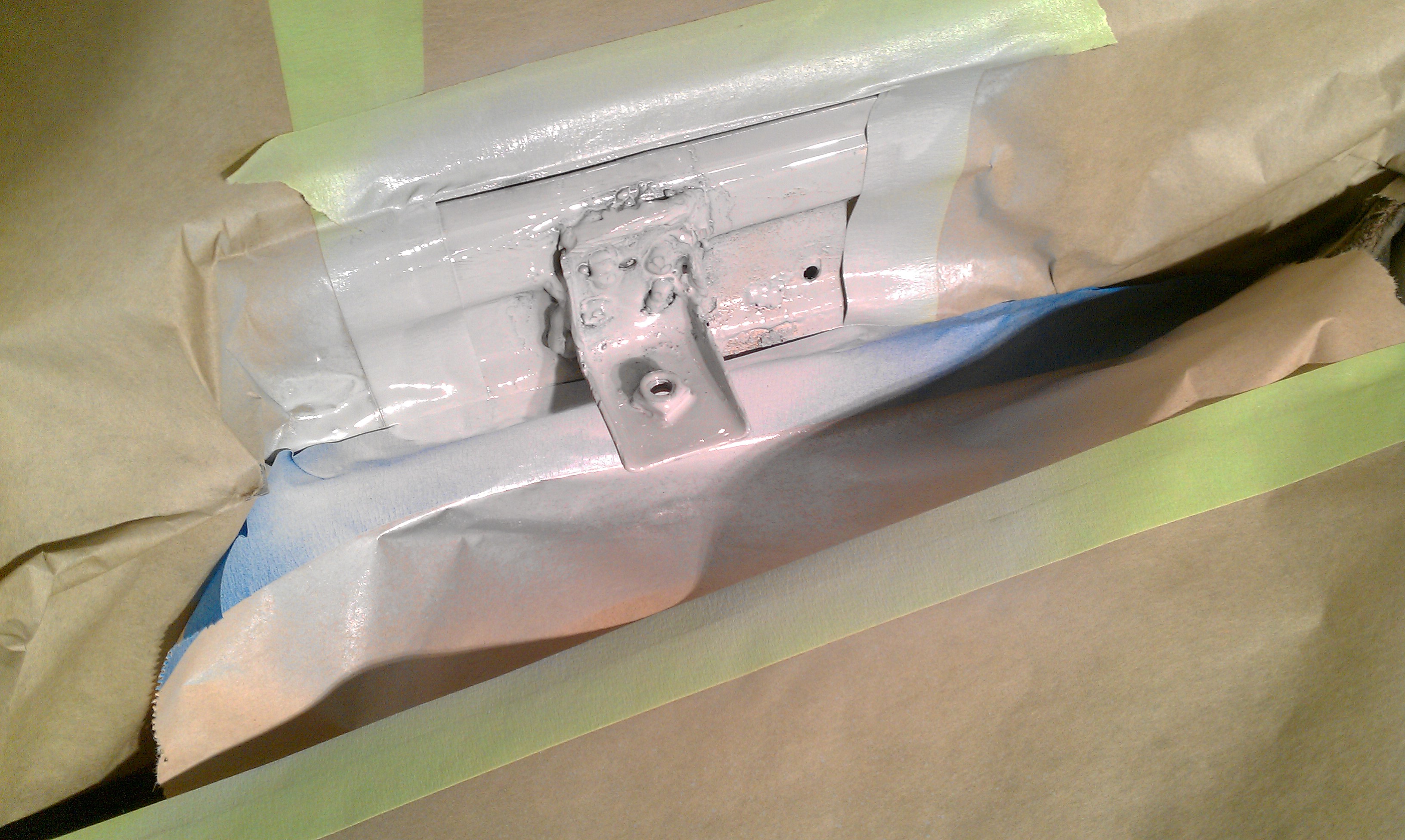

Here's it installed and covered with self etching primer.
Waiting for the primer to dry. Then I'll seam seal the top and sides.
I'm pretty certain lack of weld thru primer was the culprit.
Didn't grind the welds up tight. Might have issues with the other side in the future and may need to remove to get a CW alignment. Right now the lid is just a little lower than the two sides.
