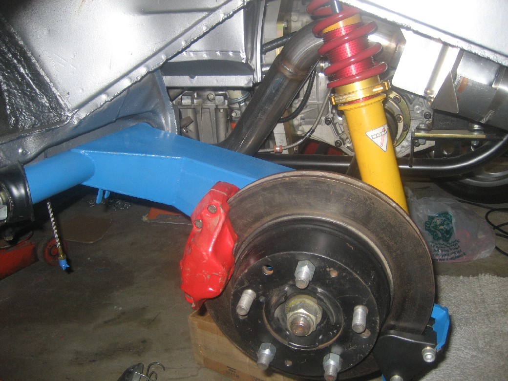

I think 200-lb. springs would be nice, paired with 21-mm torsion bars up front. That's my setup with the LS1 V-8, about the same weight as yours. I've get Koni yellows set on full soft, and the ride remains pretty civilized, and I've yet to bottom out the rear suspension even at a slightly lower-than-stock ride height.
--Doug
